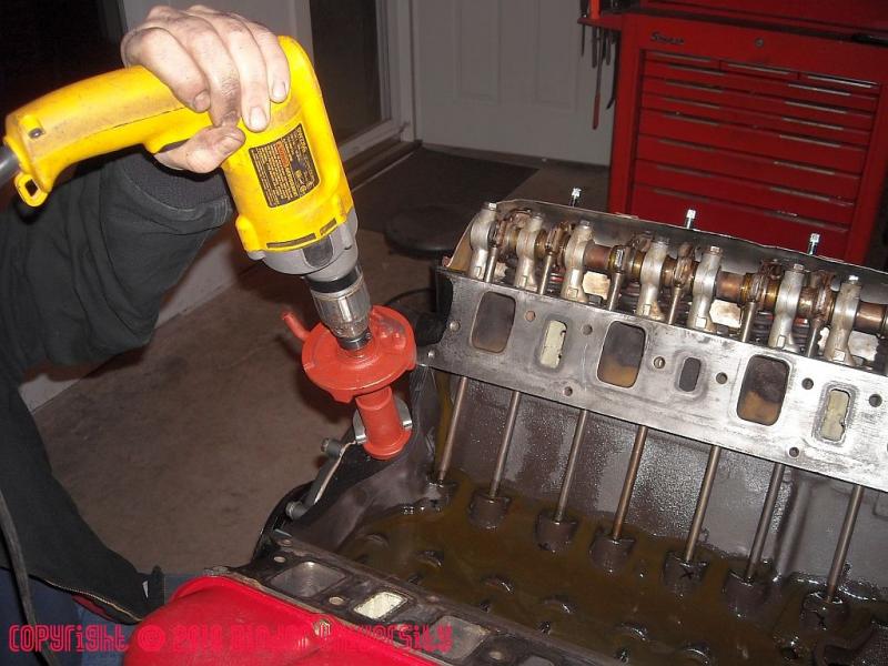

An engine sitting non-rotated that length of time needs to be pre-lubed, here's the process:
http://www.forums.IHPartsAmerica.co...I-4-sv-engine-non-oiling-rocker-assembly.html
