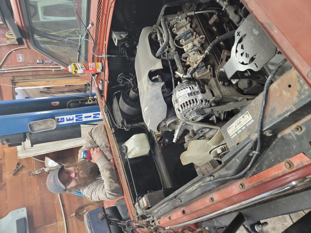

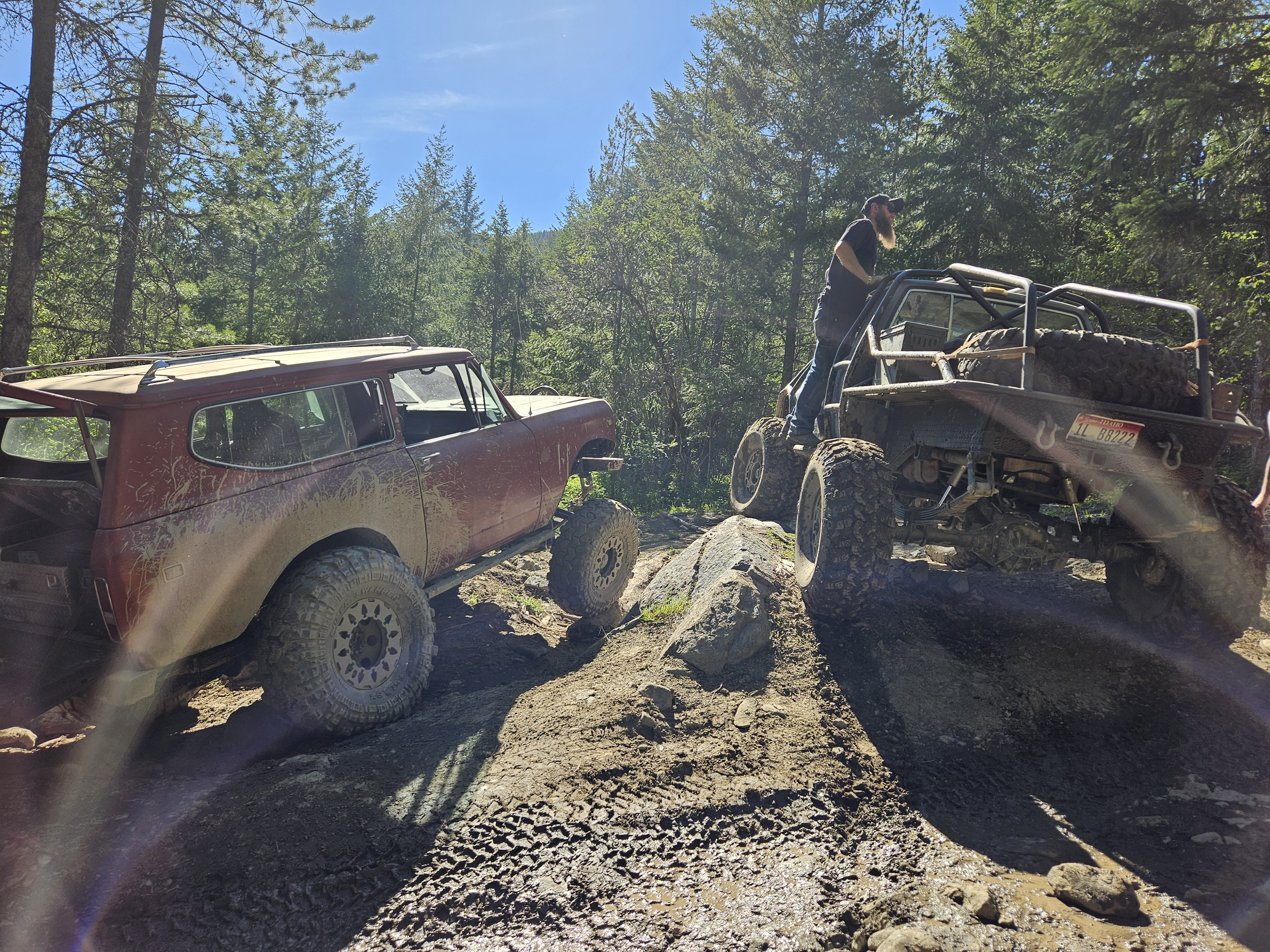

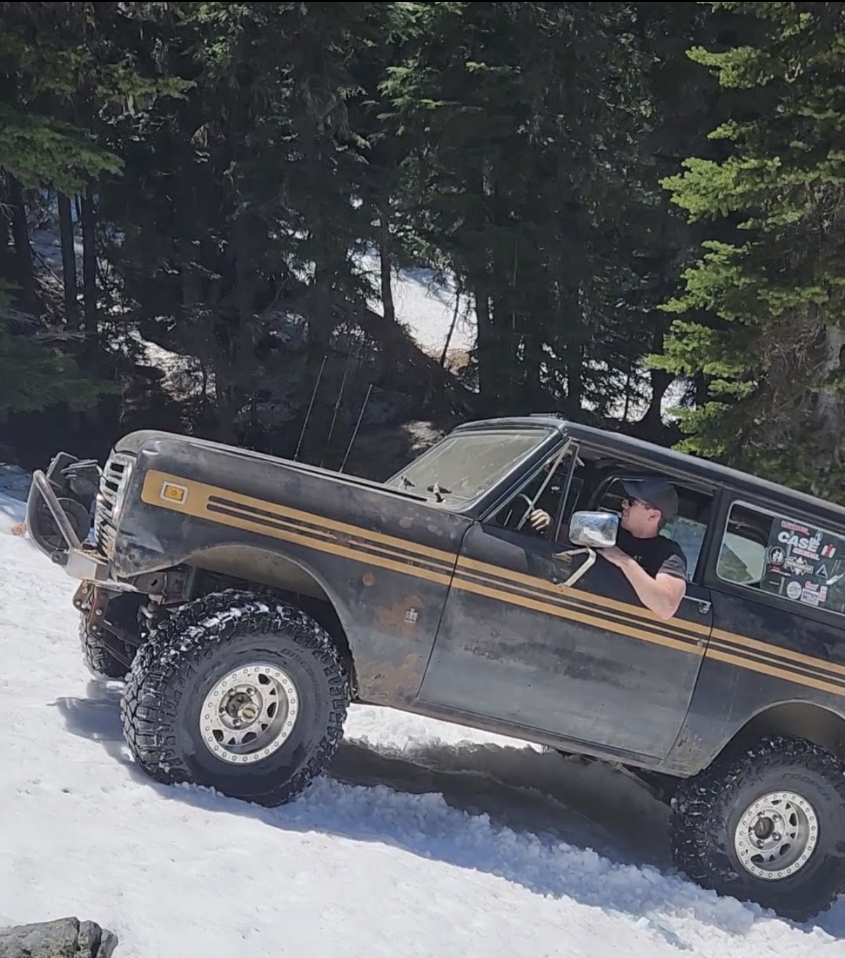

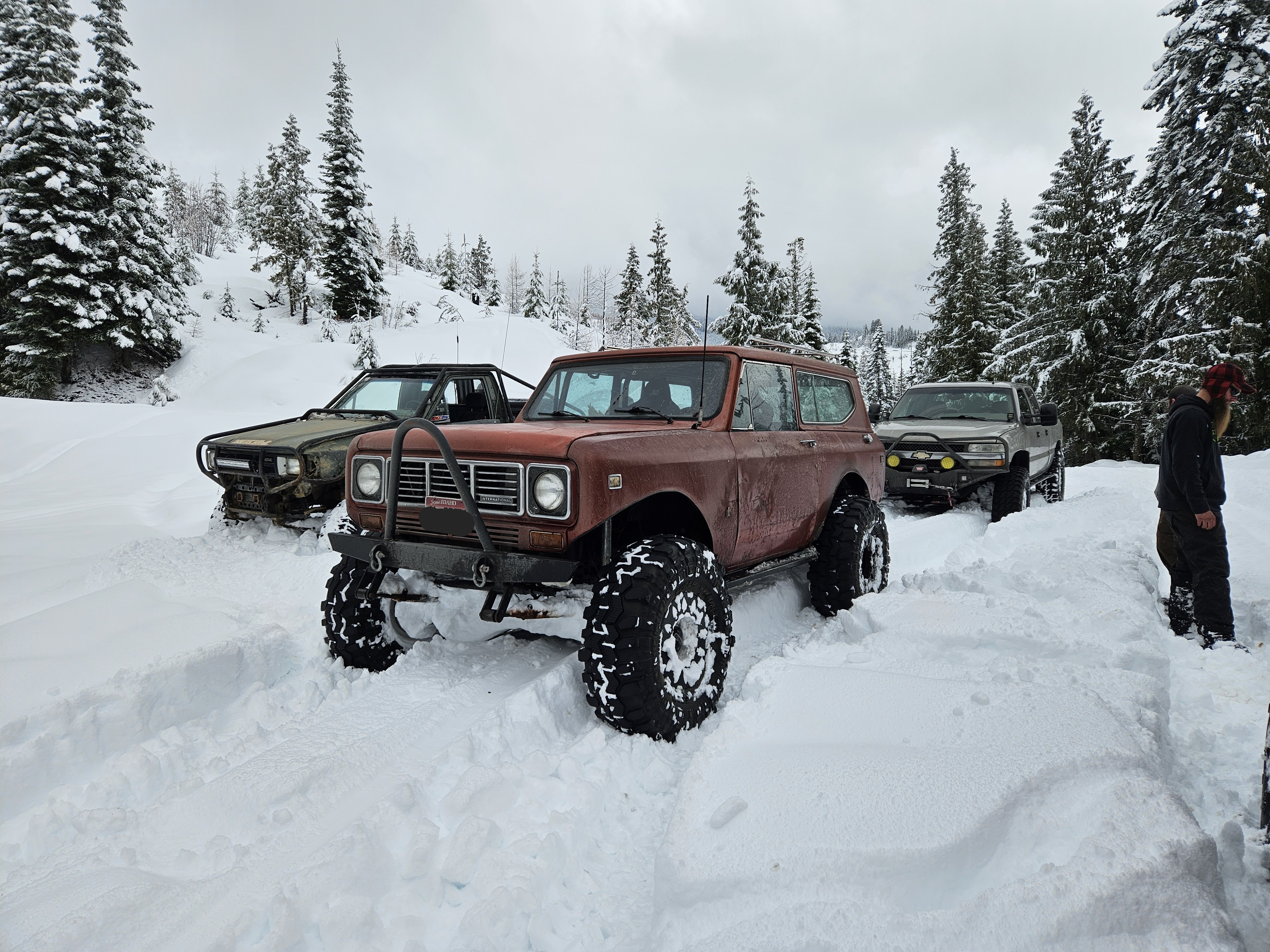

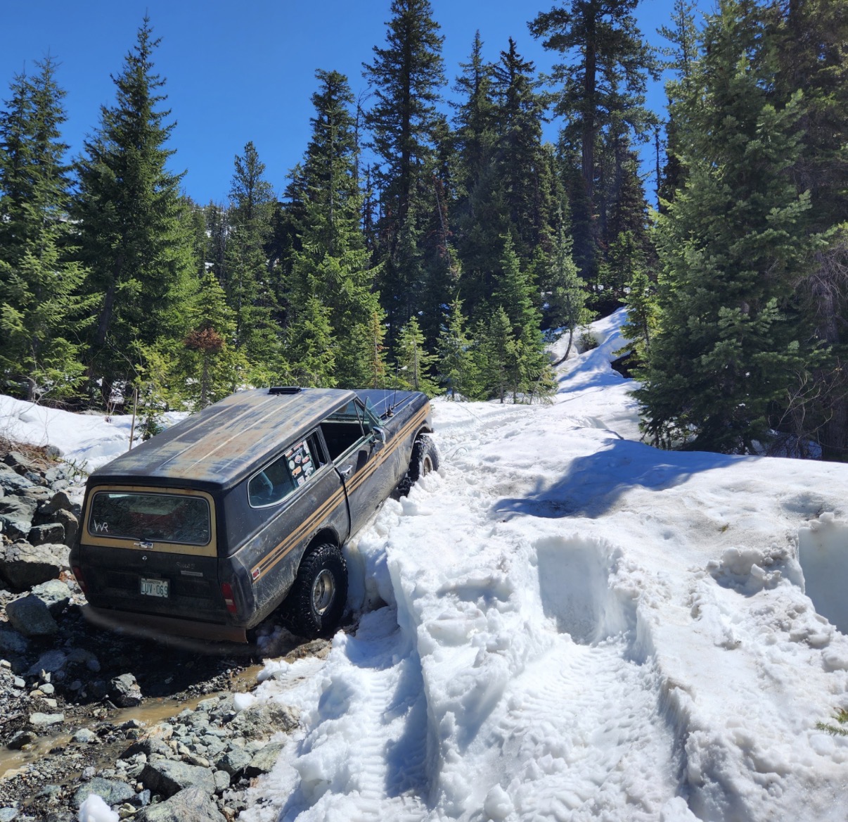

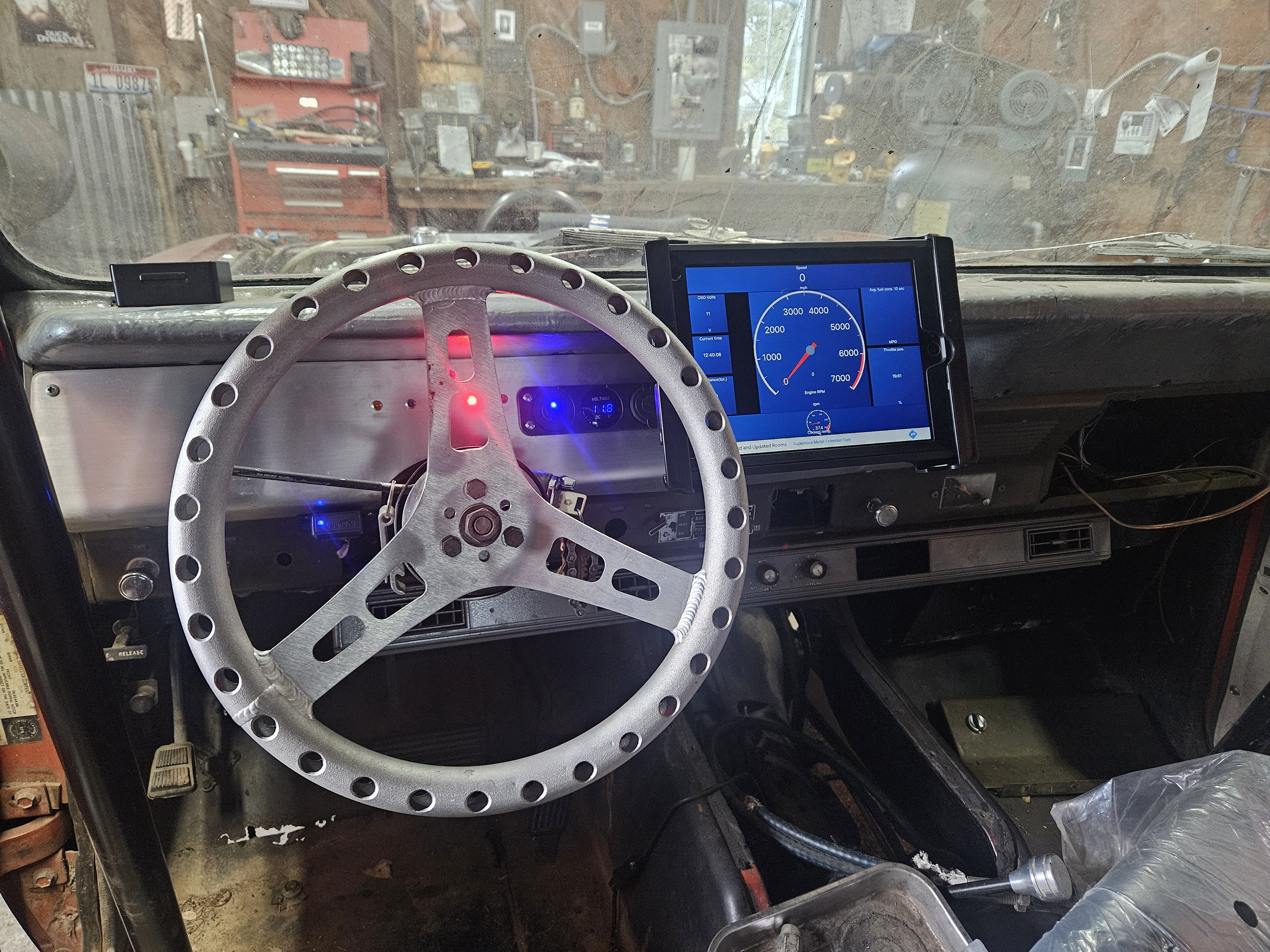

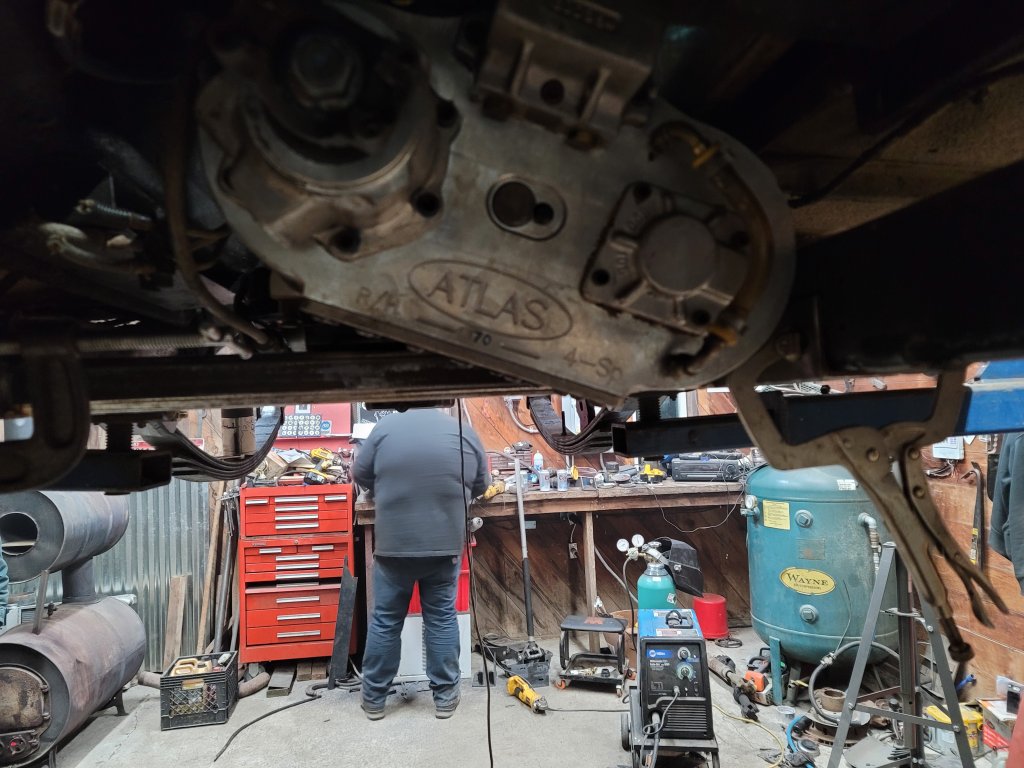

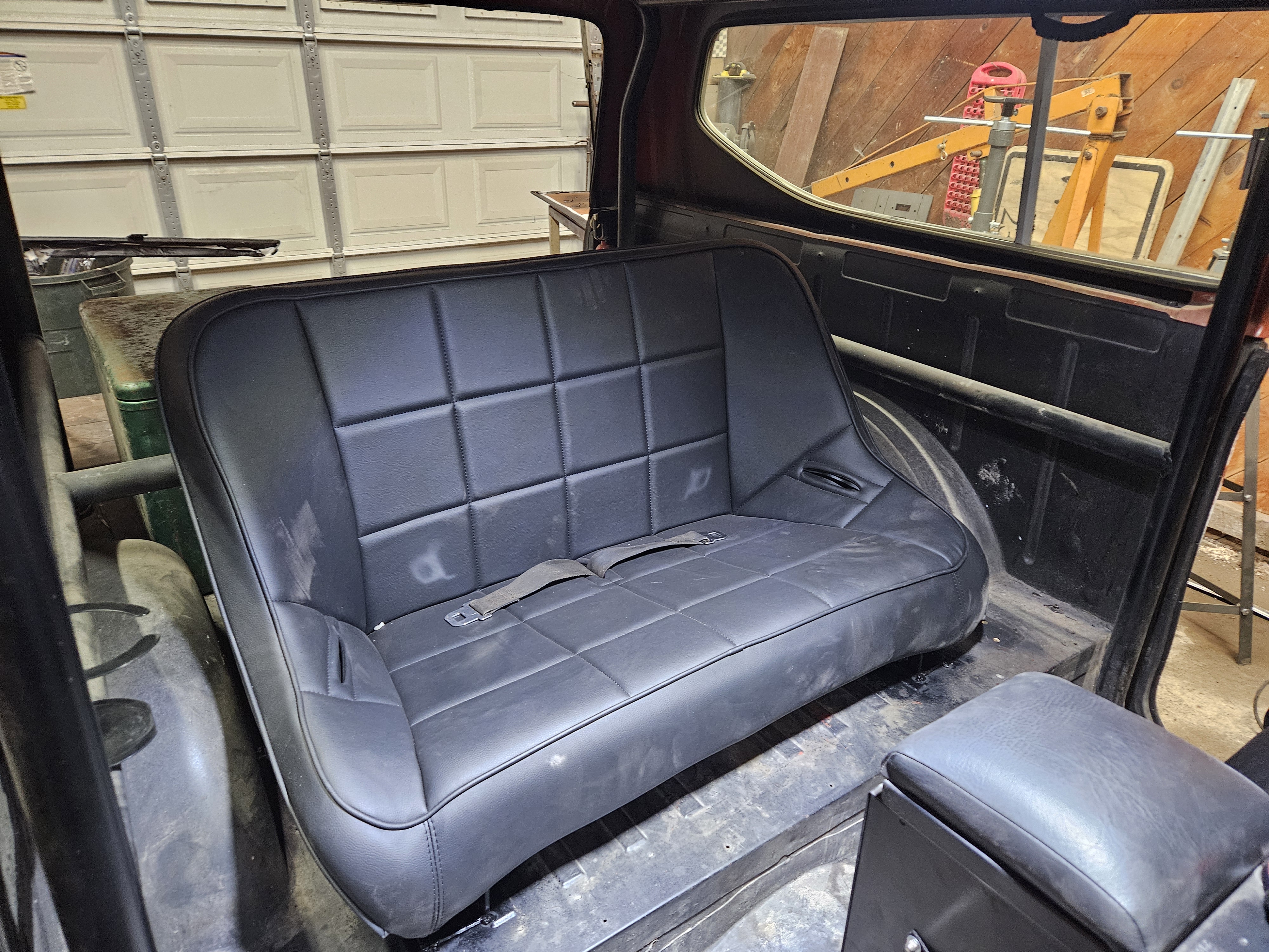

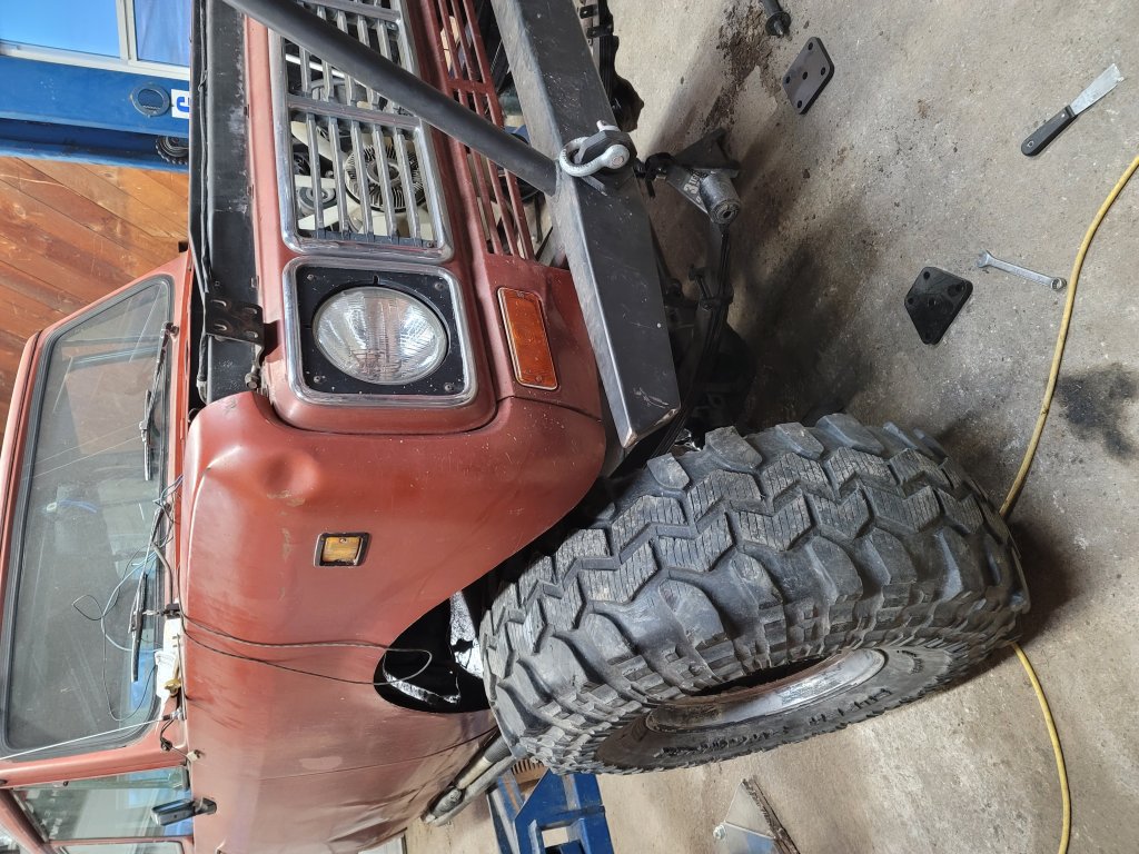

Currently doing a major overhaul on the scout.
Sold the dana 44s. Sold the 345...
Installing dana 60/14 bolt and 6.0L/4l80e/altas

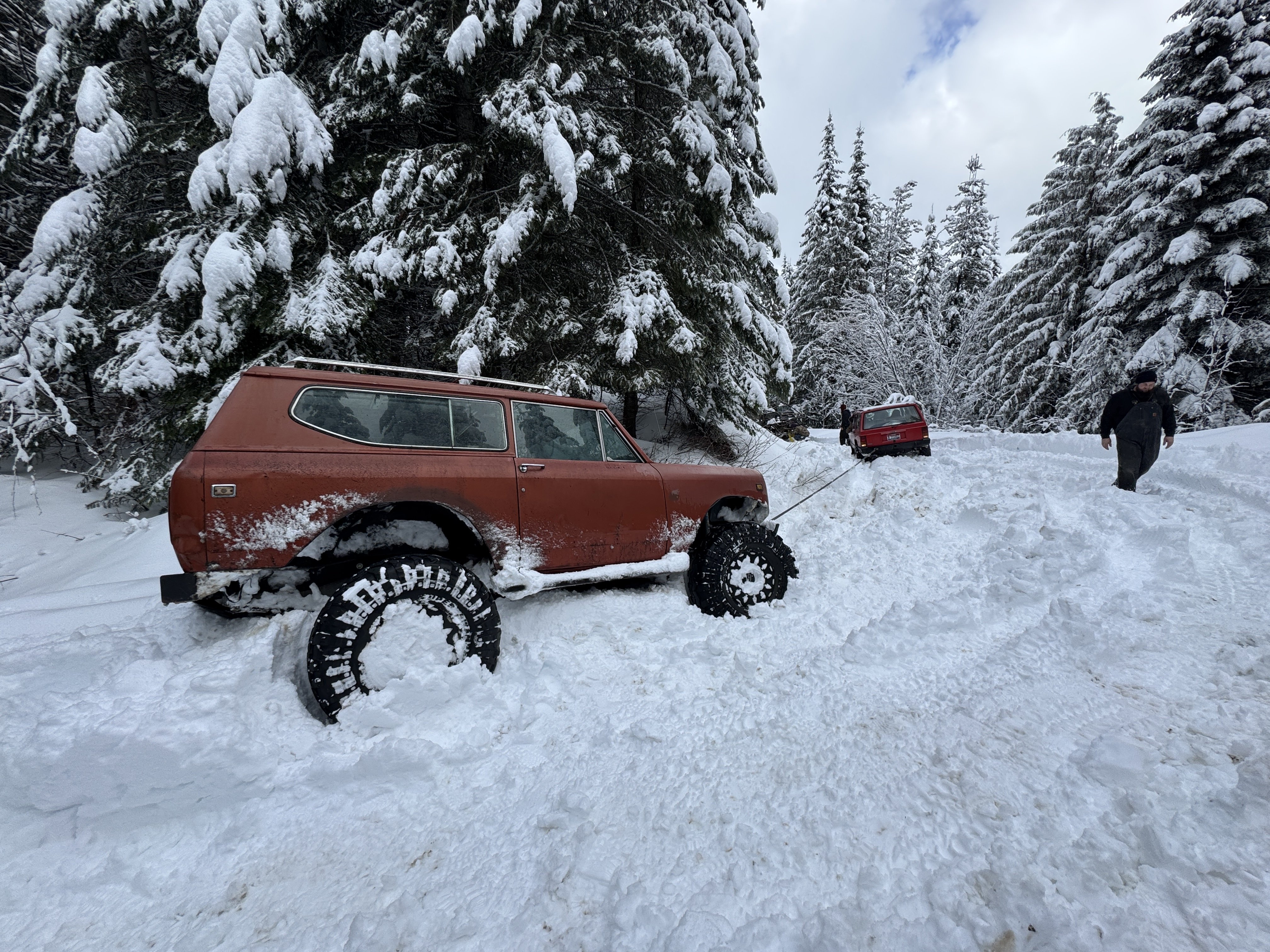

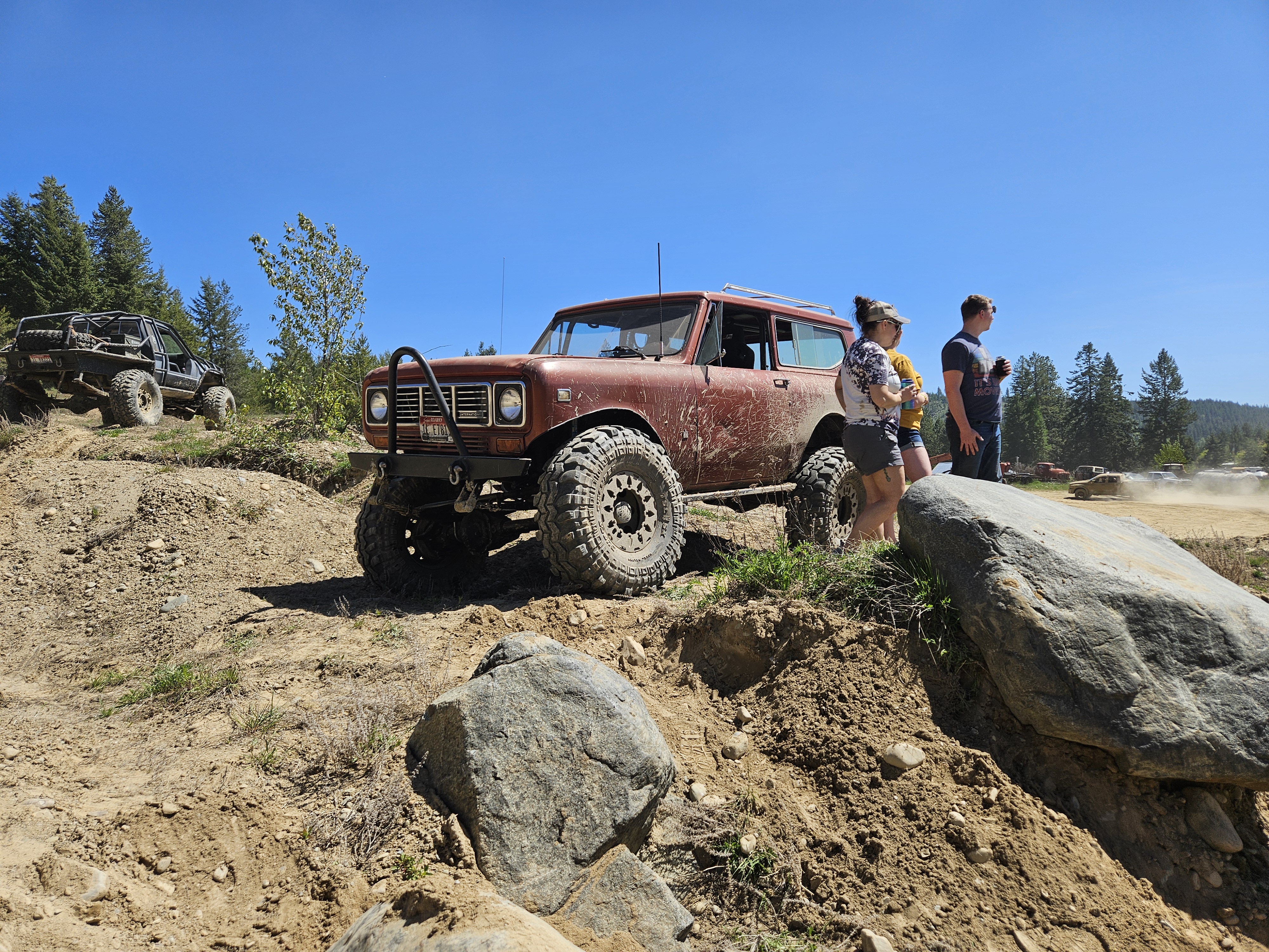

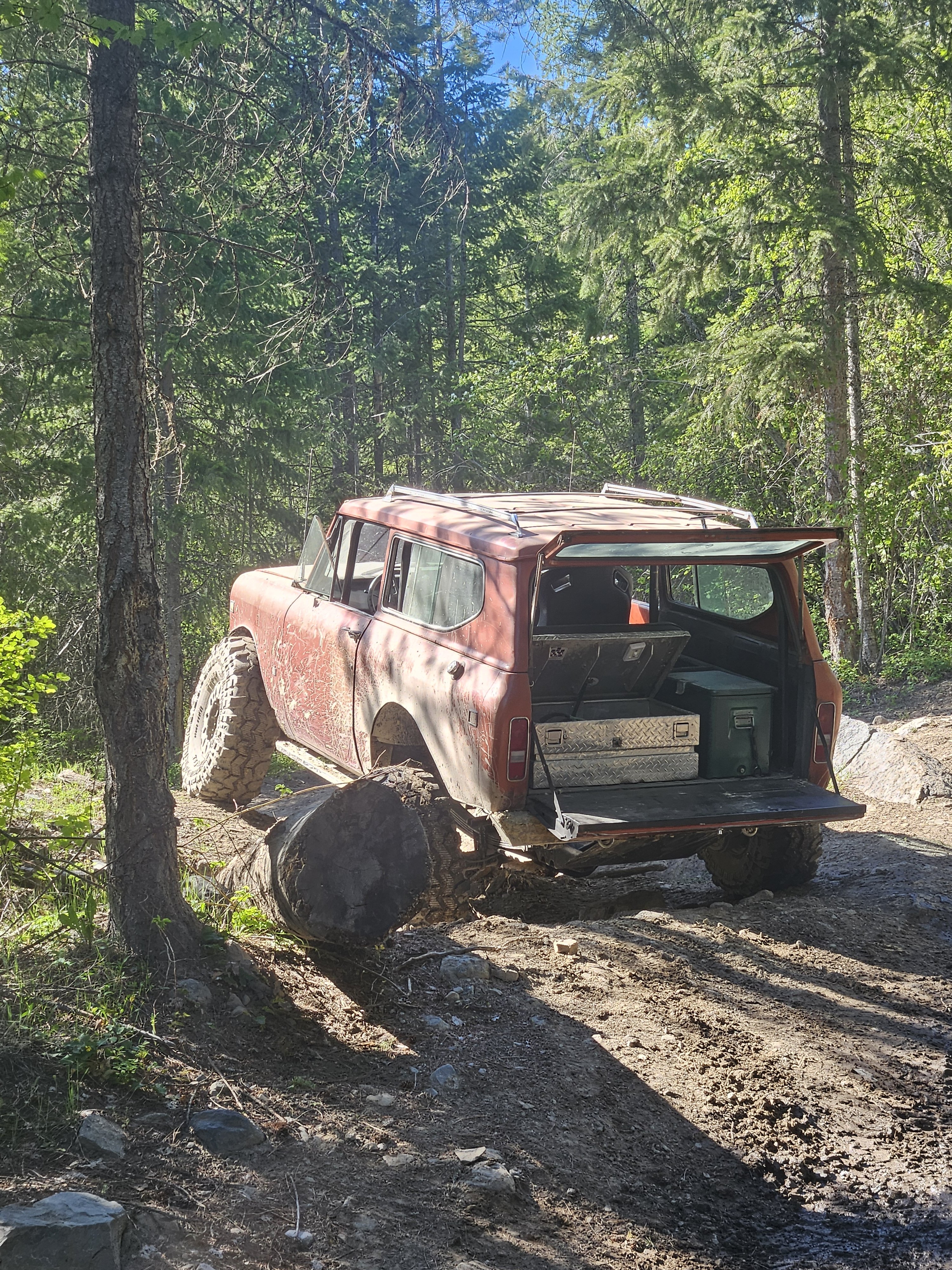

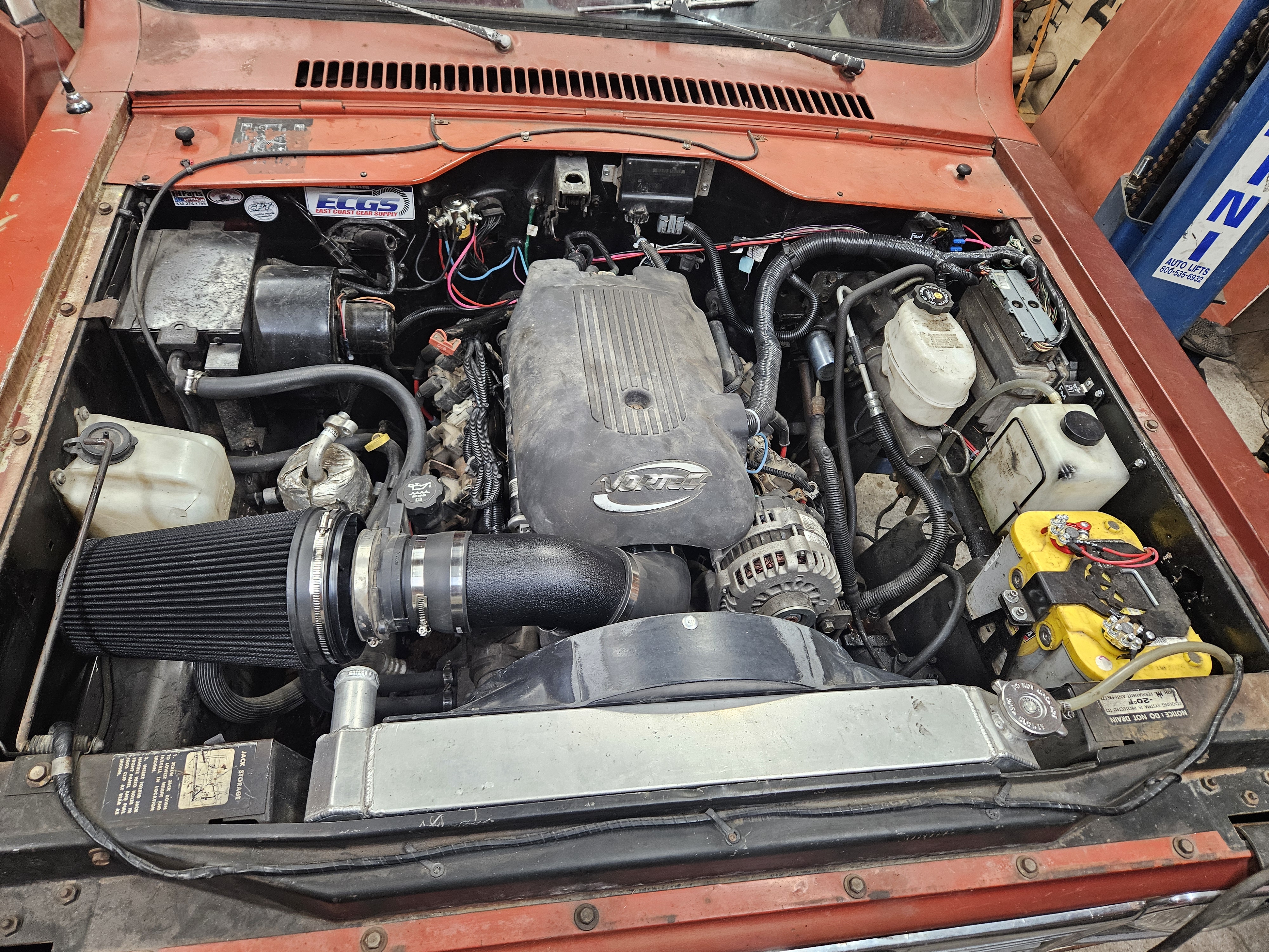

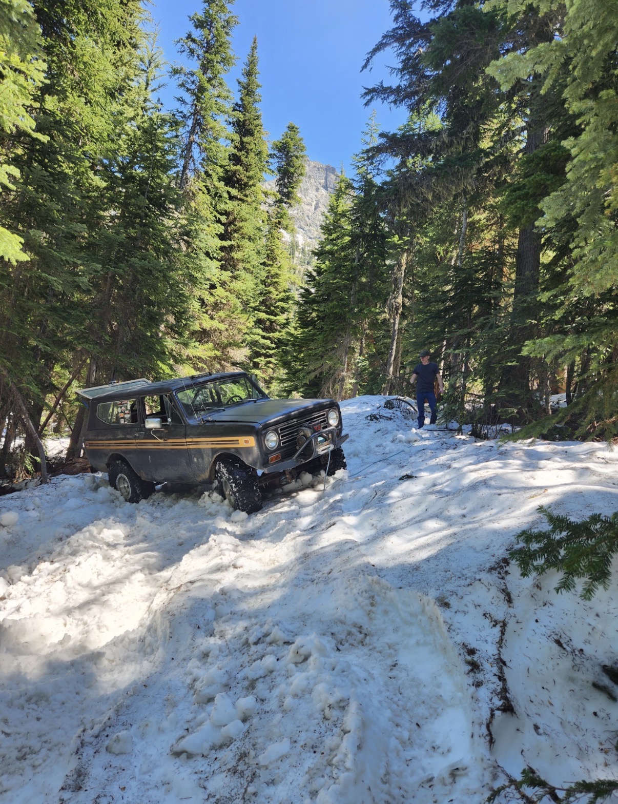

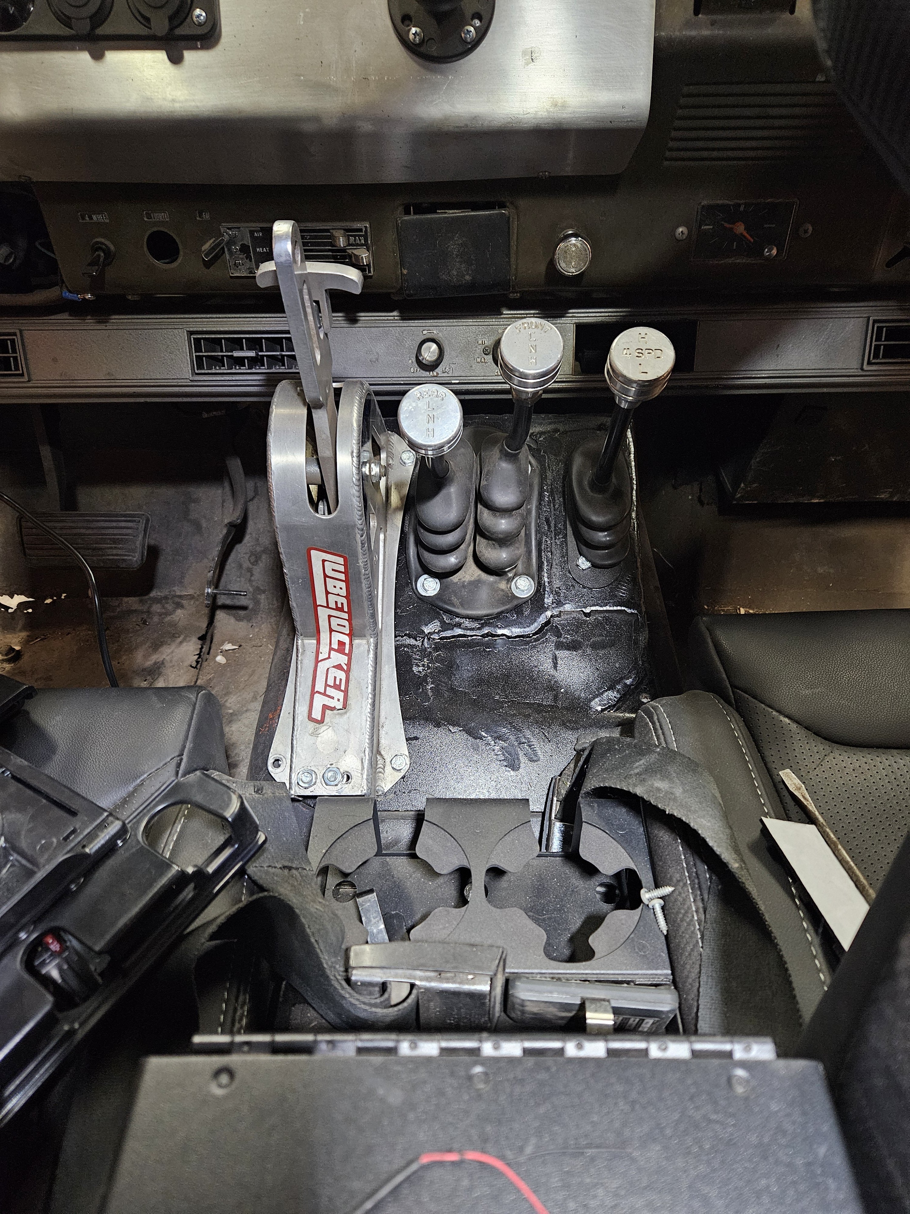

I thought I should update seeing how I am a little farther along.

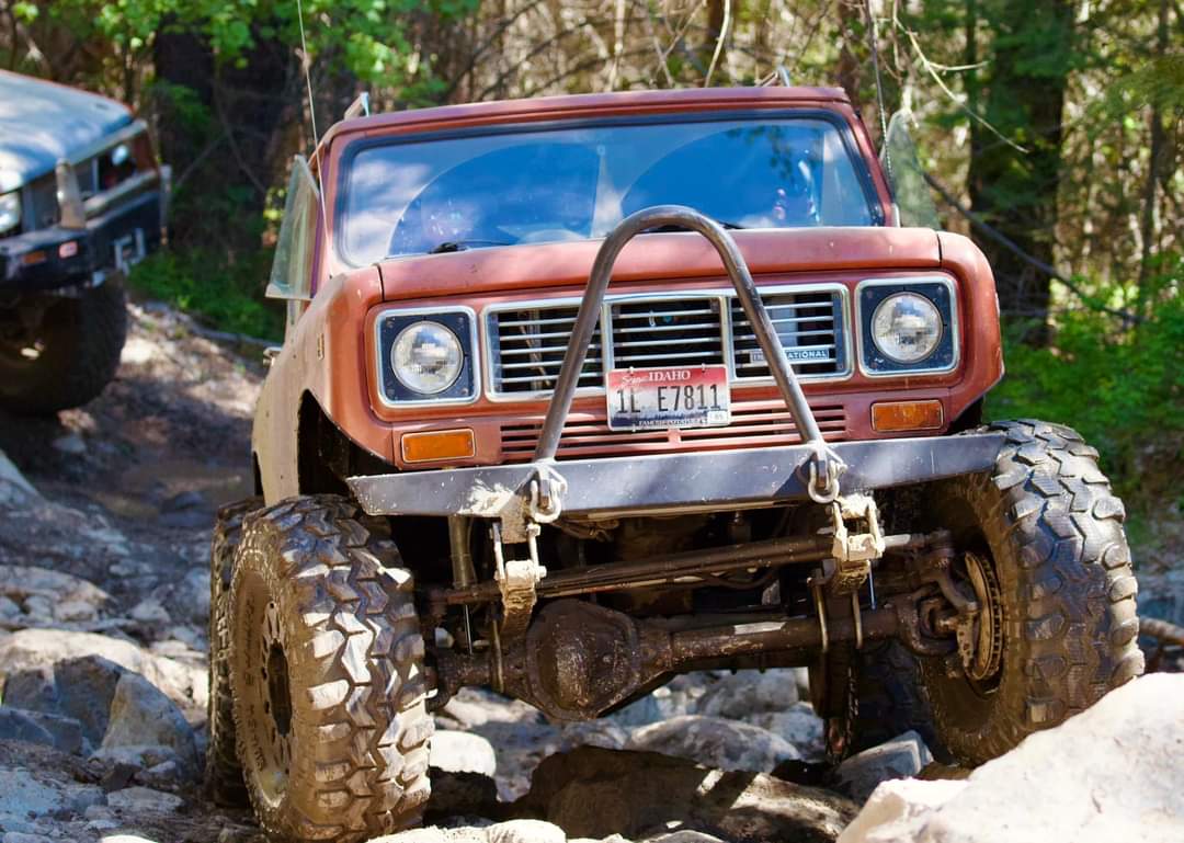

6.0l / 4l80e / atlas 4 speed / Dana 60 front (80 dodge) Eaton locker, chromoly 35 spline outers with drive flanges / 14 bolt rear, shaved, Detroit locker. Gears need to be updated next, but currently running 4.10s. Front leafs are chevy 52s, Rear leafs are Chevy 63s. military double bead lock wheels (16.5) With some worn in 38.5x14.5 TSL SX's. Would like to update the tires, I love the wheels.
Few photos, more to come! Just need more guys to wheel with in North Idaho (northcentral) Near Lewiston.
