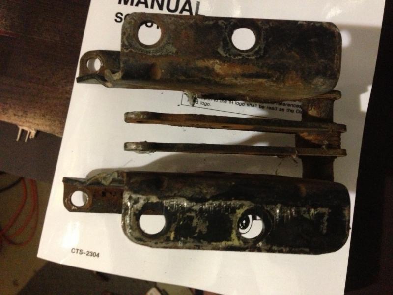

Does the arm on the assembly below need to move freely? I'm thinking yes. Just haven't seen this before and wanted to get a second opinion.
I say yes! This appears to be the bracked that mounts the vaccuum booster to the firewall? The arm is a pivot point/actuator for the master cylinder. The easier this operates, the smoother pedal action you have. Looks like it could stand a good cleaning and re-paint?????
Codeman,
you're correct it is the booster/firewall bracket. I agree it makes sense that this needs to have some movement.
Originally, I thought the booster was bad because I couldn't figure out why the brake pedal would not return. I'm not going to fret on the $300 I spent on a new master cylinder and booster because those are important safety items and most likely would need replacing anyway............right??:icon_question:
