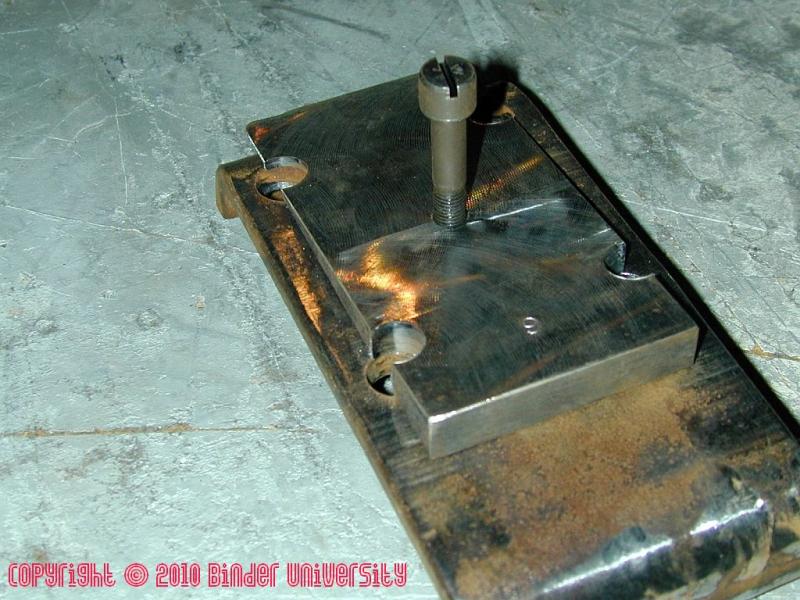

I have 31" tires on our Scout 80 with a d27/d44 combo using 5" CPT shackles front and rear. They are on oldskool "deep reverse" wheels that get the inside of the front tires away from the springs in a turn. The axle is the oem d27 with the option 10" brakes which work really well. Works just fine for use as a tractor here on the place and will survive just fine on the street and fire roads we run, we don't use it for hard-core rock houndin'.
Many of these rigs were set up as toads behind motorhomes back in the day! Most were equipped with remco driveline disconnects for the rear driveline.
In addition to the lift shackles, I've installed CPT 6* caster wedges on the front axle, what a great difference that makes in tracking and in allowing the steering to self-center. When used in flat tow, it really improves turning and I can back the rig just like a trailer!
I used 2.5" wedges and modded by drilling and mounting with long spring center pins, they will never have a tendency to spit out!
