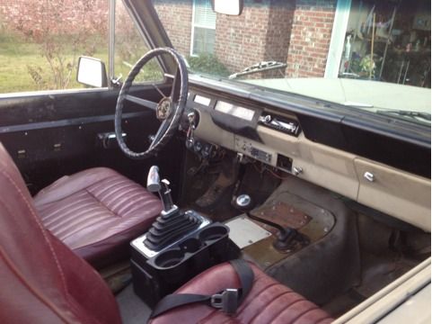

Oh, I did notice from the pics on the post, the automatic shifter has been relocated and moved back. The 4wd shifter is still in the stock location though.
Here's a pic of what I'm talking about with the shifters. Not sure if this helps much or not. I did some more digging based on the info you gave me so I know what to look for now. The extra dog ears or not on the adapter plate. Now for the pros and cons!
