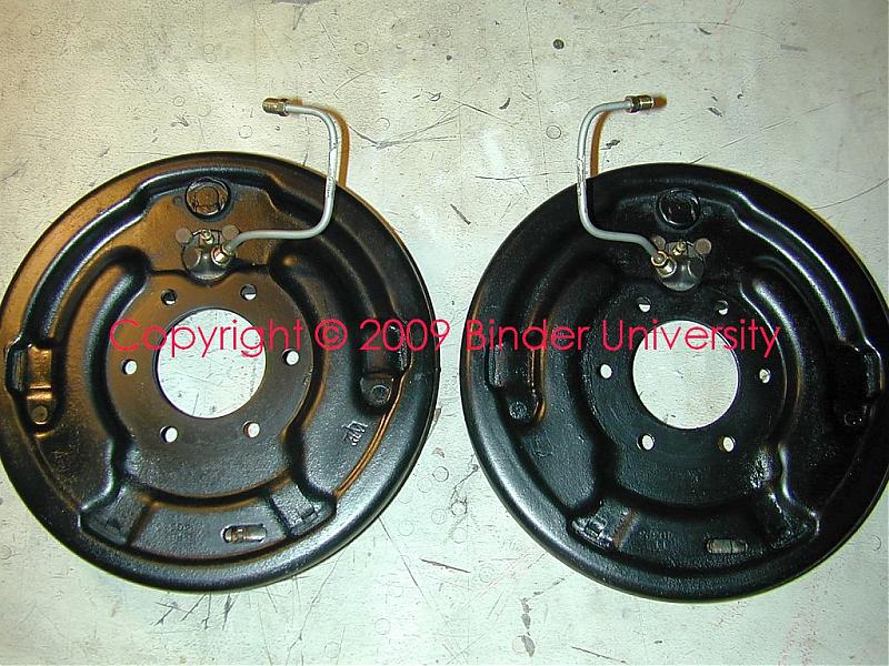

This pic is a lockheed 10" front for the s80/d27 axle set (the "option" brakes).

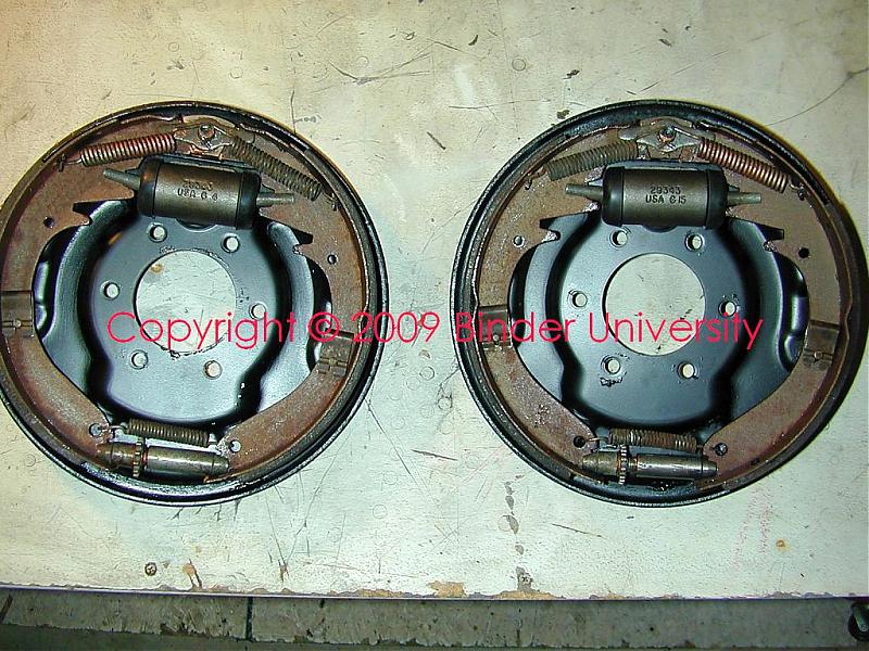

This is a bendix 11" set for the s80 rear, used on the "option" tapered hub d44 axle.
This is a shot of the lockheed fronts from the backside.
I can't find the pics I have of the bendix rear stuff, but they look just like any other bendix backing plate, distinctly different as compared to a lockheed plate.

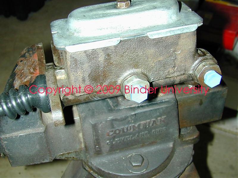

This pic shows a "stepbore" dual circuit mc for a Scout 800, very difficult item to source new, but at one point both iho and ihon had 'em. This a rebuild I did some time back using some kits I found stashed away at an oldtime parts warehouse. This would be a direct bolt-on for your s80 if ya made the appropriate plumbing pigtails to go either over or through that inner fender panel/support.
This is meant to just be representative of a type of oem mc workaround.

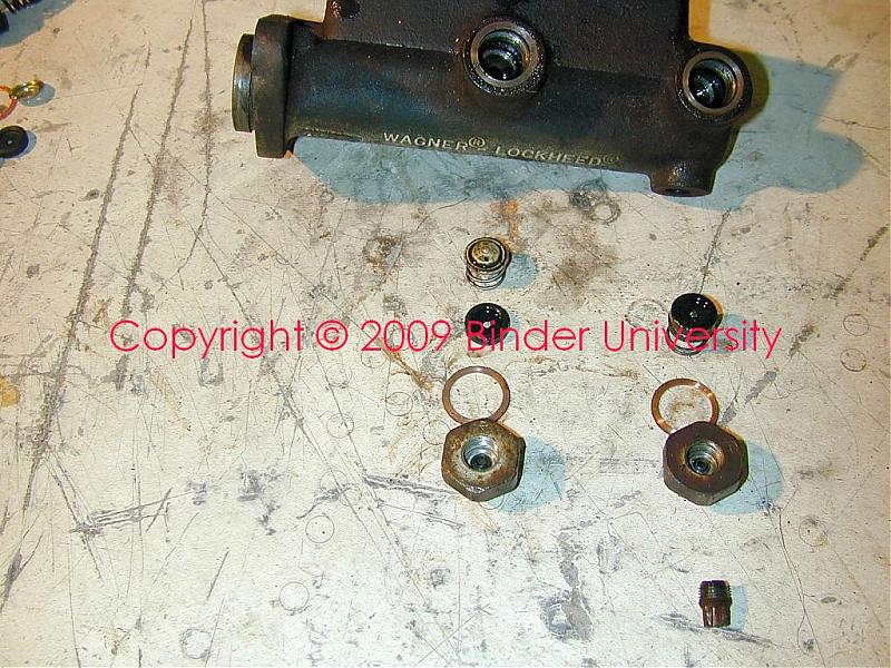

This is a pic of the same s800 rebuilt mc which shows the oem residual pressure valve system in each circuit, located behind the transition fitting for each circuit.
The "passenger side exit" of the ports on that s800 mc are kinda unusual, the typical dual circuit mc will have the ports on the driver side of the casting like your Scout II.
The oem Scout 80 mc is very similar in appearance to what was used on single channel Ford apps in the 50's/60's (car and truck), but when I actually compared a new Ford app to the s80, I determined it would be more trouble than it was worth to adapt it.
If...you actually have the s800 stepbore master from the donor for your axles, I have one rebuild kit left on hand...I'd be more than happy to determine if your mc is usable and if so, then rebuild it for ya, just bring it to the club meeting in salem on jan 7! Because they are a step-bore design, the rebuilding process is a bit trickee!!
oops!! I lied lonnie! I do not have a new s800 mc kit on hand afterall, but I can get more so the offer stands!!
