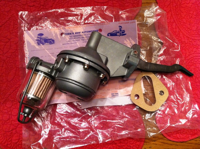

Here's the mechanical fuel pump rebuilt by then and now automotive...awesome work and nice price as well. Thanks!

how much they charge ?
They charged $97.50 with shipping...

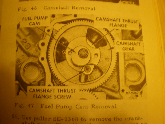

I take it this is a v8 ? How long has it been or has it ever ran with a manual fuel pump like what you had rebuilt? Hook up a gas line to the fuel pump an put it in a jug of gas,hang it from the hood . Then try starting it while trickeling some gas in the carb,if it don't fill up the glass bowl,then you got a problem with f.pump,or the ecentric on the cam gear is not there,or is loose ? Or ? Jeff

Jeff,
the pump has been out of the truck for only a week and a half. The engine was running very well before the diaphragm leaked. I am charging the battery a bit, adding fuel to the tank for good measure, filling the glass bowl and giving it another go this morning...I think it was just sucking too much air. The fuel was out of the intake line from the tank as well as the pump being dry makes me think it just needs some fluid in it to pump properly...but again, what do I know...lol. I am having fun though...:yesnod:
Jeff,
