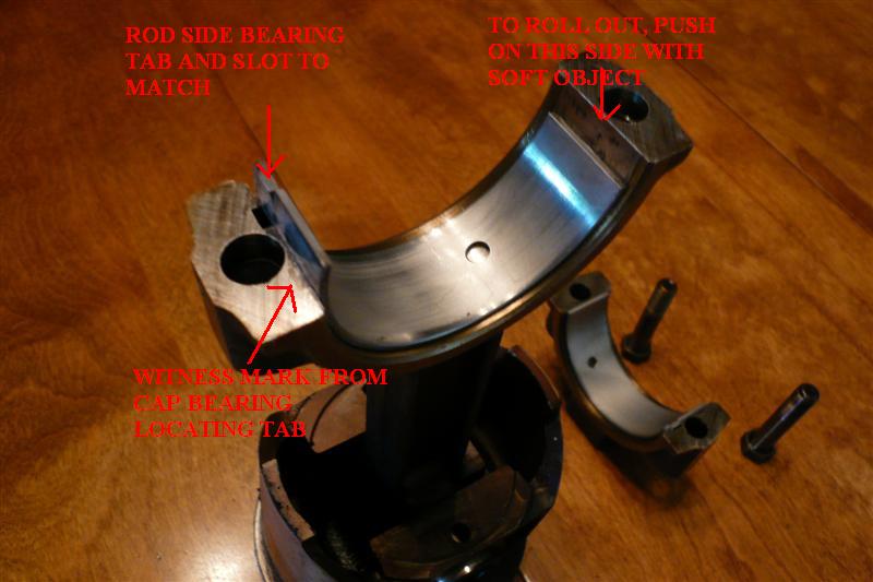

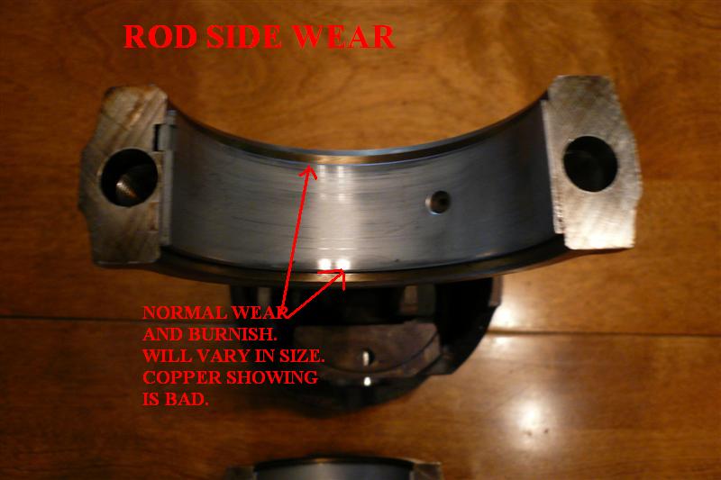

The cap won't go on backwards. The trick is cleanliness. Keep your hands clean like you were going to pick up your sandwitch to eat. The rod I photographed and bearings came out of my Scout after I rolled in new bearings and drove the crap out of it . The wear shown if probably 5000 miles on California freeways turning 3800 rpm due to my low rear end gears. I have since installed an overdrive and 32" tires so fw speeds are way easier.

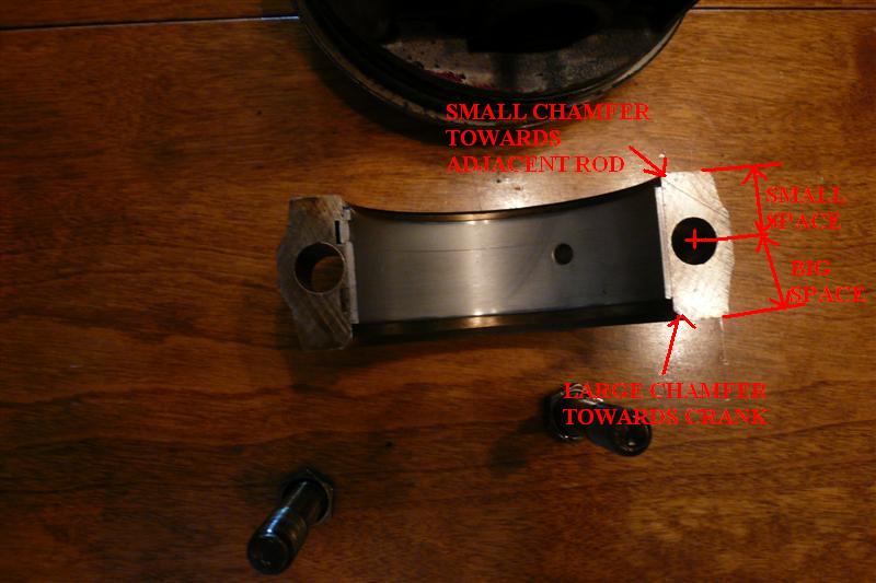

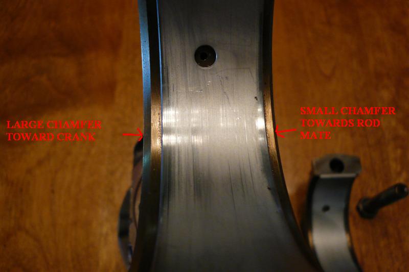

I took a few pics of a 152 rod (others similar) and added some text to make your job easier. Always helps to know ahead of time what you will see. Any questions ask away.
Once the cap is off you should be able to push on the rod with the butt of a hammer or a wood dowel and slip it up the bore a tad (no more that the thickness of a hack saw blade .030). Makes rolling the bearing back in easier.
Use your finger nail to feel for any deep scratches in the crank journal. No noticeable variations in diameter/step should be noticeable. Amazing what a finger tip can pick up when run across a smooth surface.

They look great really. If it were mine I'd put her back together and like you said drive it.
The oil on the threads is fine and probably perfered as the torques in the manual are developed for engine oil lubricated threads. Clean the clamping faces of the rod and cap, the backs
of the bearing shells so they are as free of oil as pissible. The bearing wear faces should have oil on them though.
If the rod bearings look that good I would say you are goot to go.:thumbsup:
