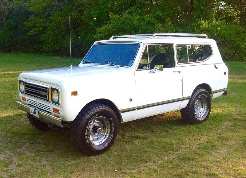

I think I just found it on the upper bypass hose, and no sadly I dont take advantage of my babies capabilities because it is too cherry to let the salt eat it
It's 36,000 original miles, nothing has ever really been changed out aside from the alternator which died randomly a few years back. Thank you for the help!!

Gorgeous Scout! The fan clutch sounds normal. It only locks up when the radiator is hot. I bet there are no other scouts in that condition in your area. Mine is a daily driver and ranch truck, but I try my best to keep in tip top shape.
Thanks, it's my baby!
