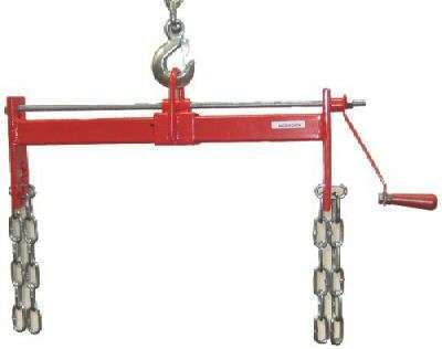

I forgot to mention that you can buy a load balancer. Really slick if you need to angle things like to sneek in an engine/trans assebled.
There are a lot of different makers and qualities availible... Find one that suits your needs.
Looks like the photo attached...
If you drop an engine in by yourself like I did this would be your best friend.
