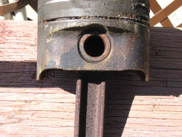

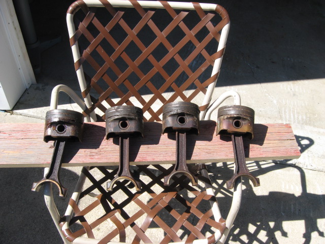

I have read many of your post and I have enjoyed all of them, but it seems like there is allways more questions than answers. So my latest question has to do with the use of kroil for freeing rusted pistons. I have a donner 392 out of a loadstar that I was/am going to put in another loadstar, however I made the mistake of exposing the engine to a north idaho winter with out cover. I then let the engine sit for a year before starting to tear it down. Was I surprized and disappointed. Currently, I have 4 of the pistons out and 2 that have been soaking in marvel mystery oil for at least a week. I have read the hype and success of kroil and just wanted to know what your experience ,if any, has been. I am determined to bring this engine back to life one way or another.
The engine appears to be in almost stock condition. The 4 cyl. That I have removed pistons from have mic out at 4.125 after honing and rust removal. The rod journels that are exposed mic out at 2.373. And there was/is no ring ridge on any of the cyls.
Any comment or suggestion would certainly be appreciated
