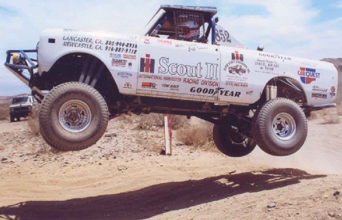

most of us don't fly scouts. That would convert to 5 to 2 in. Hg. Vac?
Ohh come on!!! I've seen scouts fly..:icon_eek:
sure if 29.92" is full throttle then 2-5" vac would work.:dita:
but what about driving at altitude? Subtract 1" vac per 1000feet.
