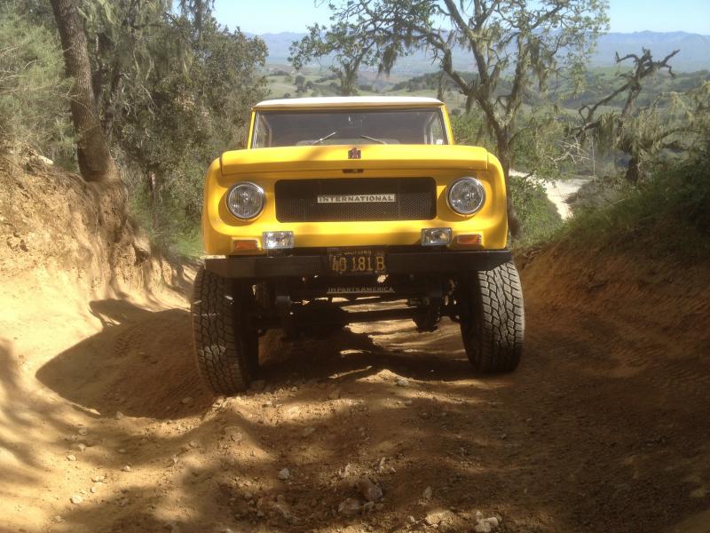

Jim's 1968 Scout 800
As a note this Scout has hit 3500 miles, pulled the airstream without an issue and is surprisingly capable off road. Great work guys.

Quick update. The is almost to 8000 miles and serves me well. Every time I see her I smile. The Scout has performed well in city driving, highway driving and towing. It has also proved it is a Scout in the snow and off read. Thanks ihparts america for making me this treasure. She thanks you for all of the heads she turns.
Jim
