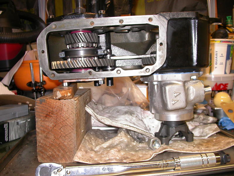

I can verify the short shaft Dana 300 kit advances sells does fit a Scout Dana 300. Installed mine a month or two ago. Love it.
You will also need to shorten your rear driveshaft about 1 2/2 inches if you go with the aa d300 rear output assembly, it's more than a tad bigger.

+1 on what hondo said. I think mine came out to needing to be shortenedshortened like 1 5/8"s but oh so beefy
