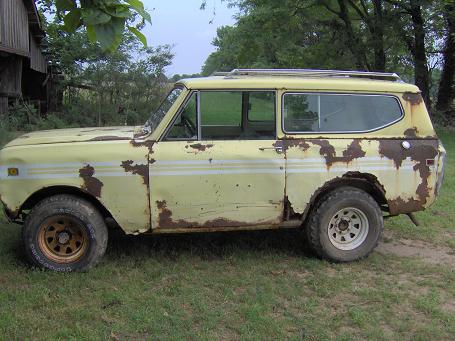

Title and whatnot. A 1977 IH Scout II (or so I thought!), 304 with 3spd auto.

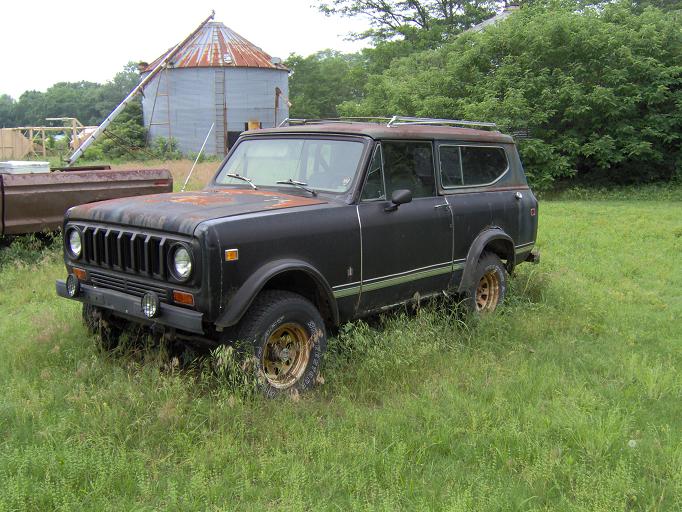

Here are pictures of it as it sat in my yard for several years. Lots of mowing around this one.

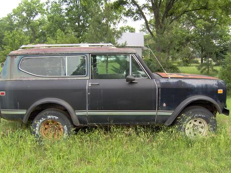

The top is obviously not factory, unless this is some expensive blue on black rock'n roll custom paintcanjob.

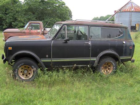

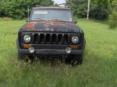

And I couldn't find pictures of another '77 sii with this grill...

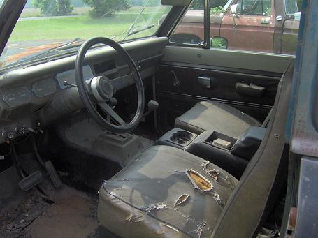

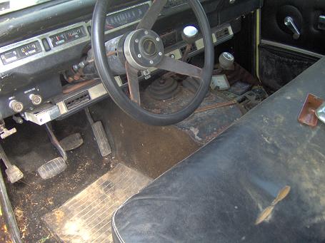

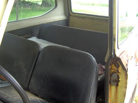

Rough seats... Buckets, with console.

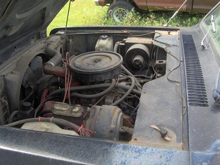

304, 2210c carb on top. :icon_mrgreen:

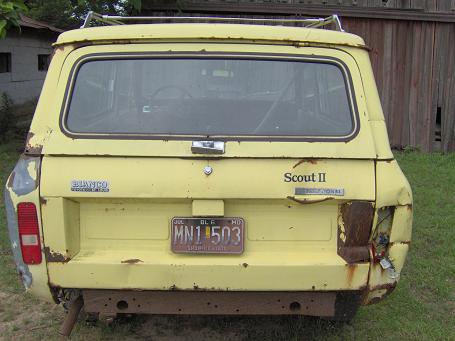

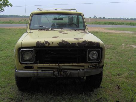

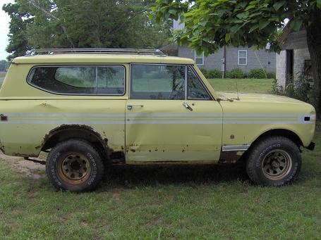

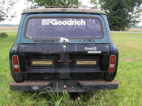

This'n is a 1979 Scout II fershure. Bought it $200 for parting out. Now, I'm not so sure I don't want it self-movable... :gringrin: fever is common in these vehicles.
It has a terrible body as you can see... Po (really just had it sitting) tells me he got it from some guys who pushed it out of a ditch with a d-9 dozer. :icon_eek:
After getting under this thing, I find out it still has a tab to say 3.54 gearing, same set as the '77 model.
Brake pedal is free, haven't even looked into it. By now I've got the dash disassembled inside, we robbed the hard top seals, and the only valuable part is the tilt steering / drivetrain / axles / maybe frame.

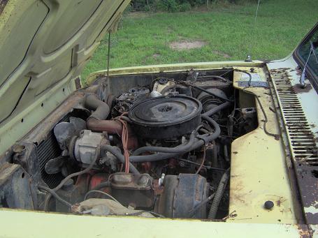

It has a t-19 wide range, behind a 345 with ac setup. The clutch is sloppy, I stole the coil, the radiator won't do, but the po says he started it up a few years back, and it ran fine. Has a replacement starter I do believe.
Passenger-friendly seats (were later successfully robbed, put into '77 no trouble)

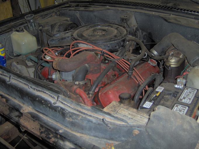

After removing radiator for recoring, just a good shot of semi-clean engine with no hood in the way.
Can anyone say soft-safari package? Maybe I'm wrong.

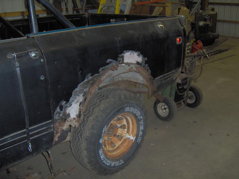

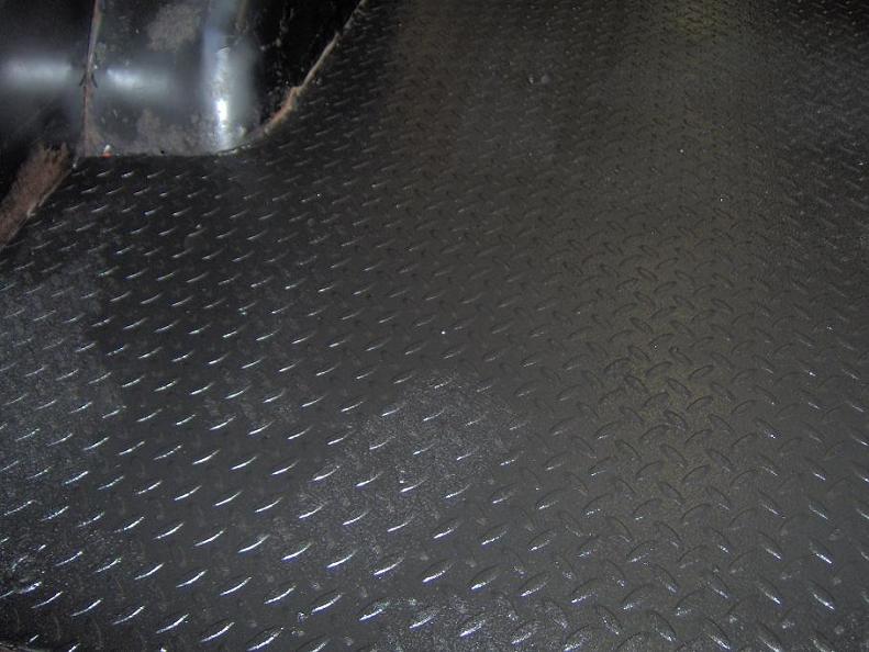

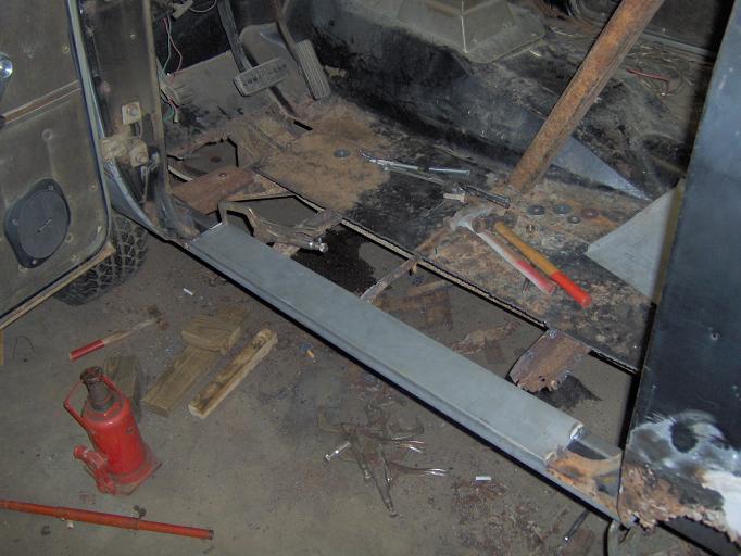

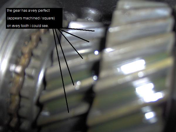

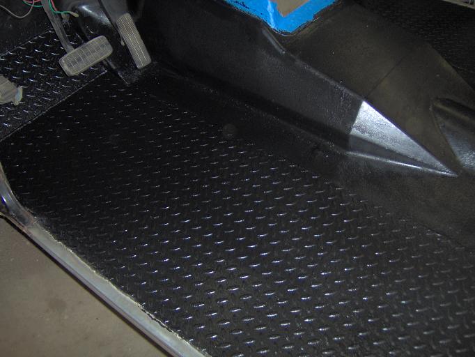

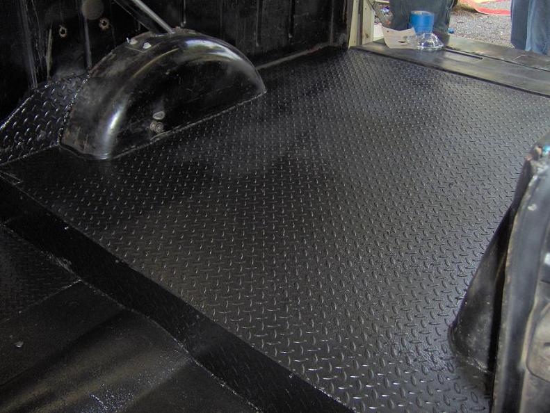

Looks like you got a case of ihism.....(they multiply) think it's incurable. Wish my floorboard looked that good. Keep up the good work.
Might verify that the rocker assembly is oiling if it has been sitting in the yard like you said. These things seem to have problems when they are neglected for awhile. The crud builds up in 'em.

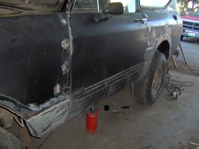

What you have there is an SSII that someone has put doors and a traveltop on. The grille, the stickers on the tailgate, the rubber fender flares, and the holes for the door insert are the external clues. Snaps on either side of the defroster vents to attach the covers to keep dust ect out of there and the vin tag on the kick panel instead of inside the door jamb are the internal clues.
It amazes me just how many of the SSII's show up that have been converted to steel doors and tops. I've got a set of fenders from one, with a garage full of parts I snagged a few years ago, complete with stickers and raw bondo covering the door insert holes.
Eric: mine fits the bill you described to a tee. We had figured this about the time we started really Looking at the vehicle, and I almost wish it still had the soft doors/top.

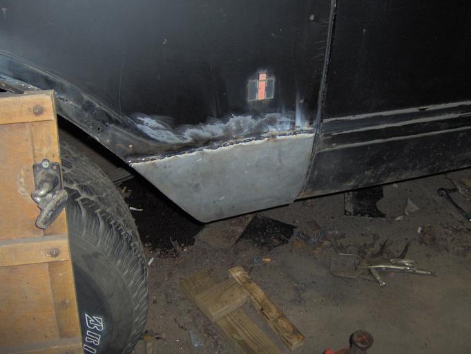

I got evidence for my Dad, who still thought it was a sii, when we began patching the panels at each end of both rockers. Grind away paint to weld, and surprise! We find where the soft door used to snap on.
We actually do have the soft top, but the problem is that my brother was joyriding without securing the top in a down condition... Result? A winded pop and death of the top.
He never had it with soft doors. Neither did the japanese guy who gave it to him. So, they dug up a hard top (after letting it sit in the rain for 2+ years!) and capped it off.
It had substantial rocker rot and it could still use a frame-off to deal with much left-over rust, but we didn't have the resources for such a project. I doubt I'll have the resources for a very long time.
