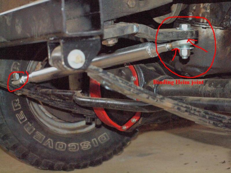

I would seriously reconsider running a welded together pitman arm. Also is that grade 8 or better hardware? Can't tell from the photo but they look to be grade 5.
Also review your rod ends. Thay are in a binding state and not flexing yet. As the axle drops they will most likely bend and break. Marked up your photo.
The pitman arm was fine till I welded in the splines on the wrong side:icon_rolleyes:so instead of my arm lowering, it raised:incazzato: so I cut it and welded it the other way, I ran 6 passes and later on I threw in some gussets for testing. I havent decided yet to build another or not....had I gotten it right the firs time:icon_rolleyes:.
Yes those are gr5s, im running them to dial the steering in, there also not fine thread, and if you notice on the knuckle side im not into the nylock enough to stop it from backing out. Currently the gr8s are sitting in my dd:cornut:
I could "s" the steering bar a bit, but it really dosent bind. I also used a fender washer to ensure that given failiure it might get sloppy but still have steering.
Thanks for the extra eyes:cornut: sometimes its easy to overlook the details.
