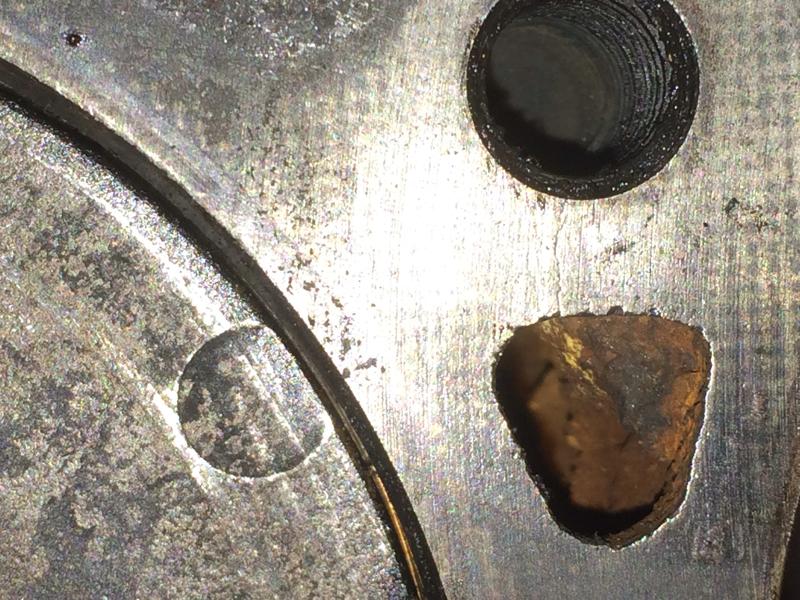

Here's a picture of the crack I found. Does it look repairable?

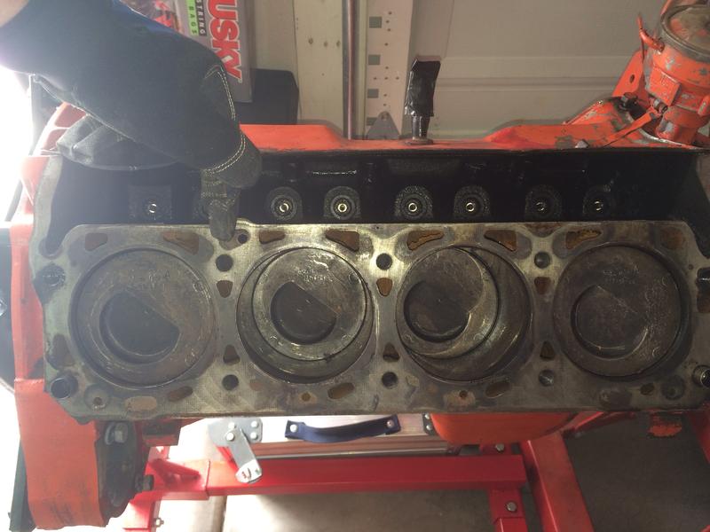

Is it my imagination or does the top of #2 piston have a large, circular relief that overlaps the "boot heel"? That piston doesn't look like the rest of them.

I assume you mean the anomaly between the water jacket and the bolt hole.
You need to use a dye penetrant kit to verify that the crack you think you see is really a crack and to determine the extent of the crack.
Then you can decide what, if anything, needs to be done to repair it.
