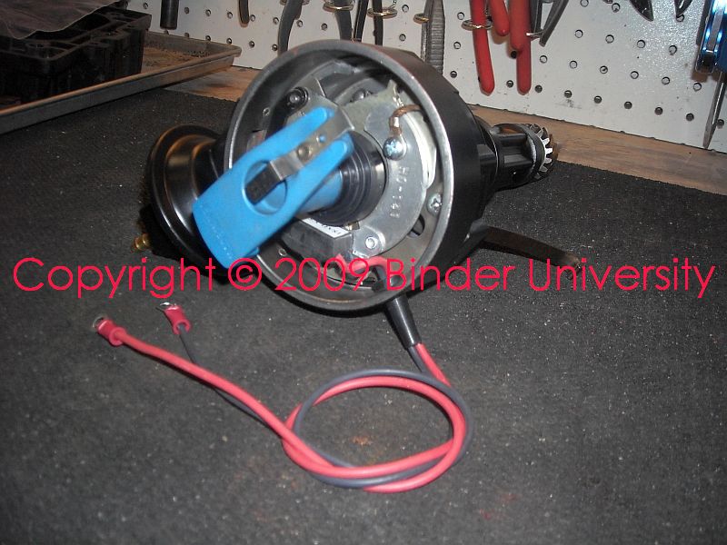

I'm doing some distributor work
I made the mistake of not doing my homework to check for the right p-tron unit and after a return and breaking my breaker plate, calling pertronix and getting the right unit(1481)...it was finally installed along with a new coil.....what a difference! Best $120 I have spent in awhile!

Naw....I figured it was kind of my fault and the parts guy for assuming my distributor was a prestolite. I am chalking it up as a learning experience...do your homework yourself and don't trust the parts guy!! The bummer was I removed the breaker plate and snapped a pin holding the plates together. The original ignitor had a plate and I assumed that my old plate needed to be removed...so I did and found out that the new plate did not fit in my distributor! Arghhh... I just read another thread about running extra quarts of oil....I was running only 5 quarts and my 304 was knockin' a bit....added another quart and seems to have gone away....this forum kicks ass!
