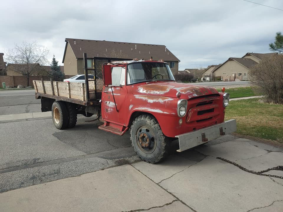

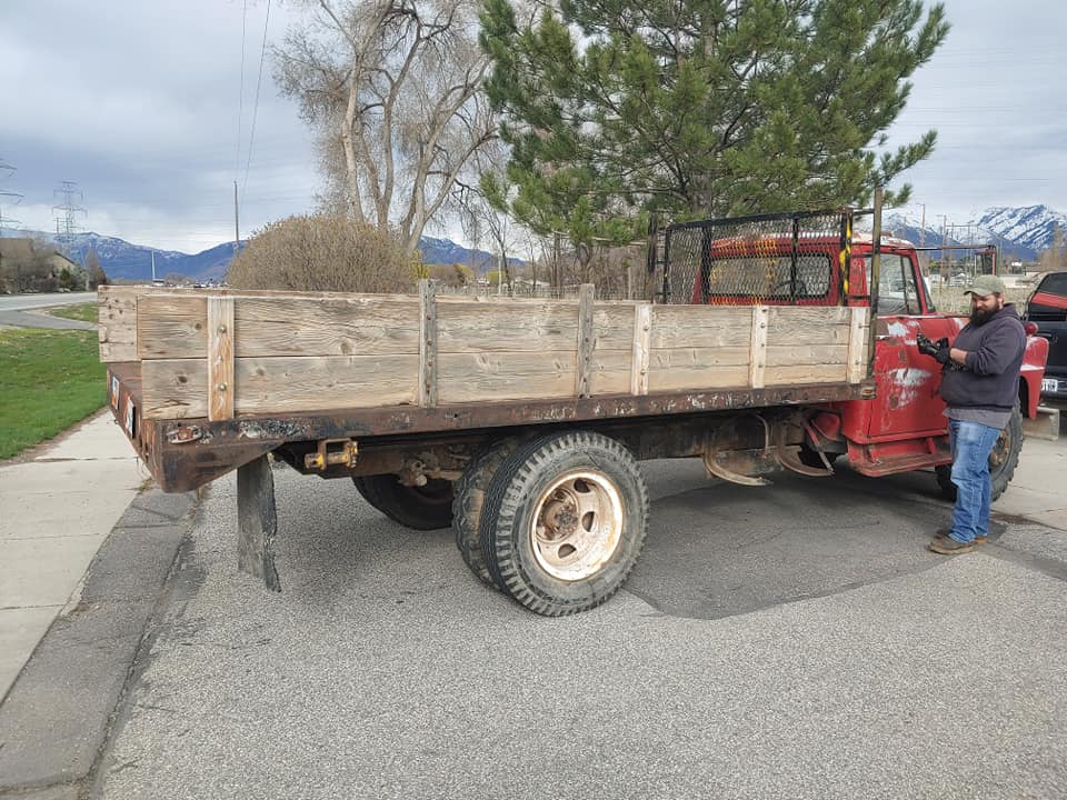

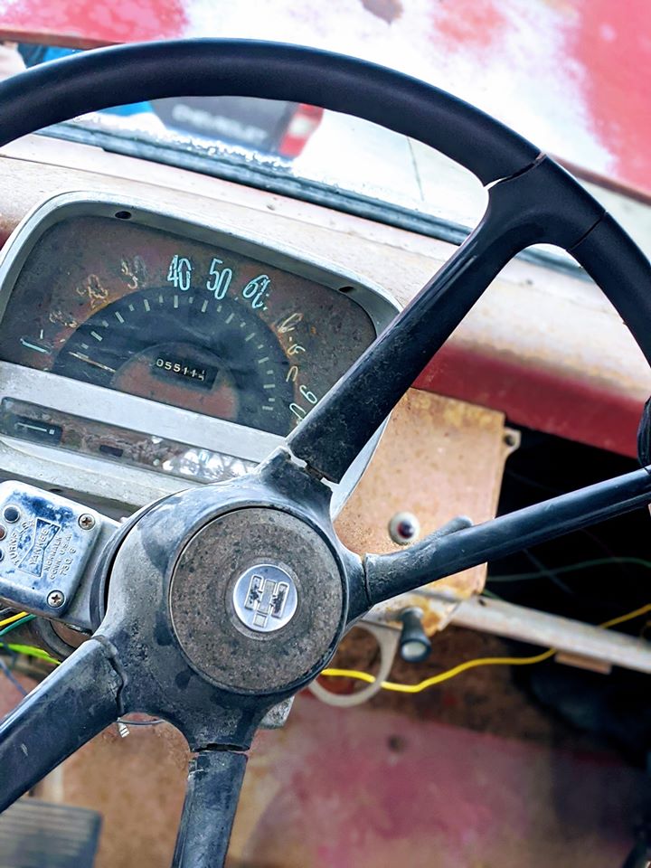

Here some pictures of the truck if that helps. Besides just Transmission/Clutch info I'm looking for any good technical information on this kind of truck, since I'll be doing all the work myself.
