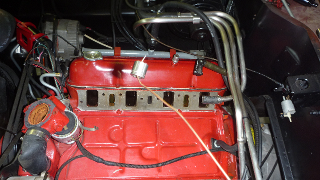

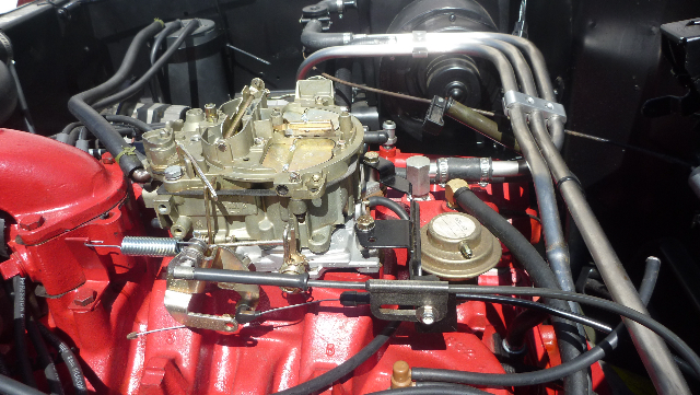

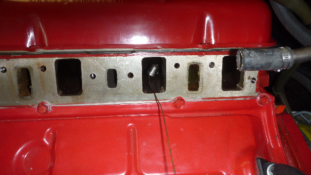

I dropped a stainless spacer down the manifold last week during a carb change. I could feel it with my finger, and figured I could coax it out with a welding rod. Then maybe the shop vac w/ fuel hose attached, and then more welding rod with double sided tape. You can see where this is going...

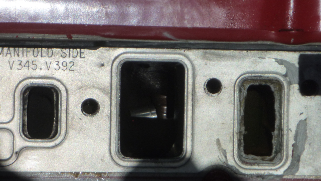

A friend is a captain at the local fire station, and he brought up their rescue camera for finding people in debris, and sure enough, it had migrated all the way down the #6 intake runner right behind the intake valve. So off came the intake. Pics document the pain. The spacers were to clear the egr valve on my modified 700r4 throttle/tv bracket.
On a good note, I did discover I had been sucking oil past a couple intake bolts that must penetrate the heads into the rocker area. So the gaskets got sealed up around the ports with black permatex (not rtv) and the bolts all got thread sealant. It does run better without the vacuum leaks (and the new carb).
