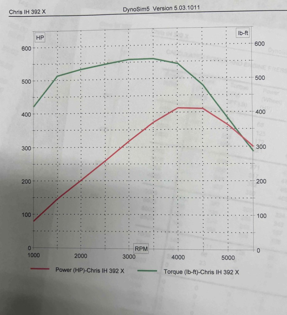

Some bench racing cam selection results included.
Not bad for an old ag water pump cornfield motor.
CID is around 440.
Compression 10:1.
2" long tube headers.
411HP/ 560TQ NA. Absolute torque monster😁.
Steady climb from idle to 4500rpm, then dumps after that like a brick.
I want it to climb to at least 5250, but like everyone else, limited by the heads.
With 7PSI of boost, this brings me to my goal of 600HP or better. 10PSI max puts me near 700HP.

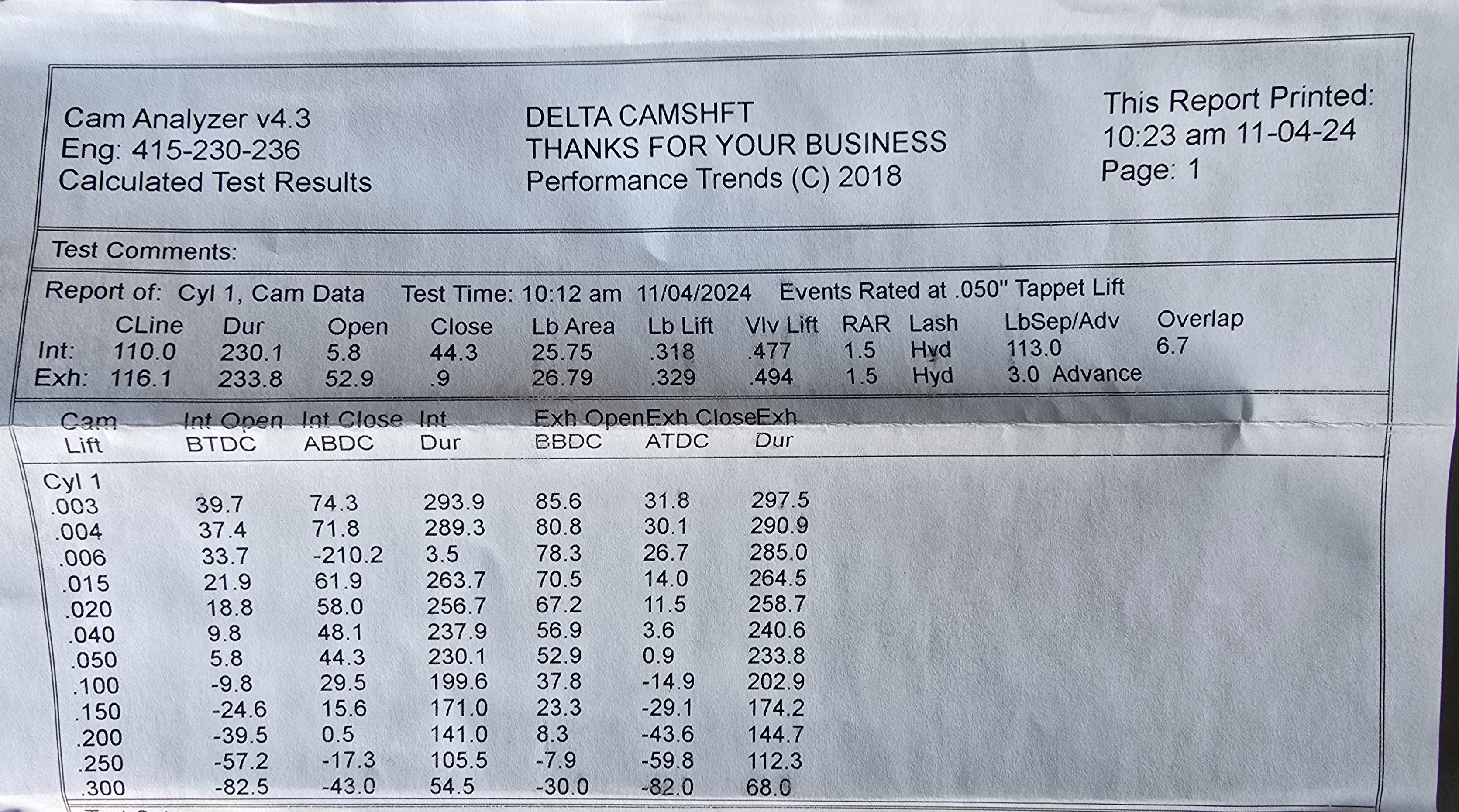

Here's the cam card for the motor. Regrind of an OEM. See how it does.
Lift numbers will increase from higher ratio rockers.
This is one option by Delta Cam in Tacoma, WA.
Another one in the works from Camcraft.

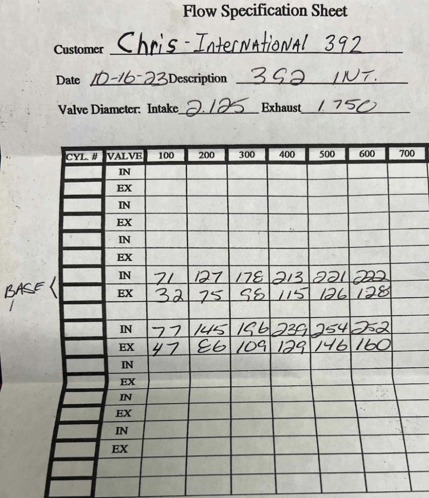

Head work is complete. Just waiting for new rockers to show up to assemble.
Final displacement is 440cid. 10.1CR.
Thank you. Going to be rebuilding mine soon. Waiting to see how yours turns out. What cam did you go with? You get the heads to flow enough? you can message me if its easier. Thank You Roger
