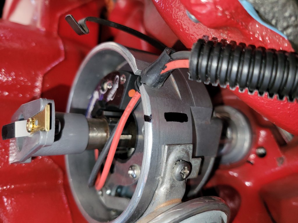

You shouldn't have to mess with anything other than idle for the 7448 Holley. Either your firing order is off, or your timing is too retarded. If the timing is too advanced, it will act like it's struggling to start with the starter. Have it at zero for the first start, then walk over and advance it until it runs smooth. The rotor relation doesn't really matter, as long as the rotor is in-line with the no. 8 on the cap. I typically line up the rotor on #8 TDC pointing straight at the top water pump bolt.

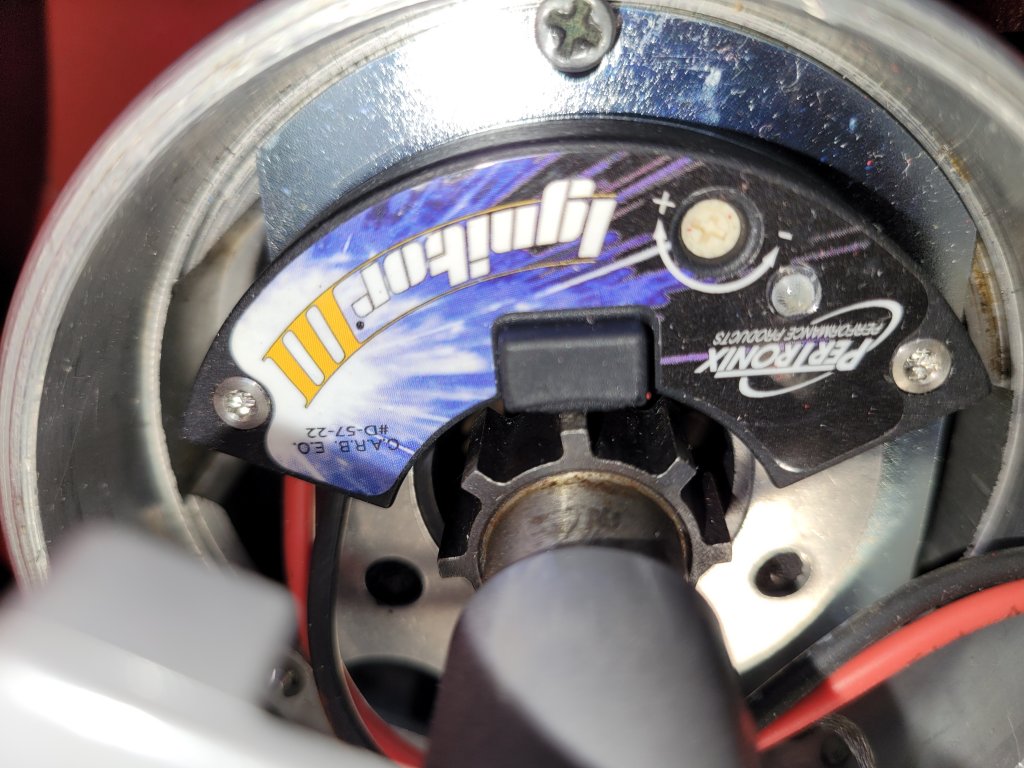

I doubt the Pertronix is going out, you can bypass all your wiring by simply adding a wire to the positive side of the coil to the battery if you are suspicious of a fault.

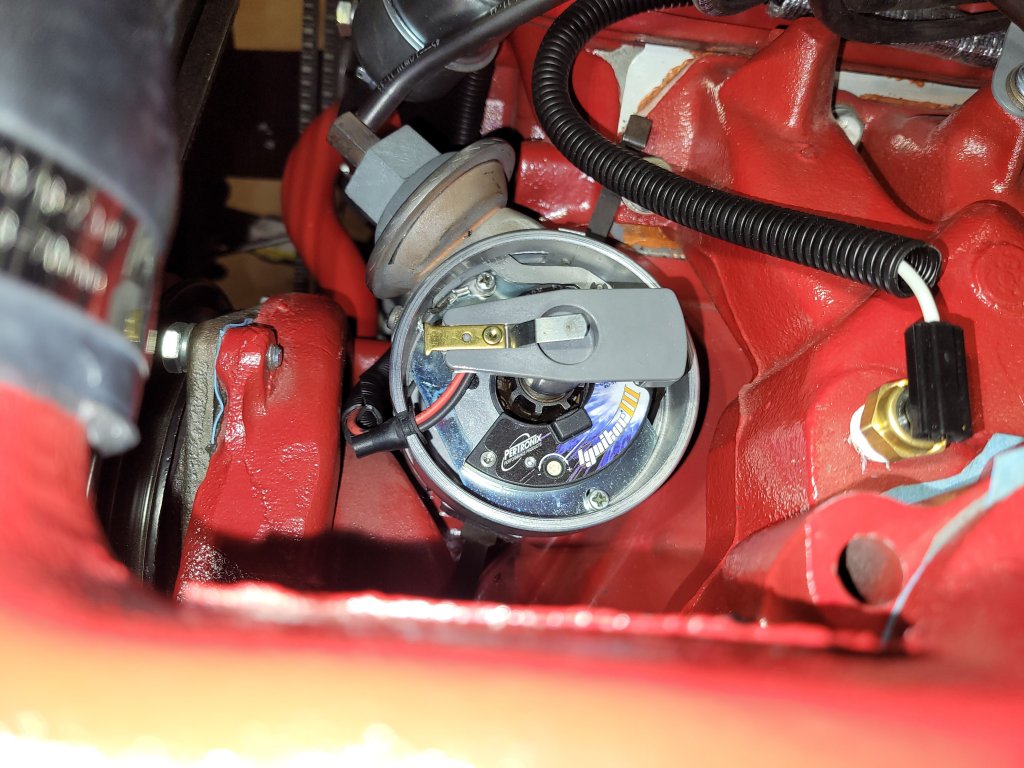

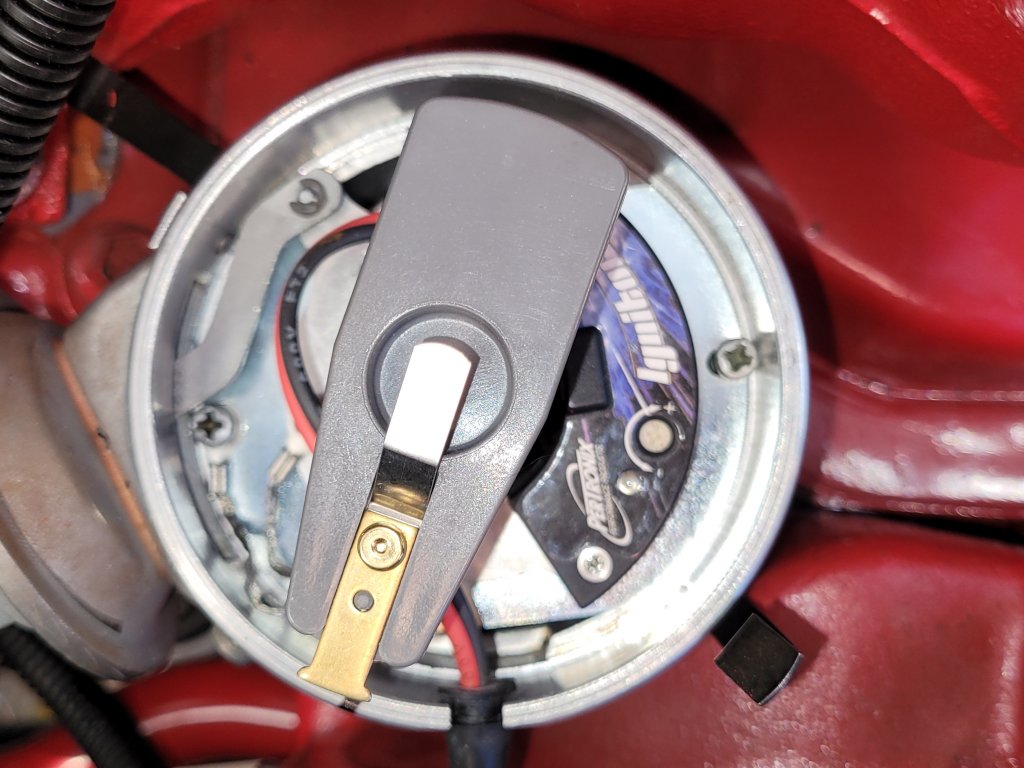

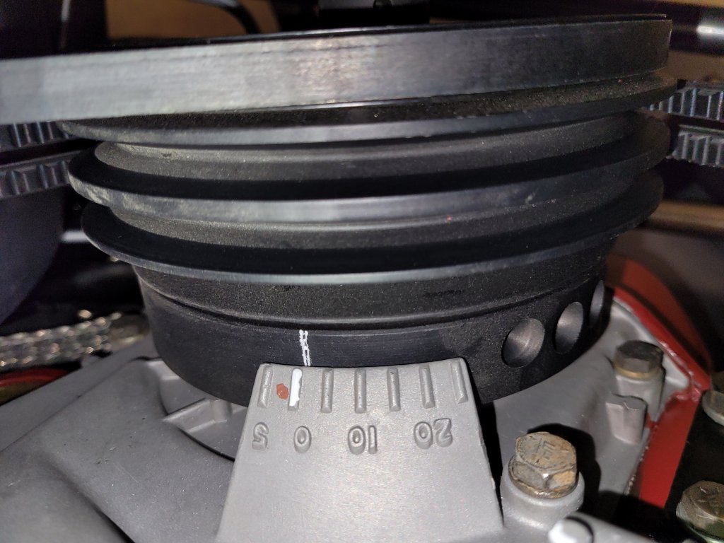

Zaedster thank you for replying. I did get the engine on TDC from cylinder no. 8, rotor lined up with plug no 8 on cap. In that position the engine would not start. I had to retard, turn the distributor counter clock wise a few steps at a time until it finally started. The 2nd picture above from the left with the black marks on the distributor reference rotor at plug wire no. 8 at TDC. I had to retard the distributor counter clockwise until the rotor at no. 8 is now positioned a little past the water pump bolt you referenced to get the engine to start. Would you think I need to pull the starter up to advance another tooth or two? Also when it was running yesterday I realized I forgot to plug the vacuum port. I removed the vacuum line to the distributor as I had the timing light ready. So it was running with a vacuum leak. Is the split duration cam a mild cam? I can not tell if that is the cam that is causing the lobie sound or its running out of time. When running it does not backfire, the exhaust does not blow black smoke and it doesn't diesel when it dies. If you get a chance can you go to my Instagram account 74_scout_ii_reviver. I have a video of it running so you can hear what it sounds like. I'm at a loss. Thank you for your help.
wonder if you found top dead center on the exhaust stroke and not the compression stork ? is that possible ?

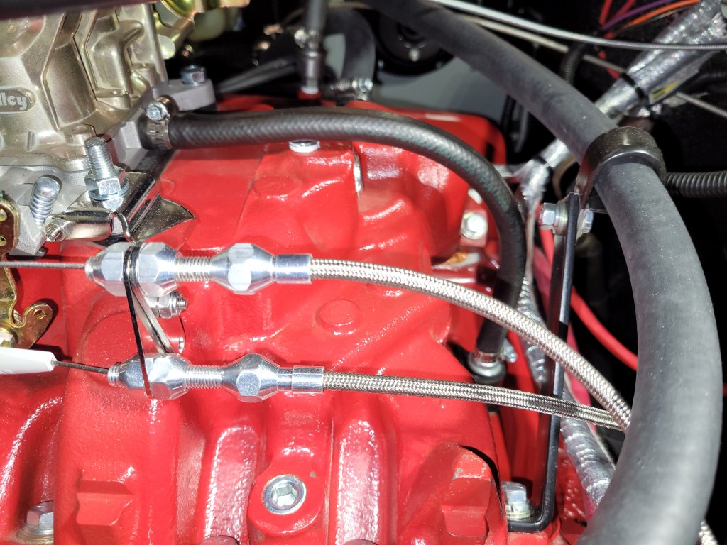

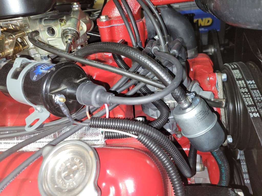

Zaedster, here are the pics of the hoses I believe you would like to see. Timed Spark Port to Dist Vacuum Advance, PCV Vacuum port to PCV to valley pan, spark arrester to air cleaner. The only other hoses on this are upper & lower radiator hoses and the heater hoses. In that video I did have the hose off of the disributor and I forgot to plug it. So the engine was running with a vacuum leak from the carb timed spark port. Thanks again for your time and help.

Looks correct.

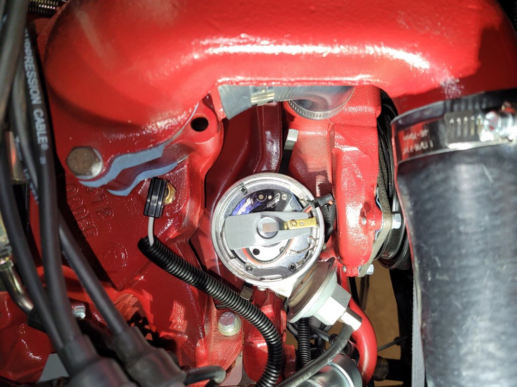

I can tell your distributor is in a funny spot. You want the vacuum advance clocked more in the center of the water pump housing and cylinder head. This leads me to believe you still have a timing issue of some sort.
Watch this video:
Remove all your wires and redo it after watching the video.

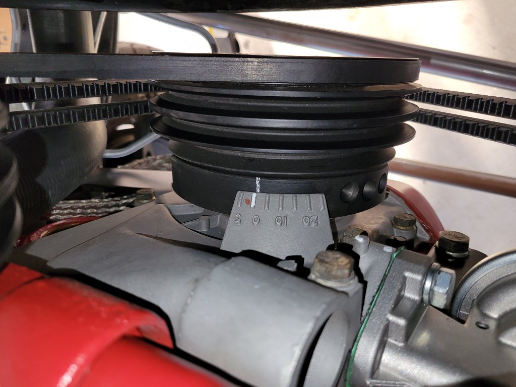

Zaedster, thank you for all the advise and especially uploading the video of your truck so I could listen to it. I did watch the video prior and will watch again. I've checked all my spark plug wires and they are all fully seated in the correct firing order clockwise on the cap with 8 infront of water pump bolt. Obviously I have something off as this task seems really easy. Get engine on TDC. Make sure rotor is position on # 8 plug wire contact of cap. I fully understand the process but I guess being off 1 or 2 teeth make all the difference.
Zaedster, I watched the video again today. My plug wires are all in the correct firing order and seated correctly/snug in cap and on spark plug. I will have to confirm tomorrow night if I am on TDC when I have my wife available to plug no 8 spark plug hole. Tonight I cranked the engine over myself watching where the rotor ended up when I felt the compression and looked at the marks on the harmonic balancer when they were lined up on TDC. The rotor was not lined up with the water pump bolt as it was more between water pump and valve cover. I initially moved it this direction to gain more retard as I could not get it to fire when I had it lined up with water pump bolt originally. I've attached new distributor location and spark plug pics. Some of the spark plugs are pretty soaked oil/gas? The plug condition is after a total of three minutes of run time. Should I go out and buy a new set of plugs.

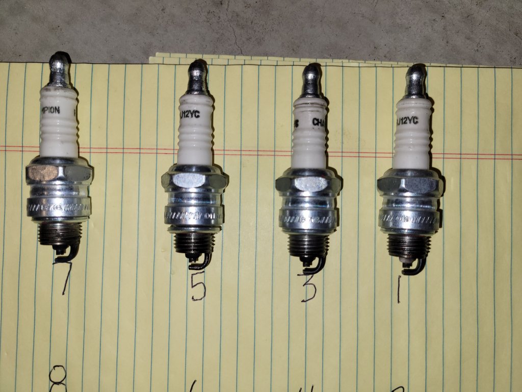

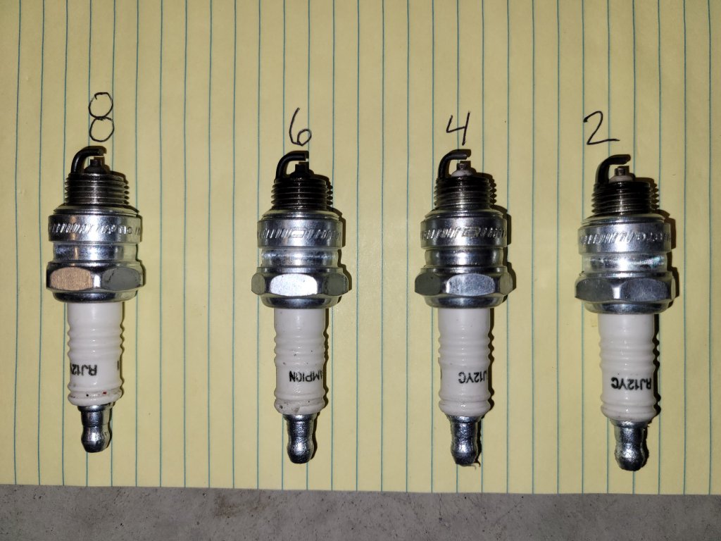

Just hit the plugs with brake clean. Did they get the initial cam timing correct when rebuilding the engine?
I had issues like that first time I put mine back together. Had the firing order going counter clockwise rather than clockwise.
I hope the engine builder got it right? It is a reputable builder here in SoCal. They rebuild my IH 304 that runs great.
I finally got the Scout running with advise from Zaed, Darren and a retired co-worker mechanic friend of mine Lee. I had to pull the distributor out and move it clock wise a tooth or two. It landed back where Lee my friend had originally set it. I believe most of my problem was me flooding the engine on the first time I tried to get it running. After that is when I made changes. Anyway distributor is back where it needs to be. I did get it running last weekend for 25 minutes long enough to break the cam in. While it was running it did have a exhaust leak. After running it I removed and replaced the break-in oil and filter with the same.
