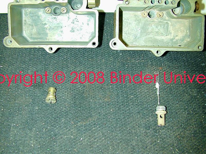

Ok, your carb data does match the Holley references I use.
And yes, if you can post a pic of the part ya need, I can make a positive I.d.
But from memory...of the two power valves seen in this pic,is it the "short" one as shown on the left in this pic...or the "long" one shown on the right side?? That's all I need to know!

The valve I need is the one on the left!

As ya can see in that other thread, ron identified that the standard motor parts hygrade kit you need is p/n 929a. The 928c kit I have used before has both types of power valves included but does not have the correct main body gasket. And that 929a kit has the "heat dam" base gasket/insulator which is imperative to use on these engines. That gasket individually is around $15 so that's a great bargain as it's included in the kit!
