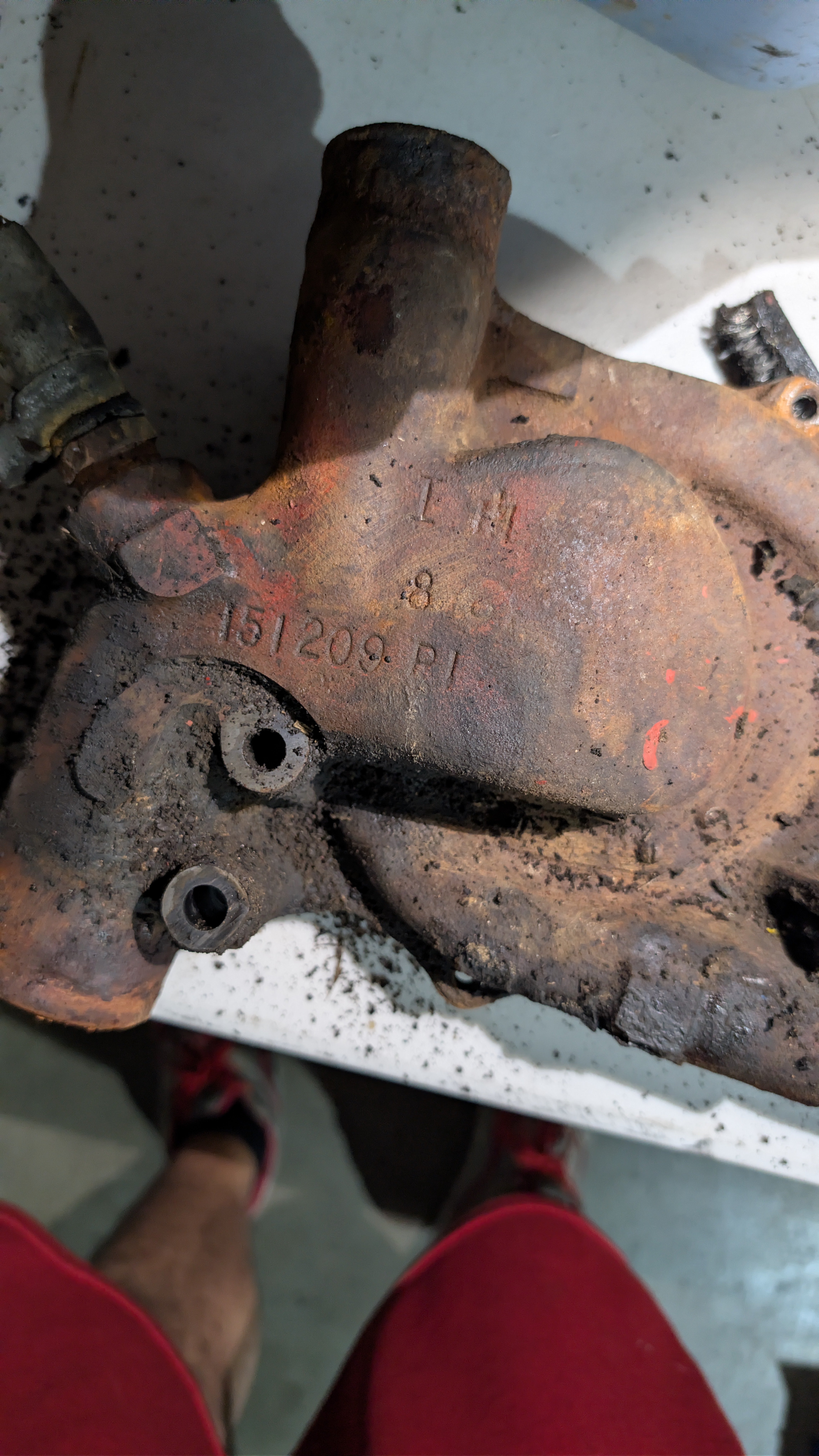

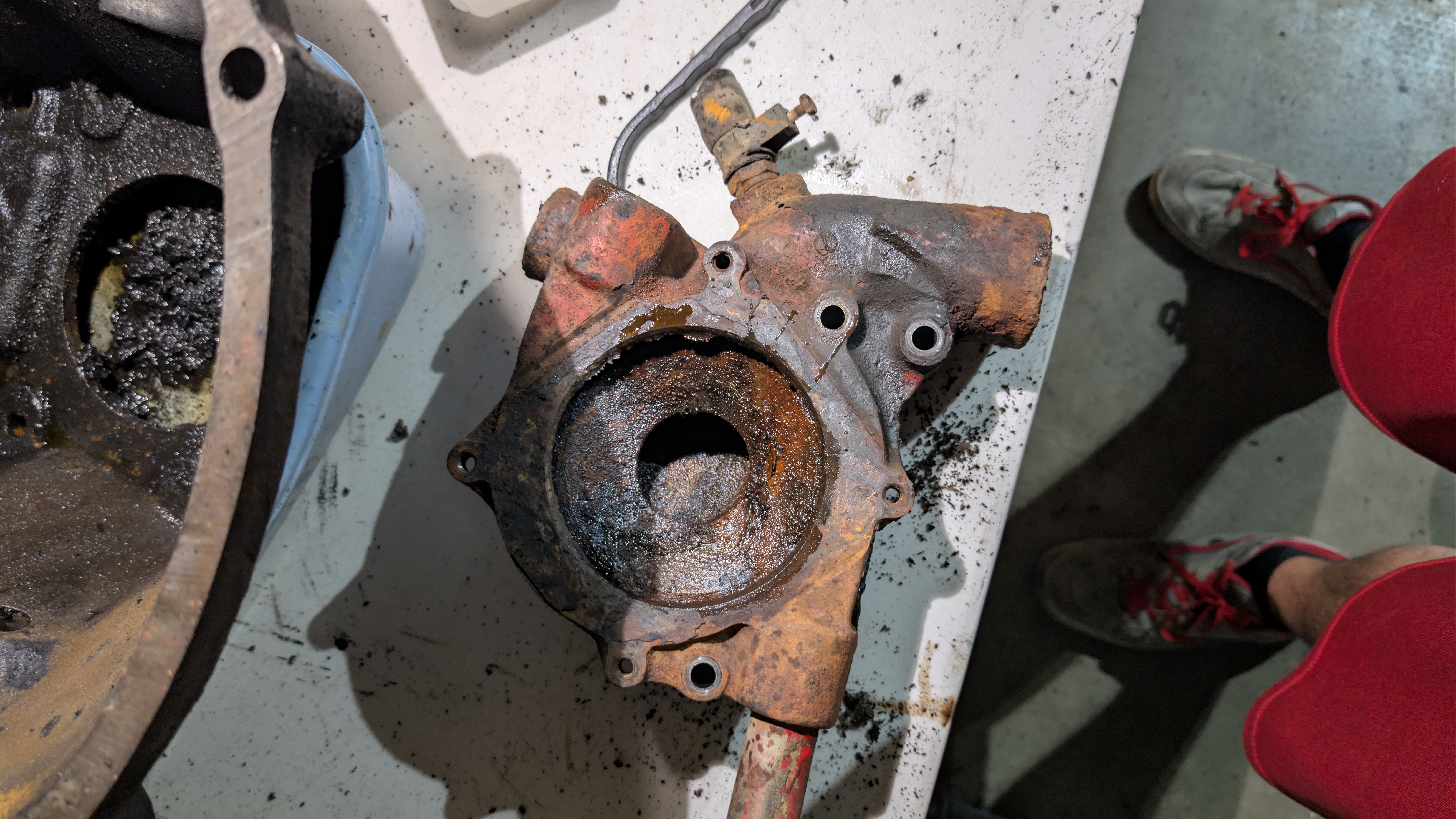

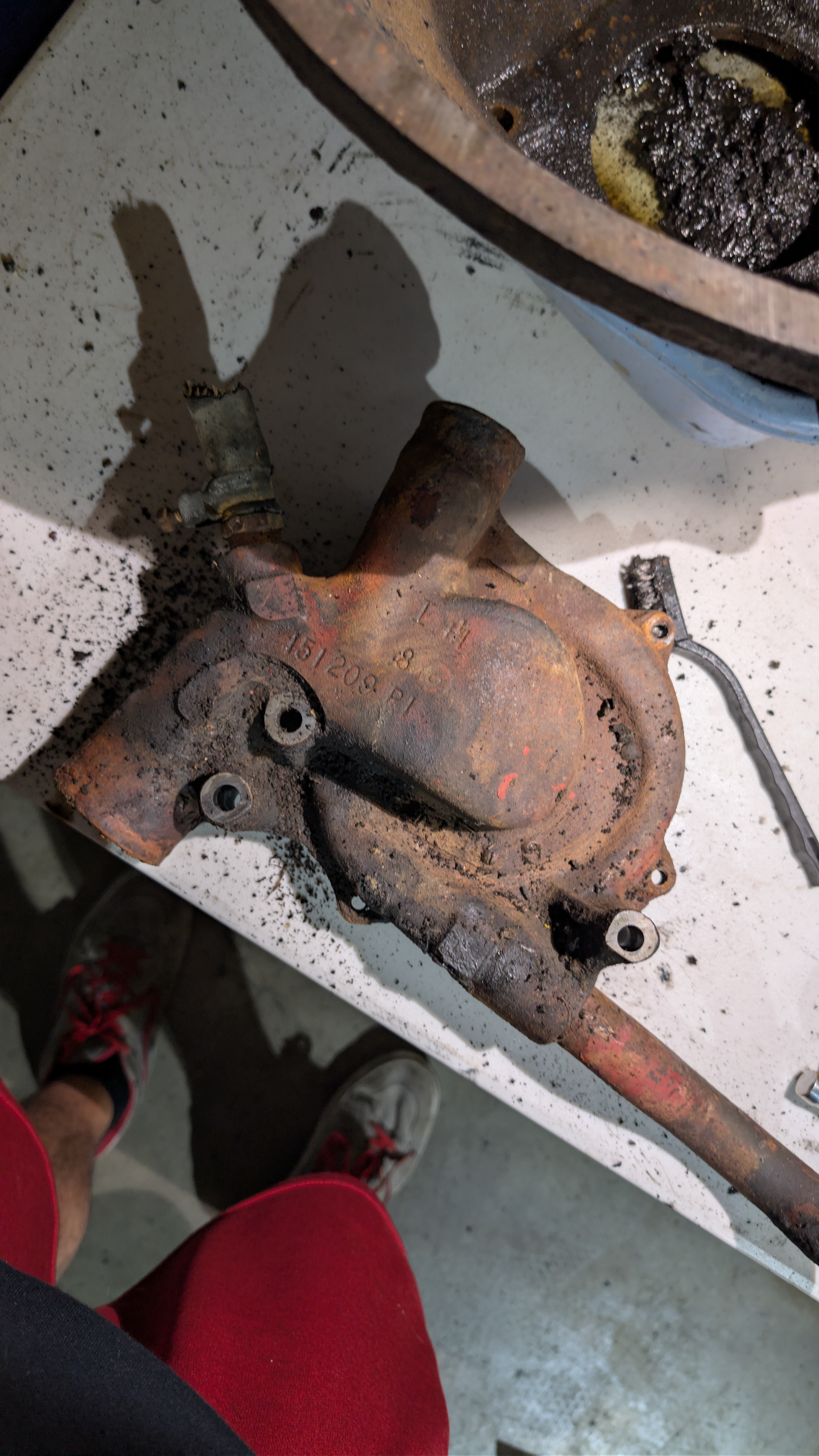

I am pretty sure this is a water pump but I have no idea pls help
BlizzardCola
View attachment PXL_20260124_055543871.jpgView attachment PXL_20260124_055546842.jpgView attachment PXL_20260124_055554619.jpg
I have a 1971 International Scout 2, 4 speed manual 4x4, with what I am pretty sure is a 304 5.0L V8 gas engine the part shown in the photos was taken off the front of the engine and I am pretty sure it is the water pump but when I look up the water pump for this engine and vehicle nothing matches I have looked at water pumps for the other V8 engines and they also don't look like this.
This is the only thing that comes close to what I have but looks slightly different and has the wrong part number identifier. Does anyone know what this part is and where I can find a replacement?
your picture is a water pump housing..... you still need the pump then need to reinstall the housing and then install the pump....
did you remove the housing ?
This is a water pump for direct drive fan or bolt on style fan clutch...
And this is a water pump for the "Big Nut" or magnetic style fan clutch...
If you need just the waterpump housing then best to call our parts department at 530-274-1795. They do not make new ones so only thing available is used.
