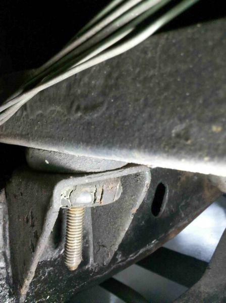

I finally got my suspension finished - r/c 2-1/2" lift, new shocks, 5" shackles front and rear, new sway bar. Before I go size tires for this thing I decided I'd also take care of the body bushings since they're shot and they will affect the body height.
Looking at the bolts I see two sets that are going to be annoying. The ones at the rear of the truck and the ones behind the front seat are both "blind". I assume I'll need to drill holes in the floorpan to get at them. The rear ones have a "bump" in the floorpan that's easy to spot. The others have no markings whatsoever.
Any advice on how to get at these? Barring any better ideas I'm going to take my measurements and drill at my best guess as to where the bolts are.

When I did mine I just lifted up the floor mats. It fixed a lot of squeaks and clunks too. The poly bushings are holding up well after about 15 years of hard use.

Perhaps you can leave a nut on the end of the bolt and use an approved striking device to dimple the floor pan where the head of the bolt is. Then use a 1" hole saw to open the hole.

Between my last reply and this one I looked again at the problem mounts. The "bumps" above the rear-most mounts are not caps or covers, they are the tops of carriage bolts that go through the bed floor. It was hard to tell through the many coats of paint. They were easy to loosen/remove.
Interesting idea on marking the location. I'm off to buy a 1" hole saw, I don't own one yet:) I'll let you know what I end up doing for marking the locations, and how well it works out.

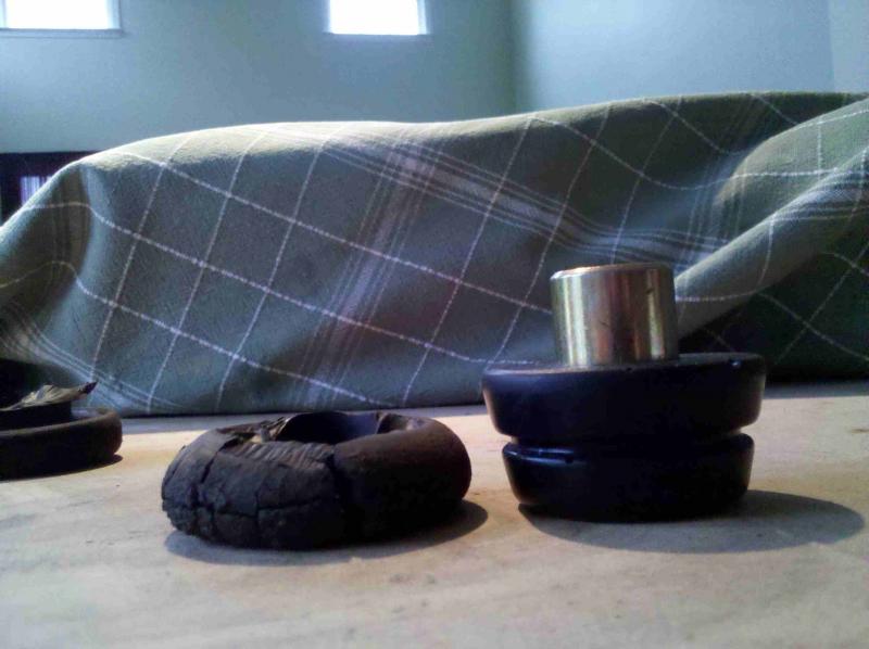

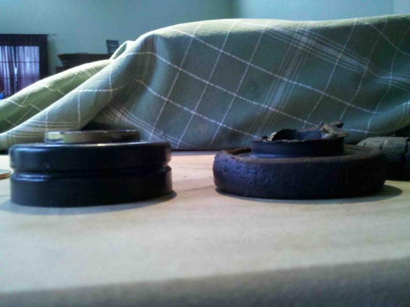

Bushings replaced, no major issues. I used Energy Suspension body mounts (they sell them here...). It looks like the new ones are about 1/2 inch taller than the old, squashed ones.
First two pics, upper and lower bushings, old and new. It's not quite correct to talk about upper and lower with the old ones since they are one piece. (how did they squish that thing through the mount, and why??) I got them out by grabbing a serrated knife from the kitchen and cutting them in half. There's a metal ring in the middle that you need - pry it out. The new upper bushings didn't look like they would fit into the ring, but they popped in when I torqued down the bolts. I stopped at 35 foot pounds. The bushings were starting to deform, and it seemed like enough. I'll check them frequently for a while.

Striking the bolt to Mark the spot on the floorpan didn't work for me. Perhaps I wasn't using an approved striking device. I measured and marked, and miraculously hit the right spot on both sides.
