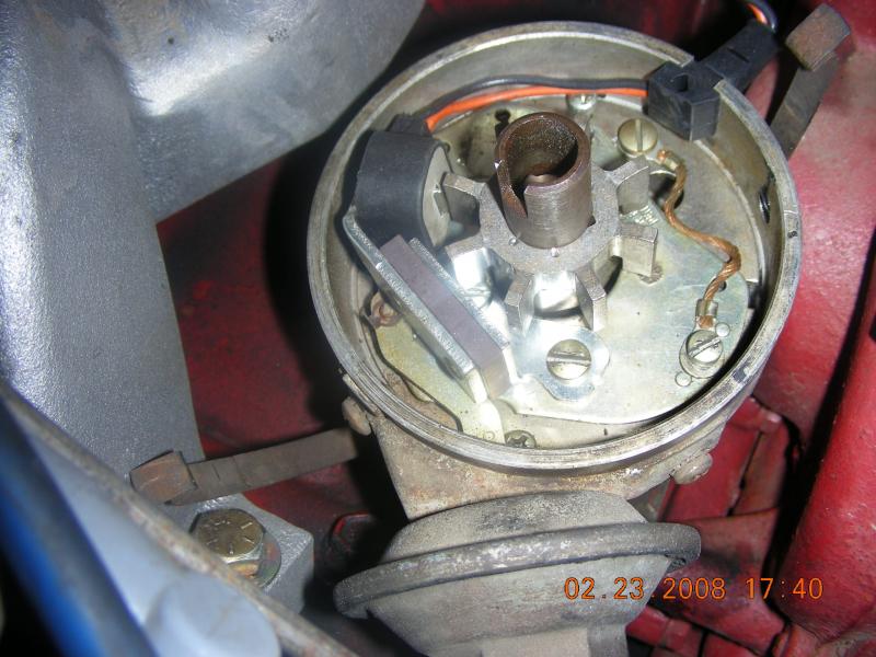

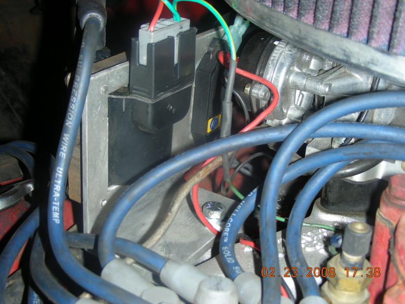

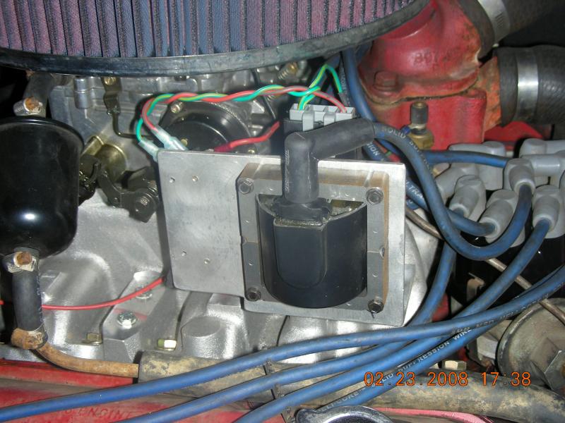

With the gold box we just reused the original pickup that was in the ditributor and just wired it to the GM module and used the Ford coil. I have attached a few pics of the inside of mine that I modified ed
Hmm...well...that was smart! You don't even need to think about the timing then... Just upgrade the coil and control module. Smart...
