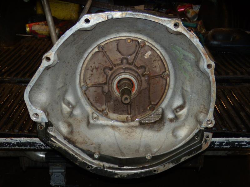

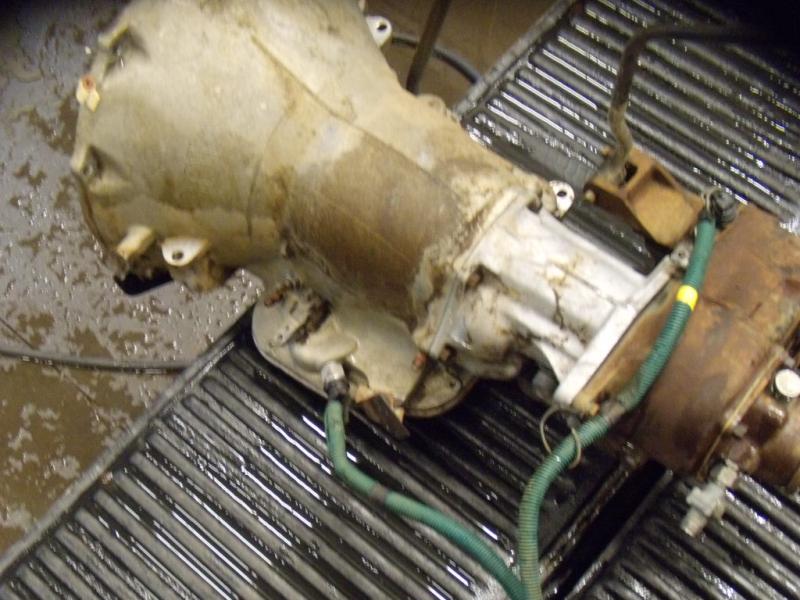

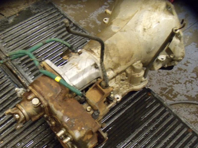

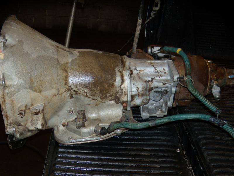

I was wondering if this transmission is 727 IH? I had a 78 Scout which I crashed 25 years ago, I salvaged the transmission and had it stored at my uncles large storage shed. I now need it for my 73 1310 pickup. I ran the casting number on the transfer case, and it up Dana 20, however I see absolutely nothing for a id plate of the transmission. Thanks

That is a IH tf-727 automatic mated to a Dana 20 transfer case as used in IH Scout II applications. (Scout II, Scout II terra and Scout II traveler)
the transmission part number is stamped into the case just above the drain pan on the left side, visible in pic .003.
The IH pickups & travelalls used the same transmission, however, with a divorced transfer case....utilizing a short drive-shaft between the transmission output & the transfer case input.
As it sits, the transmission and/or transfer case is ill-suited for a full-sized IH 4x4 vehicle.
As scott said, the t-case is a no-go for your f/s rig, but the transmission could be made to work by exchanging the rear adapter housing and output shaft for an IH full size tail housing and corresponding output shaft. It isn't a simple bolt off/bolt on job. Assuming you have the correct donor parts from the apparently defunct 727 in your 1310, both transmissions would need to be completely torn down in order to do the swaperoo. This is all a moot point anyway, as you'd be ill advised to rush any auto trans that was not carefully prepped for storage back into service after so long without doing a complete overhaul. The rubber seals have shrunk and rotted. Any atf that was not purged from the system has completely deteriorated from a chemical standpoint, and has likely been contaminated by 25 years worth of moisture condensation cycles. Not saying its a worthless pos, but it is a builder core that isn't ready for prime time just yet. What's the story on the trans in your peekup? Probably money and certainly time ahead to have that one serviced if possible.
