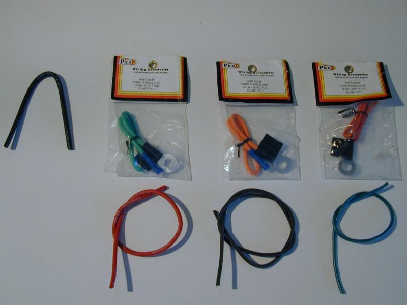

Do not use a piece of 14 gauge regular wire!!!!! Do use a piece of 14 gauge fusible link!
I know this is kinda confusing, but fusible link material is completely different from regular primary wire in it's design and construction. But it's sized the same.
More details in this thread:
http://www.forums.IHPartsAmerica.com/electrical-tech/4820-couple-easy-questions.html
The pic attached is for a "tutorial" I did regarding the fusible link subject. It shows pre-packaged links (in this case for generic Ford applications) along with corresponding pieces of bulk material from spools I have.
