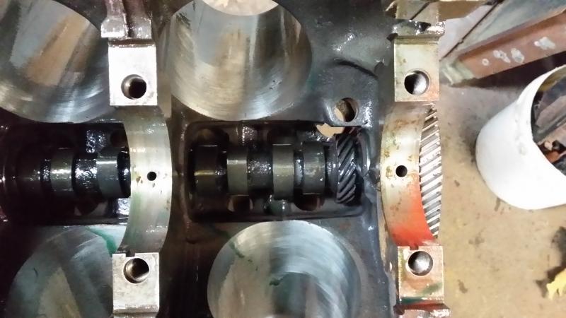

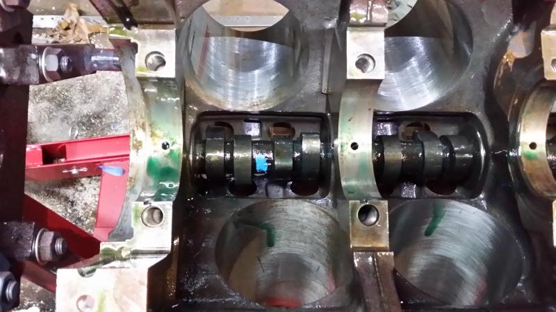

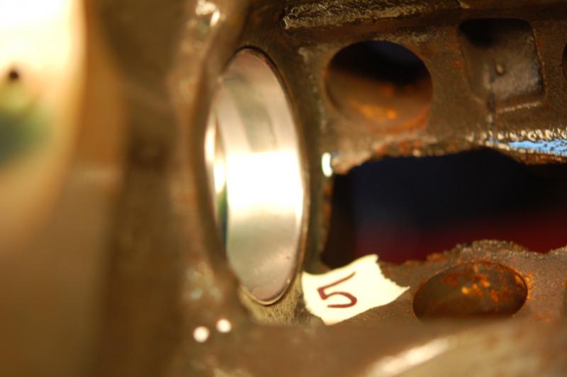

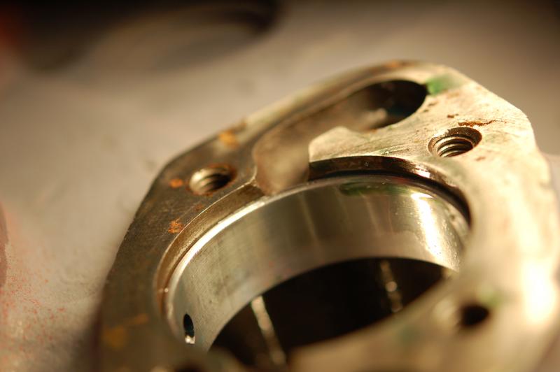

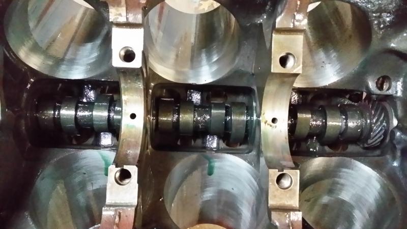

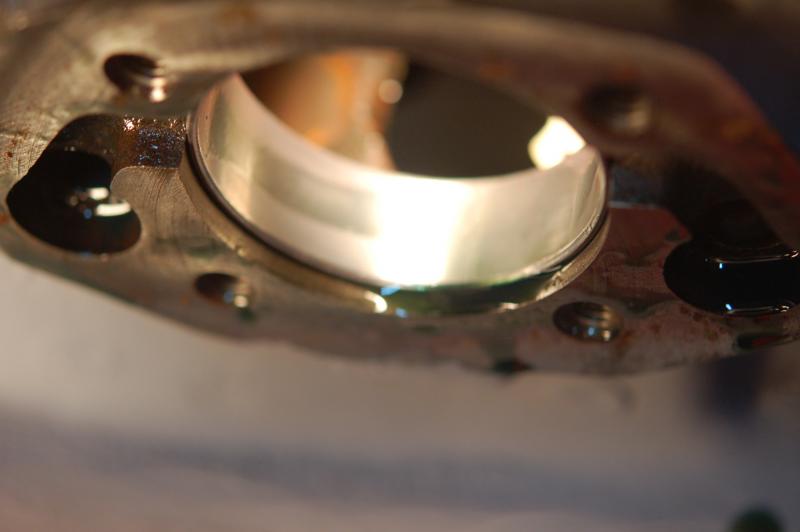

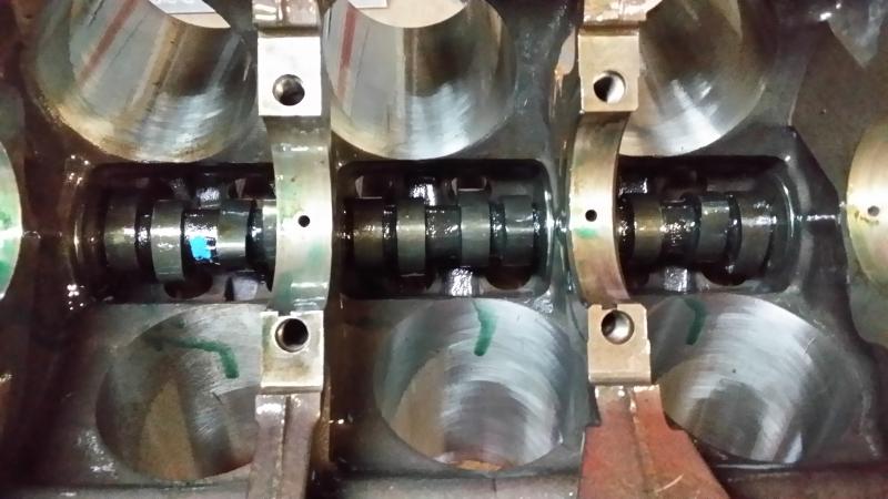

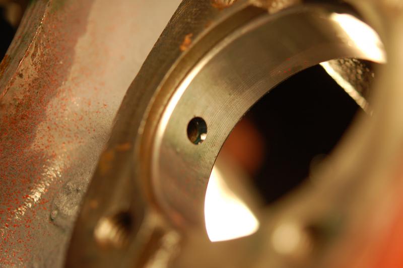

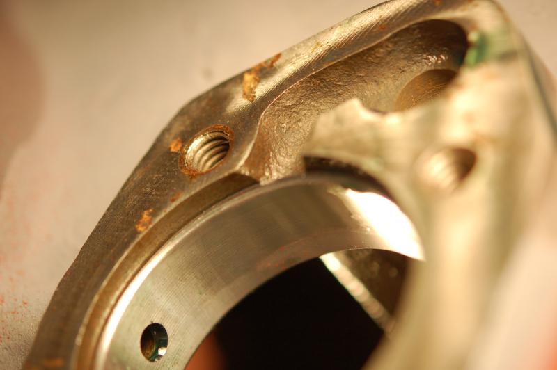

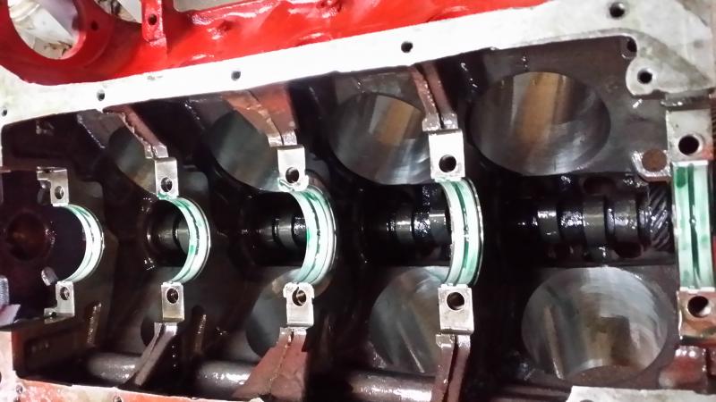

Ok that location looks great.. :thumbsup:
oil the bearings real well with oil, slip the cam in and verify that it rotates with light finger force. If it is tight, turn it a bit and slip the cam out. Carefully look for shinny burnish marks on the bearing babbitt surface that indicate where the binding or high points are.
The smaller sized and shiniest spots are where you should start. Those are usually the high points with the large areas being the side opposite.
The back of a stainless spoon can be used to work the high points down. Just rub the high spot with force repeatedly. Use your finger to feel the high spot and that you have made progress and retest with the cam. Repeat until it spins easily.

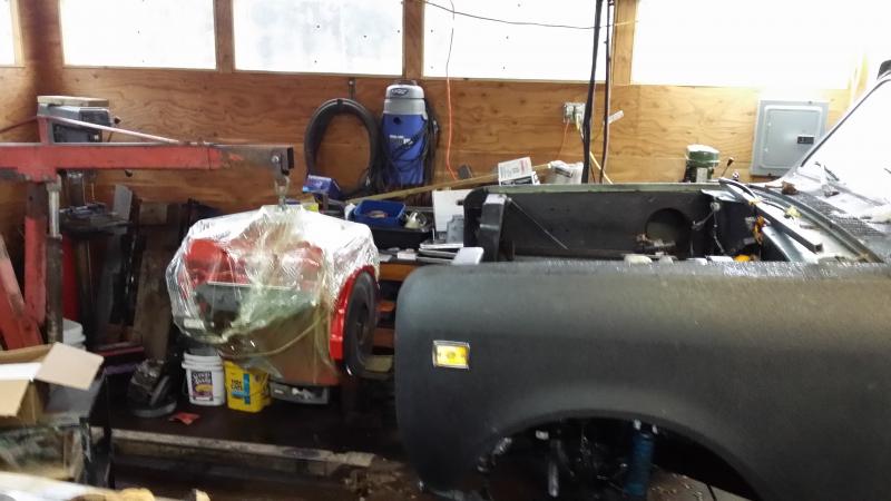

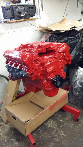

Brought engine home today, decided that I had enough head room in garage to lift it into place

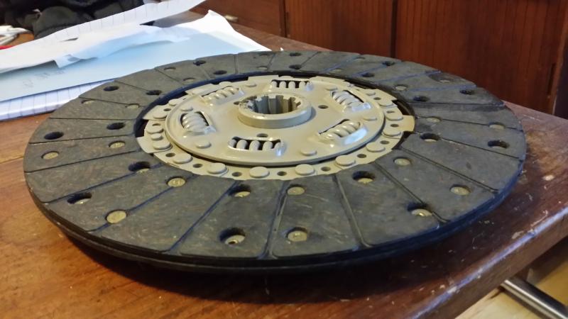

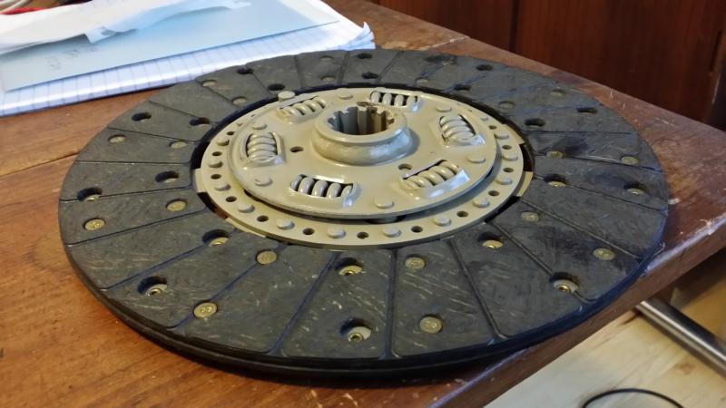

Which side of the friction plate goes towards the motor?
Long nose
Or short nose?
Typically the longer reaching side goes towards the trans.
Lay it in the flywheel long first and see if there is a clearance issue. Even if it fits I would be concerned about the spline engagment. So long back is the best.
Yup, got my service manual back from the machine shop yesterday and it says long side towards tranny. Absent the manual (or expert advice...) I tended towards your thinking of maxima engagement of the splines.
