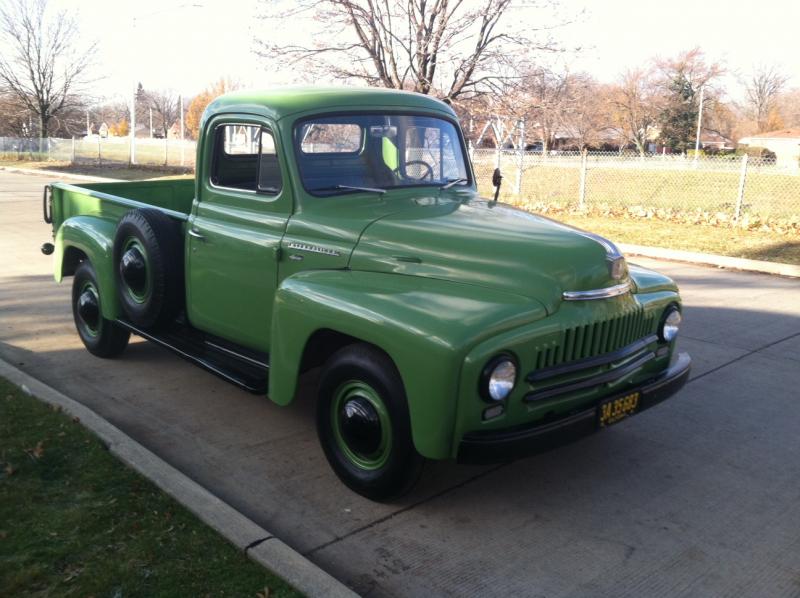

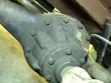

I have a 1952 l-120 in line six and want to change the rear axle raito to lower the rpm's. It does not seem to have the Dana that I am used to, what is it? Can I get parts and what are my options to lower the engie speed. Here are some pics.

What you have sir is a very nice truck! It is so nice to see something in good shape and apparently original.
The l 120's rear axle was an IH built unit. Axle code is 1402 with a model number r 1070 (going on literature of the day); drop out gear set.
The ratios available were: 4.1:1; 4.77:1; and 5.13:1. There might be a tag left on it showing the ratio. Or you can count the drive shaft turns it takes to equal 1 revolution of a wheel.
Your only option to change ratios is find the same model axle with a different gear set.

That is sharp and clean. Not many gearing options according to my friend greg. I suppose going from a 5.13 to a 4.1 would make for a decent reduction in engine speed. Not that much of a gap between 4.77 and 5.13. It might be tough to justify the work in that case.
