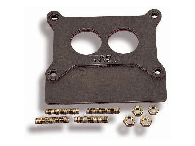

Do you have a good insulated carb base gasket installed? Can't see from your photo.
The Holley p/n 108-52 is recommended for the IH SV-8 engines.
It insulates the carb and deflects radiant heat away from the fuel bowl.
I have a heat shield gasket that I purchased from ihparts, it is similar to the one in the picture, but it offset and doesn't shield the entire float bowl.
