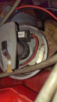

Hey, before you make your purchase, go ahead and remove your current module and snap a pic of the internal distributor housing. I just want to make sure that your distributor is a points version and not the Holley electronic aka gold box. What I can't tell conclusively from your pic is if there is a breaker cam or a reluctor wheel under the black center spool. Don't fret if your plastic dust cover comes out in chunks. It looks brittle and the integrity has already been compromised. You can discard it if you'd like. Another thing I noticed is that at least in the angle of the pic, it looks like your vacuum advance canister is oriented nearly all the way towards the passenger side cylinder bank. It May be that your timing is a bit retarded. Now that has nothing to do with you not getting any fire at the spark plugs. I'm just saying that when you get it running again, it wouldn't hurt to throw a timing light on the situation to see where your timing is set. If its around zero degrees, you could easily advance the timing 8, 10, maybe even 12 degrees to put a little more pep in the ol' girl's step. First order of business is to get it running again. You can fine tune later on.

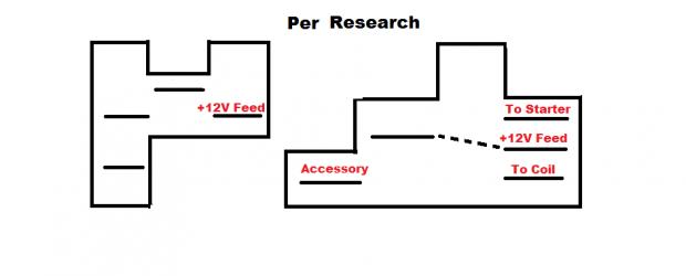

Also, your mention of the acc issue made the light bulb go on over my head and thinking, of course it should be that way, like I mentioned I rewired every inch of the truck with the ez wire kit so I determined I must have wired the ignition switch on the column incorrectly. I'm finding conflicting info in the ez wire manual vs. The Scout manual. I've tried them both and tested them by reading voltage at the power feed to the radio, not the radio constant. I've attached crude sketches of the wiring that I've tried, labeled whether its the ez instructions or my own research. Neither work. In both cases, I only get power to the radio when the key is in the 'on' position. Next question is, do I have a bad ignition switch?? When I bought the truck, the po had removed the plastic cover around the column and I saw all the makings of an electrical scavenger hunt going on so I'm thinking its possible that it was doa when I bought it. Thoughts? Oh and I have that dashed line on the 'research' sketch to indicate that those two points are connected but forgot to add it to the ez wire one, just my error but it appears from what I've seen and read, that those two posts are connected anyway so doesn't matter which the +12v is supplied to.
Also, I'll take a pic of the innards of the distributor as well, even though it appears the pertronix might be ok, I'd like the info for the future since I'm bending your ear!

Your fuse block should have a circuit dedicated and labeled for your radio power feed. The sii ignition switch is the uber-common delco/remy design that was utilized in elevendeebillion GM vehicles during the 70's and 80's and utilizes a molded plug with female blade terminals that only fits one way onto the corresponding male blade terminals on the switch. Its possible that the switch bracket is out of adjustment just enough to prevent your plunger rod from fully engaging the switch contacts when you rotate the tumbler to the acc position. This would also throw off your other switch detent positions in a similar fashion. The first thing I would want to verify with a simple 12v incandescent test probe is the presence of current from any of the wires exiting your ignition switch when in the acc position. Confirm that any hot wires you find in acc go cold when the switch is turned off. That would be your accessory feed to the fuse block. Clear as mud?

Now that you mention it, the switch bracket does look like its been mangled a bit! Someone appears to have had plenty of coffee one morning and went to slamming a steering column in place. I had a feeling that the Scout switch was the standard GM switch so I'll roll with that. Not only that, but it lines up with the schematics in the manual.

Also, I took more pictures of the dist. Without the dust cover. Not the best pictures in the world but maybe this will confirm the type. I'd like to have that info for a rainy day.
I still can't tell from those pics. What's hiding my view is that black (magnetic?) item under the rotor. I've never purchased or installed a p-tron myself, so that's why I don't have the proper nomenclature for that item. Anyway, underneath it, there will either be a breaker cam (for contact points) or a reluctor wheel (for electronic ignition) a breaker cam will have very subtle ridges corresponding with the number of engine cylinders. A reluctor wheel will look sort of like a miniature martial arts throwing star with very pronounced ridges that correspond with the number of engine cylinders.

Good on ya! I think overall you got pretty lucky on this deal and you learned in the process without it breaking your piggy bank. Also keep in mind that if your dizz is a Holley curved points as we believe, but have not yet confirmed, you can always revert back to breaker points in a pinch. For that you would need to have an approximate 1.8 ohm ballast resistor in place to interrupt the switched b+ to the coil and a bypass resistor feed wire from the starter solenoid 'r' terminal that would run either to the coil + terminal, or the coil side of the ballast resistor. Six of one, half-dozen of the other for that wire routing. Actually, taking the time to set things up so that you can easily make the switch over to points in the event of a p-tron failure way out in bfe is a wise, boy Scout be prepared fall-back. Points aren't sexy, but if they get the engine fired up and get you home...they're a damn sight sexier than pushing the sumbitch or paying a hook to come tug on it! Know wut I meen, vern?:crazy: I can baby step ya through the process for a clean setup if you want to do the leg work at some point. Not really much to it though.
