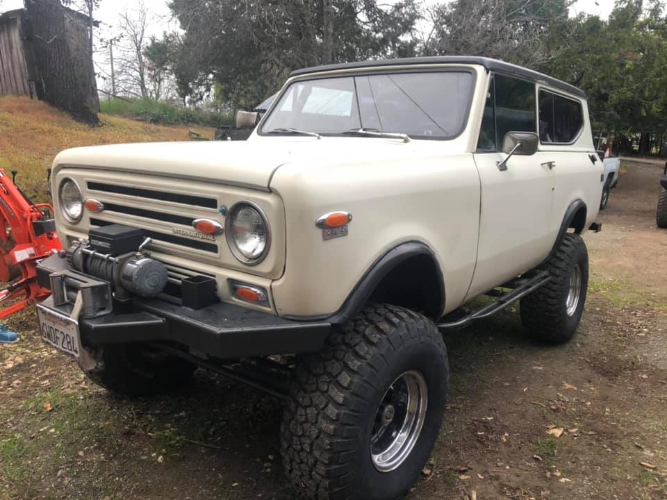

Just picked up this 73 scout. 85 ford 302HO mated to SM465 to NP205 running to D44s with ARBs and 4:56 gears. Seems like newer frame and cab was put on but I suspect original wires? There’s lots of altered wires and it’s got a kill switch under the dash because there’s a drain in the system that if I don’t kill the electrical while not running the battery will be dead in less than 2 beers at the bar...choices? Chase the old wiring issues like Rocky chasing chickens or pony up for new wires and learn how to install. What says y’all?
