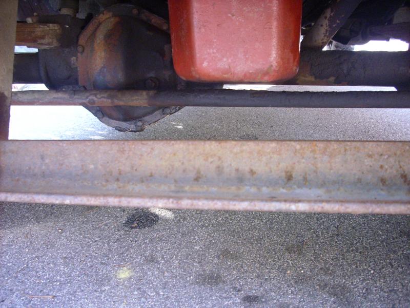

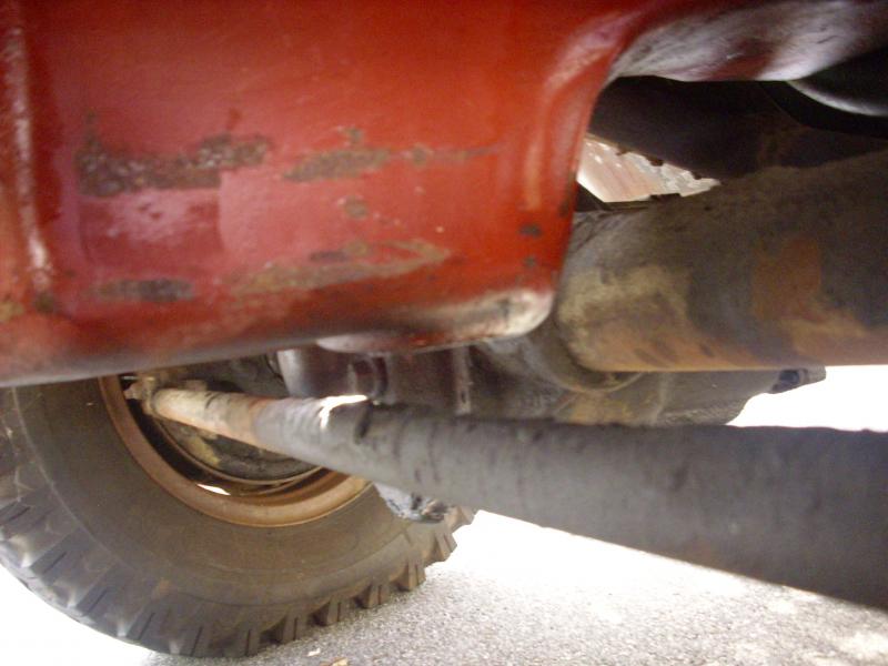

There is less than 1.5 inches of clearance between the oil drain plug and the axle's tie rod immediately below it. See pics. That's probably why the po seldom changed the oil after spending over $5k to have a shop rebuild and replace the engine.
