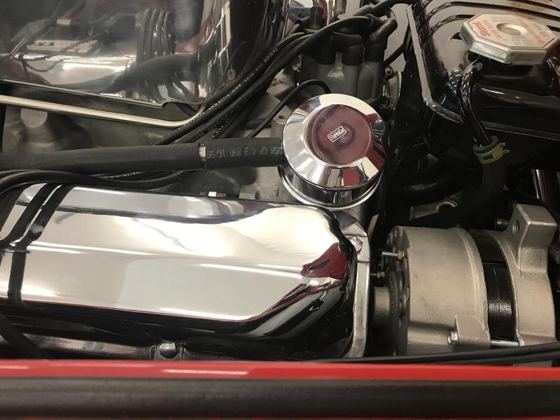

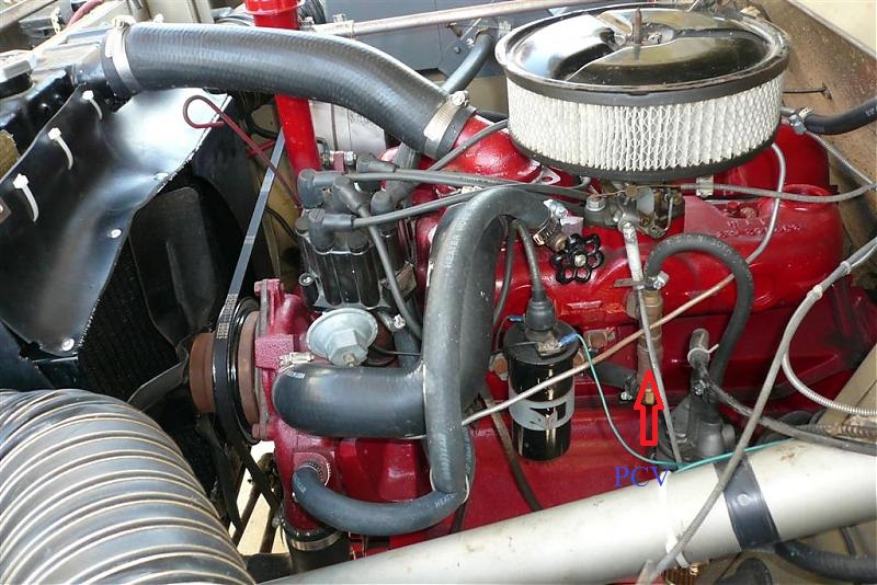

So I'd like to add a pcv valve to my 63, 152 to alleviate any oil smells . Has any one done it on their 152 .?
How is the oil filler sealed . I've got a cap that fits loosely and vents through a steel wool type filter

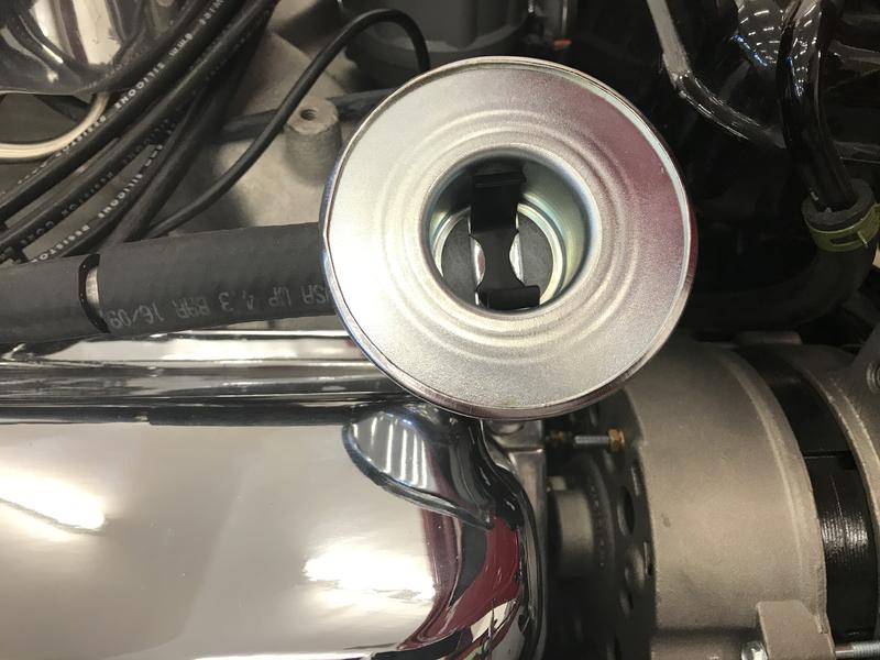

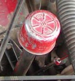

I assume you have the early filler tube where the cap looks like this one?
The filler tube has two J shaped slots at the top and a flange below the cap when installed.
The normal quarter turn cap won't be plug and play.
If you could verify what you have with photos it would be helpful in pointing you in the correct direction.
Measure the OD of the filler tube. From there you can decide what push in cap will work. Post the dimension and I can look.
