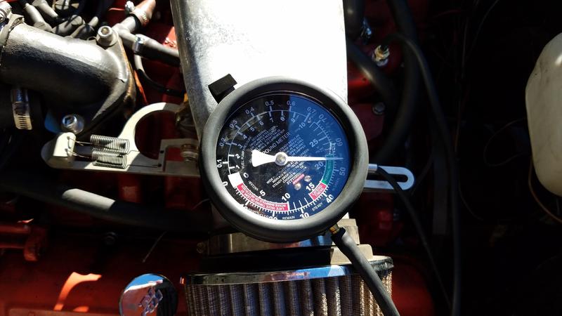

Vacuum test with engine at 195f checks out at 21hg idle and doesn't bounce.

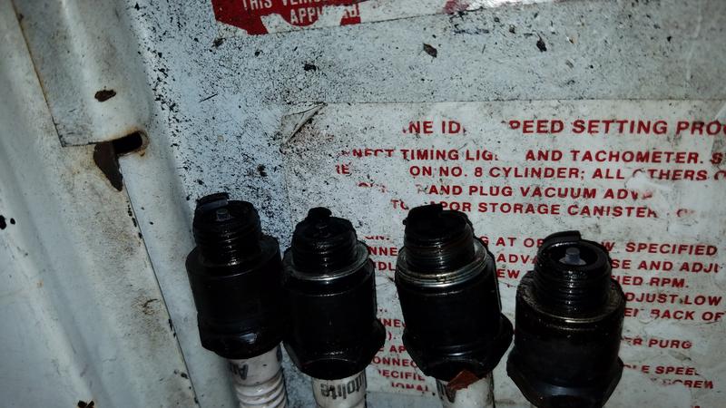

Sounds like lean on the primary jets. Plugs look black from to much fuel, but that could be from the rest of the fuel mapping. Is this a new problem or has it been that way since you got it running? Was this carb tuned to the engine?
It's been that way since I got it running.
The carb has been tuned only setting choke, the ims screws, and idle. No other changes. Carb isn't new, but purchased new six months ago, took it out of the box and bolted it on. Engine is power timed. For what it's worth, I'm just shy of sea level

Rough idle but make 21in/hg at idle? Damn good and still idle rough. Doubt you have a vacuum leak.
