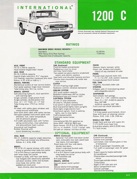

And an example of how "different" any particular rig produced by ihc could be, I've attached a copy (front and back) of a sales engineering brochure for one particular model light duty truck. This item details the "options" which could have been spec'd (and had to be!) by an ordering dealer. But then...virtually any part of the completed vehicle;le could be deleted during production also if spec'd that way by the dealer. Up here in the nw, it was fairly common for a dealer to order maybe ten units all the same, with a "drive axle delete" notation...in other words kinda like a "glider" inna pickup! That was because many of the timber contractors installed their own vocational axles and recycled those items from vehicle-to-vehicle over a period of many years.
Notice that for this particular vehicle model, there were seven variations in wheelbase alone available!!! Not hardly your typical "go to town pickup" commonly stocked at the local big 3 dealerships back in the day!
