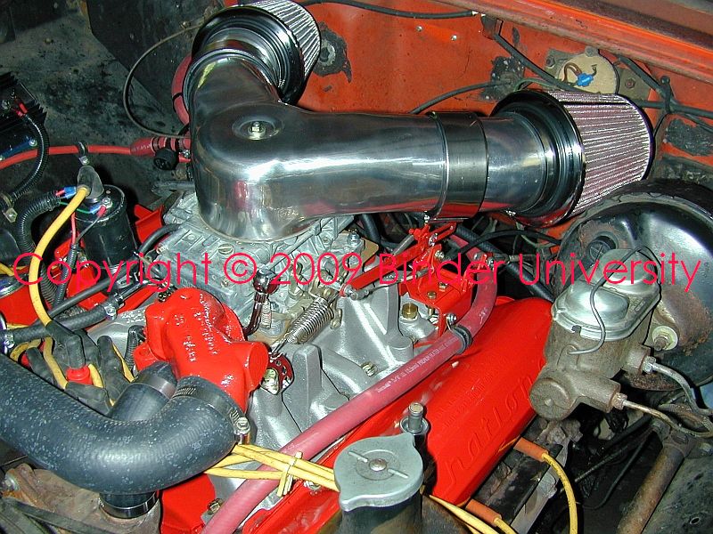

Pic attached is my personal ride, the throttle pressure control is totally original but cleaned and detailed.

This is different than the manual, as this method adjusts the rod in the wot position vs the closed position giving us even more incite on just what is going on between the carb and the tranny when it comes to the throttle pressure and the kick down adjustment. I can't see the 1/4" gap in picture, but I'm sure it's there.
