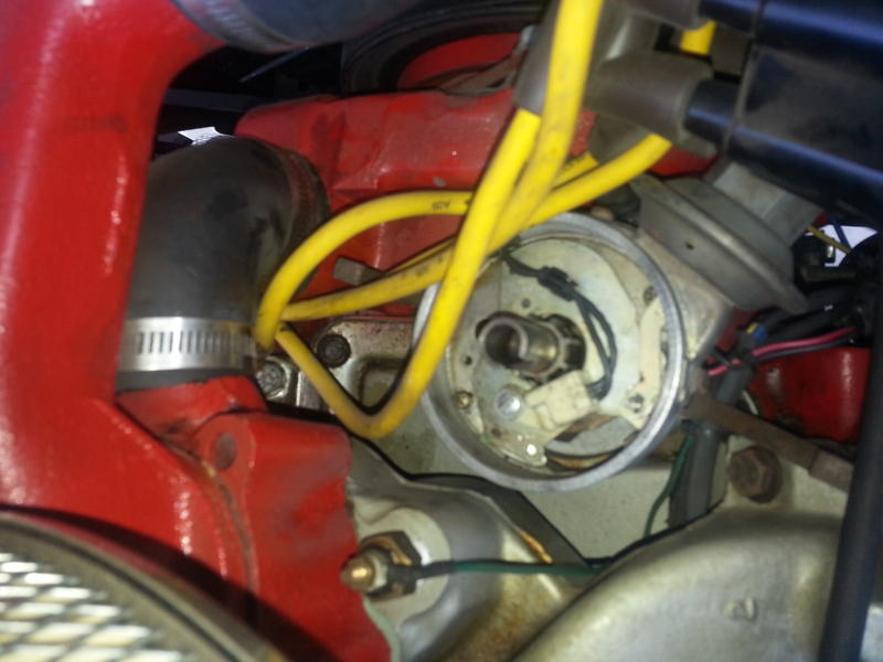

I think the electronic ignition has failed, there is 12 volts at coil, but no spark
I think the system is after market, but May some one can recognize is, as well as distributer type, I wat to purchase a new system but need some guidance
the ignition box is located in the passenger foot well
this is a newly purchased truck, and I know little history
any help would be appreciated pix included of box and distributor

That is the Holley "gold box" electronic ignition system.
It is the factory ignition for '75 - '76 - '77 vintage IH scouts.
There are numerous threads on this ignition system in this forum.
Check the "sticky" threads above for ignition upgrades.

Maintaining the stock ignition is certainly one option, I did the same for years myself.
The ignition coil & gold box are readily available at auto parts stores as are the cap & rotor.
The pick-up in the dizzy is difficult to locate.
Ask the guys at IHPA for it, maybe they have a source.
One thing to be aware of with these old electronic ignition systems, and the gold box in particular, do not leave the ignition key in the 'run' position unless the engine is running. Otherwise, the gold box heats up and an internal resistor burns out. Result, no ignition or very erratic ignition.
