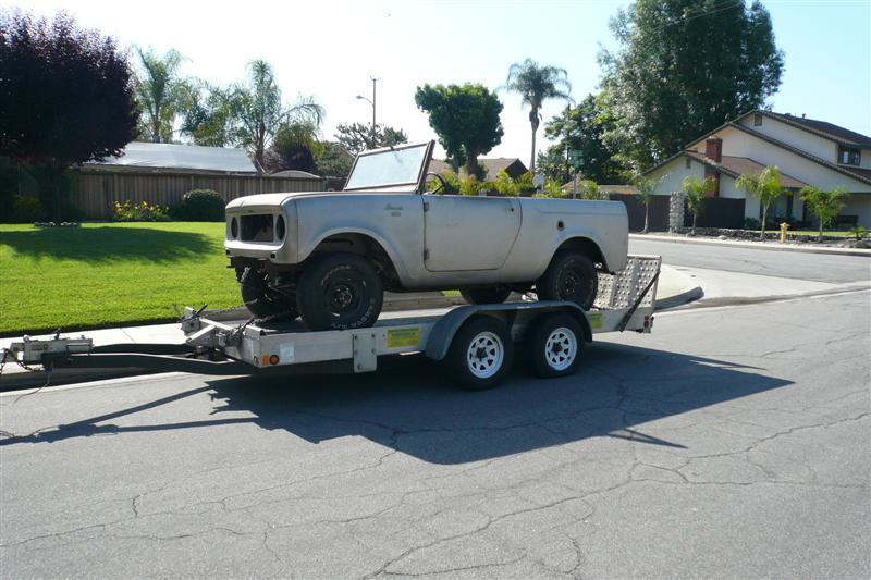

After looking at pictures of other scouts and reading how much lift people are using for certain sized tires, I'm wondering if I already have a short lift on here. I've got 30" tires, what do you think?

Ok, good. I want a little more, so I'm glad I won't be getting into a lot of lift.
I'm just a little surprised at how much lift people seem to be adding just to get 32" tires or so. Isn't that what you have on yours Robert, with almost 4" of lift?
I have 30's on there now, and it's not like the tires are jammed in. I'd think I could put 31's with no lift at all. 32's would only add 1" above the axle. Maybe it's the extra width in wheelwell that gets you...
I'm used to dealing with full size pickups, where 4" of lift will get you from 31's to 35's.
ok, good. I want a little more, so I'm glad I won't be getting into a lot of lift.

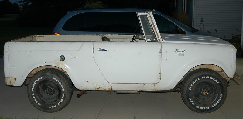

Two things to remember about tire sizing. Not all are as they read. I put 29.5" tires on this Scout (pep boys) when I got it and they measures like 28" in diameter not counting the squish at the pavement. The picture attached is with those tires and without the 3/4 added shackle lift(1 1/2 longer shackel).
My existing combo is 16 x 8 wheels and what amounts to 32.5 10.5 x 16 tires. They measure 32.5 dia.
Got to say that another inch lift would be nice. After I do my poor mans high steer I May look into that extra bit of lift.
If you go with 15" wheels a 32.5 x 10.5 tire is hard to find. And 12.5 is to wide for the stock fa.... Imo
