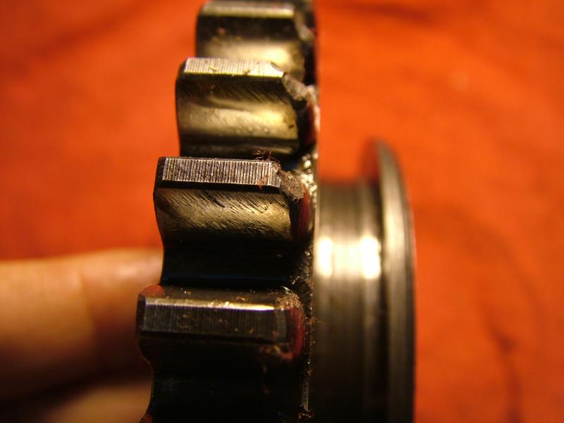

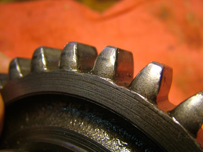

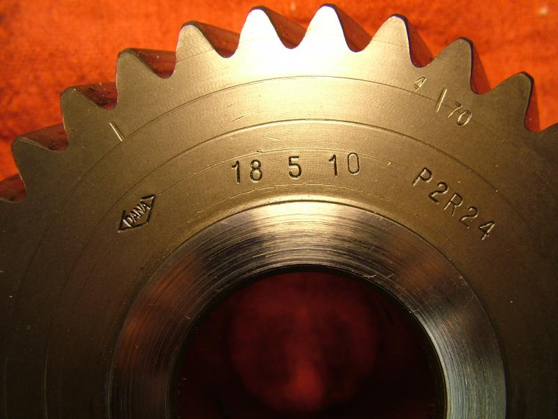

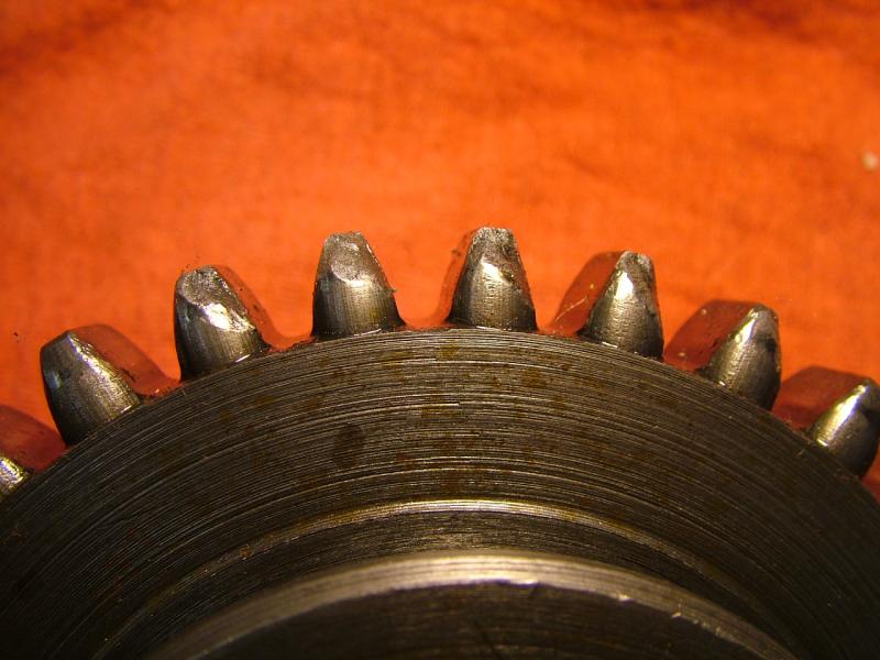

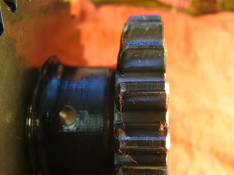

Jeff suggested I post some pictures of my transfer case gears to see if these need to be replaced prior to ordering a rebuild kit. This a single stick Dana 20 from a 1970 800a w/304 and 4 speed manual.
The rear sliding is the worst with about 4-5 teeth looking as in the pictures. The idler is next with all the teeth looking like those shown in the pictures. The front sliding is the best looking of the three.
The reason for the rebuild was the transfer case coming out of low range into neutral under a load. The shift forks, shift bars, and all bearings look good. Also the front bearing retainer (picture 11) has a broken lip. Should this be replaced?
Please let me know if you think these parts should be replaced.
Thank you.
Tom

Nice pics, that certainly helps describe the condition of what you have!
As to what to do about it...I'd have to say that depends upon your budget! And your tools. And your skill level as a dentist!
We're always going to replace all the bearings, seals and gaskets of course if we're gonna call this a "rebuild". And ya need to look closely at the bearing surface of the intermediate gear shaft as it's surface serves as the inner race for the roller bearings.
As for the gears...all the wear is see is on what I call the "dog" segment of the tooth. That leading angle is what takes all the abuse when the lever moves the sliders, every time ya hear the grind, you are now seeing the results! And all of these items must wear inna similar pattern over time unless the transfer case was never shifted!
Sure, if you have tons of cash (and we sure don't mind ya spending it with ihon!), you could replace every worn gear. But there is an alternative which is very attractive based upon what you consider your time is worth to play with this stuff. However, in some cases, some of those parts you will only find as "used" and May be no better than what you have now!
What I do is use my assortment of pneumatic handpieces/die grinders, and most often an inexpensive dremel flexible shaft handpiece with various grinding stones, carbide cutters, and high speed sanding attachments to return each leading edge of the worn teeth to the oem configuration. If you have no gears which have a nice, original profile for reference, just ask and I'll post some pics of what they should look like.
Reshaping these gear teeth is tedious, boring, and repetitive. It's also very inexpensive! If ya scruu up one or two teeth in the learning process, so what...that is not a deal breaker at all.
The "jumping out of engagement" is an extremely common issue with these transfer cases...and every time it jumps, then the dogs involved in the gear train in whatever position was engaged take all the abuse. Root cause of the "jumping" if you have verified that the shift forks are not bent/worn and all endplays and bearing preloads are correct, is the loss of tension of the detent springs. Those should always be replaced when overhauling a d18/d20.

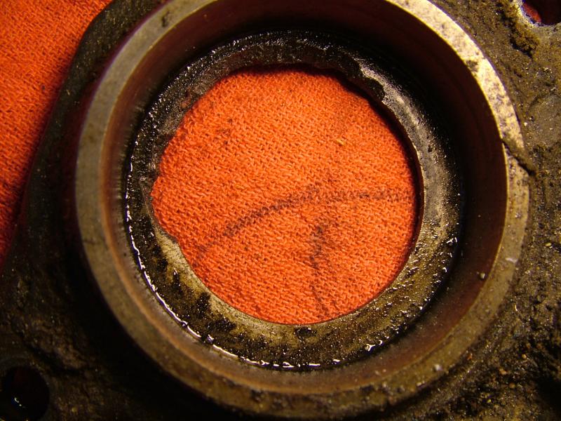

As for the damaged bearing retainer...I can't explain the damage. It's possible that the bearing failed in some previous life, or possibly the front yoke was loose on the shaft or a u-joint failed/broke allowing some "whipping" to occur?? We have a decent stock of good used parts for the d20, but at my location I do not have a front bearing retainer, maybe Jeff has a used one at hq!

I like the idea of reshaping, however how do you replace the lost material? I.e. A tooth that has a chunk missing. A picture of a good gear would be helpful.
The broken bearing retainer was from me removing the seal incorrectly. I will call Jeff tomorrow to order the rebuild kit, intermediate shaft, and bearing retainer.

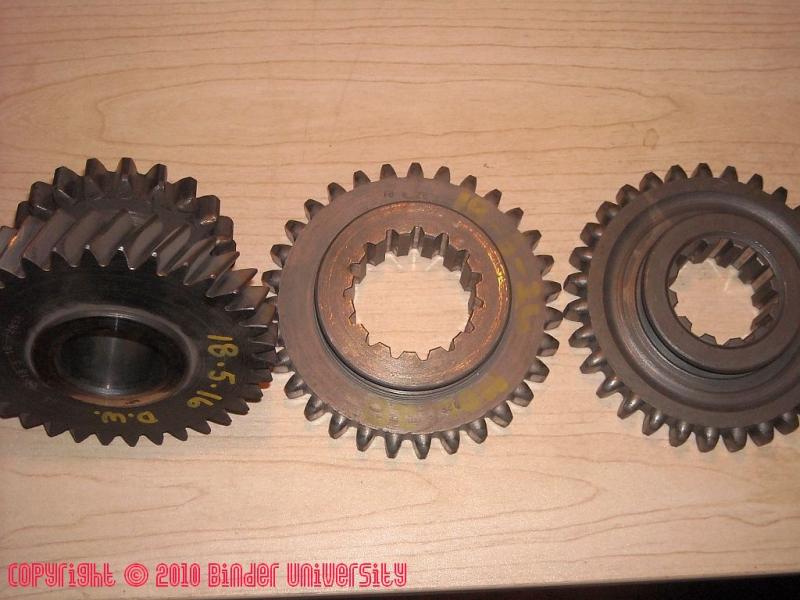

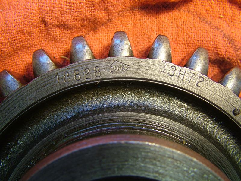

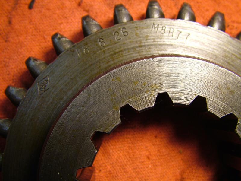

Hears a pic of all three gears you referenced in your pics.
From the left you see the 18-8-56 intermediate gear, the 18-8-26 rear sliding gear, and the 18-8-28 front slider.
All of the dog segments on the teeth show very little wear, in fact the sliders are near perfect and probably came from d20 that was rarely shifted.
Notice the "rounded" leading edge of the teeth, those are the points of discussion regarding the condition of the gears you have currently.
If the edges of a few teeth are missing, I don't feel that is a real issue, though it's not "perfect". You can use the dremel or whatever tool ya have to smooth out and clean up those teeth. Once the case is shifted and locked into any drive position, that entrance angle doesn't matter.
After rebuilding the unit using new detent springs correctly installed, it should not be popping out of engagement under load again, so by repairing that point, you will have solved your problem. No doubt the "jumping" has been going on for quite some time depending upon how often and how hard low range was being used. Make sure the shift rails that the detents work on are in good condition also!

Michael,
I understand on repairing the gears. I am going to repair the two better gears and replace the main sliding gear. You are correct the transfer case has been jumping out of gear for some time. My wife is getting tired of her foot on the gear lever, hence the rebuild. The shift rod looks very good, so the springs must be week. I ordered the parts today. I appreciate you helping me.
