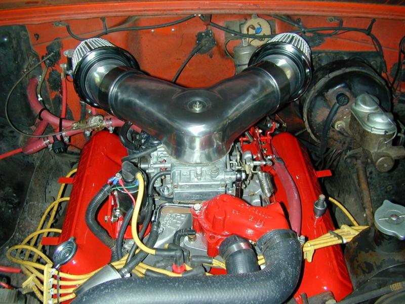

The dam water neck interference is exactly why these distributors are problematic to install. But again, ihon has sold many of these units over the years with no installation issues other than it's tedious. The early style water neck also involves the use of a particular top radiator hose that can be difficult to obtain. Pic attached.
My opinion, this particular distributor was assembled incorrectly if it was done "just like we do for ihon".
