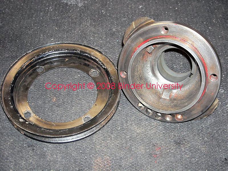

The flying magnet wheel is a universal-fit item that will have to be machined to fit the oem I-4 crank hub shown in this pic. The wheel will mount between the pulley and the machined boss on the hub. A second pulley will be added to the stack in order to allow any future drive position, say for a ps pump.
Once the crank hub assembly is done up, then it will be combined with all the other engine components involved in a dynamic balancing operation for the hybrid stroker motor.
A very similar hub is used on some sv applications as well, including 266 and 304 motors.

Mm,
if you need some machine work on the pick-up wheel you can send it down and I'll take care of it for you. I'll bore the diameter and put the hole pattern in it.

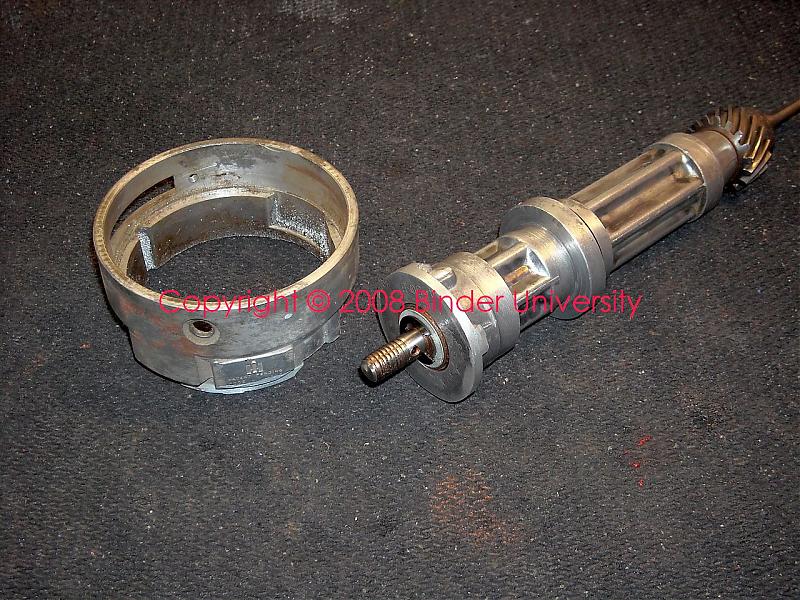

So if the distributor is eliminated, how do ya drive the oil pump onna I-4/sv motor???
Here's my homebrew solution, it's not finished but can be used as is for getting the bugs out.
The top of the modified body will be turned down in a lathe and a "cap" made to be pushed over the top and sealed with an "o" ring. There is a plugged access hole in the side of the distributor that will be drilled through to the top bushing and a grease zerk installed.
This distributor started life as a Holley gold box unit that had major internal rot. The body and the shaft were usable, none of the rest of the pieces are salvageable. I will not waste a rebuildable distributor for making an oil pump drive, only trashed units will become donors.

mm,
Ya read my mind well in advance!
The hub will also needa speedee sleeve done, I'll handle that here. And I'll send down an extra hub for yourself if needed.
The one in the pic is an oem unit for a 152. The hub is still on my operational 196 so I don't wanna pull it for comparison of "mass" yet. But I do have a couplea more 152 hubs we can use.
The 152 and 196 use the same hub #863-718-r1 and I have one to use for measurement purposes. I suppose the wheel needs to be clocked to referance tdc #1. I'll need the info you have in that regard. I'll be running a magneto so I won't need a hub change.
Just send the pick-up wheel.

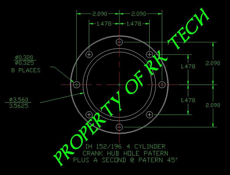

Michael,
I was bored so I and measured up a 4 cylinder hub. I banged out a drawing just in case someone wants to machine the hub pattern in something like a crank trigger wheel? :dita: you would need a mill preferably with dro's. Start by indicating the center hole and set the x and y at 0.0000.
I added a second set of holes indexed 45 degrees so a better choice of pickup locations is available. I think this would make the setup easier.
For reference the dimensions are as measured and accurate to my hub to +/-.002. Usually IH designed to fractions and the measurements are a few thousands off the fractions. Probably normal manufacturing tolerances.

Shit man...ya already done the math!!!!
Soon as the ss check comes, I need to order in a blank wheel! Stand by!
Have ya got any words of wisdom about where to actually locate the mag trigger unit? I'm gonna use the "adjustable" version of course and want everything to fit onna stocker since there is plenty space down there. I've still got a mule 152 onna stand and can do that mount-up any time. Hell...I might go ahead and try this out on the 196 in the pos rig now to see what happens??

shit man...ya already done the math!!!!
I was bored and I had 3 fingers of single malt scotch in front of me. No telling what one can git done under those conditions. :gringrin:
I would fully mock the motor with all accessories before trying to decide on a trigger location. I added the extra hole pattern so you would have more options. I like the lower quadrant personally. Nothing but air down there, also you have the pan rails to use as a foundation to mount the bracket.
I think debugging on a known good running rig first is a good idea. You can make all of the necessary mountings and brackets, debug the installation and timing. Then simply bolt it on the new deal.
When you first fire the new motor you want it to run right and immediately to break in the cam. You can't fart around with it it's gota run now. But you know that.:smilewinkgrin:
