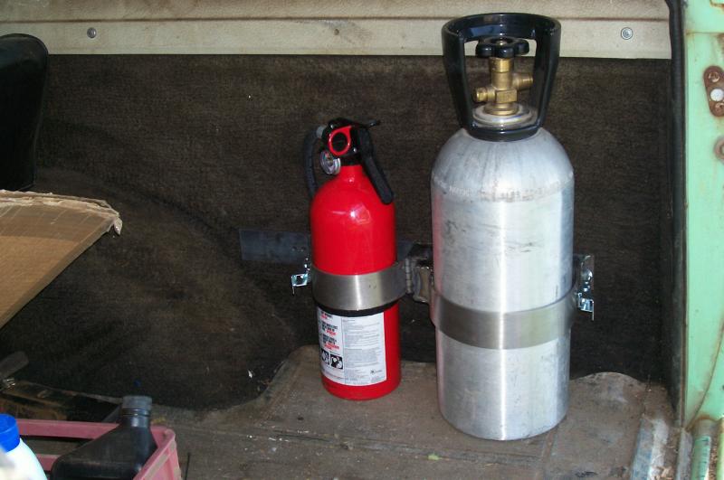

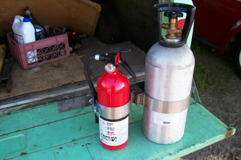

I wanted to make a bracket for my co2 tank and fire ext. So they're not bouncing around in the back. I bent two straps out of 2" wide stainless steel. I used some 2" weld on hinges and a couple of draw latches. The latches are like the ones on a fire ext. Mount. They pull tight and then lock.
Here's a link to the latches:
amazon.com: 1.06 w x 2.66 l, southco adjustable draw latches, w/keeper, zinc plated steel (1 each): industrial & scientific
I put some 4" wide 1/8" plate on the back side to keep the bolts from pulling through. It seems pretty strong.
