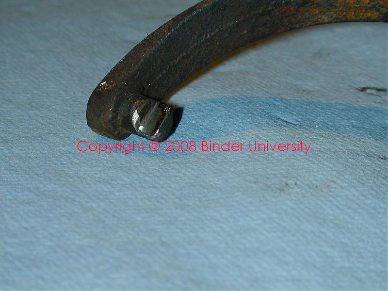

Here's a pic of one tip (there are two) of a badly damaged fork, yours will look like this one (or worse). The throw out bearing collar will likewise have two divots worn in the slot that match the worn fork tips. Between the two worn parts, all your clutch slave travel is now gone.
If...ya extend the push rod, you will most likely get a few more miles...but then the clutch fingers and cover are going to eat completely though your throwout fork and it will break into pieces, possible get caught in the flywheel and trash everything inside the bell housing. Extending the push rod is just a juryrig that will fail!

If you juryrig a longer push rod, the throw out fork will be consumed by the clutch cover. Then ya got nothing but a pile of scrap and no core parts.
It'll start off making an intermittent scraping sound in the bell housing like the throwout bearing is going bad. Then the whirring sound will get louder and more constant. Then it'll grenade. At that point you May be looking at a used bell housing, having the flywheel surfaced and a replacement ring gear installed, a new clutch set, a used replacement dust cover (if ya can find one) and a reconditioned clutch throwout set.
