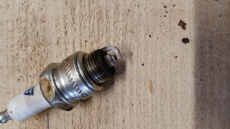

Been some months now and engine starting to miss and also not run well on rainy days even in the morning after being in a car port.
Checked the timing and then pulled a plug and it was showing overheating. I decided that it was a cheap fix to replace all the plugs and put in a basic set because I'd like to figure out what is going on and then get a better set.
BTW, while timing in the new set I was getting shocks from the wires, so running badly in dampness may be solved.

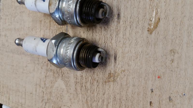

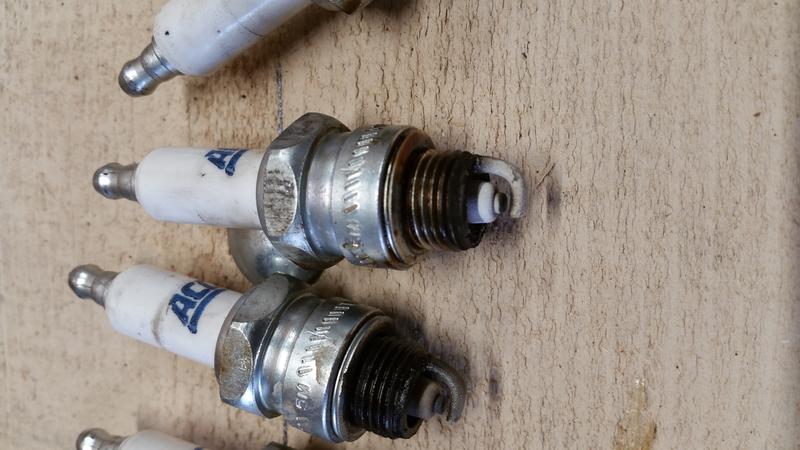

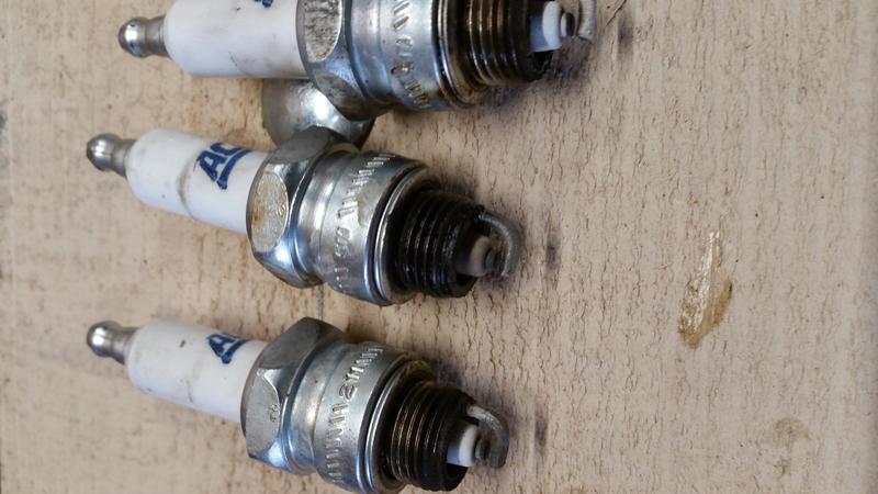

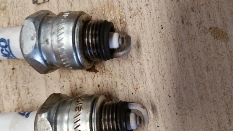

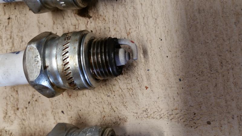

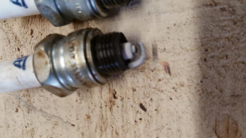

Once I got all of the old plugs out I became very concerned as you can see in the pictures. The worst plugs are nearest the carb.
Web searches say that I may have the timing too advanced and am getting pre detonation but engine has been running superbly.
With the new plugs it is running quite nicely but I don't think as well as when Paul first set me up.
I would welcome any insights or suggestions. I am thinking to contact NGK and discuss colder plugs.
The pictures start with the odd plugs and then the even plugs

I guess I'm not seeing the plug overheating. I see that most of them have a tannish-brown appearance, which is good. I see that one or two appear to be fuel or oil fouled.
Nothing about those plugs say detonation to me. Many are white but this is also a smog calibrated engine and this look is to be expected. What I do see is oil burning, and in the 3rd to last photo of the plugs it is obvious. Totally carbon loaded and no longer firing. Oil in the threads on most and carbon build up even on a couple of the whiter ones..
Other than those observations, things look OK. How many miles on these plugs?
What kind of driving do you do? Just guessing you are loosing oil past the intake valve guides as the engine is basically new. If you have not already, I suggest umbrella seals on at least the intakes. At least a couple of times a week, take a freeway trip for 10 minutes at speed (65+). That should mitigate a lot of the worst carbon buildup.
I drive about 150 miles a week. Once a week we go to the beach so that is 30 miles each way but not too high speed coming home... The other 90 per week are surface streets as I prefer them to freeways, small town boy.
The plugs have about 3500 miles on them. Engine rebuilt 2012 but didn't put many miles on it in Korea, mostly off roading on weekends. Engine maybe 10-15000 miles?
I never have had plugs so white before but I agree they aren't all THAT bad. I am wondering about the flamethrower III coil making the plugs hotter
I don't notice any smoke as a rule. I did see some the other day when it was raining and engine was really balky in the morning while not yet warm.
I verified the operation of the choke and choked it slightly more and replaced the air filter.
There is no smog equipment but I do have aftermarket catalytic converters in anticipation of Hamilton Fuel Injection
The engine is missing more often. I changed the plugs after only 500miles or so and the same ones are pretty fouled. I am going to go ahead with the umbrella seals. If I am going to do this I think that I might as well do all the valves.
Please post opinions and maybe even point me to other posts, especially with pictures, regarding installing umbrella seals.

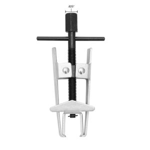

Super easy to install, do them one cylinder at a time, bring them to TDC stroke, pressurize the cylinder. Remove the rocker assembly, remove the spring retainer and spring. Slide the new seal on to the stem cup down, slide them to the guide.
Reinstall the spring and retainer along with the locking keys, release the spring tension and move on to the next one. I like to give the valve stem a rap with a rubber mallet just hard enough to unseat the valve and snap shut.

Ha, Robert Scores. I forgot about pressurizing the cylinder to kee the valve from falling into the cylinder
