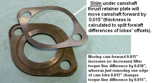

1. I can shim the camshaft forward (let’s say .020”) with a matching shim under the cam retainer plate. Some lobes on the left bank are already forward of the lifters a little, some are not. Moving the cam .020” gives me a difference of .040” front-to-back for any left side lifters that were initially centered, and still leaves me with well off-centered lifters on the right bank, even though less so. I’m trying to split the difference without other collateral problems (see below).

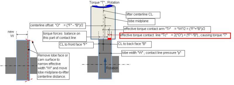

picture 01.. I decided to do what I could to modify the cam to get all lobes offset as needed. My diagram in picture 01... Shows my intent.
The “torque contact line” “tc” in my diagram has a torque arm radius measured to the lifter center. (recall your physics: contact force times friction coefficient equals sliding force.) the math all works out to use "tc", or the offset “o”, as a target value to look at for the ‘fix’. As the cam lobe gets narrower, the torque arm for a specific length “torque contact line” gets smaller. However the torque does not get smaller because the contact pressure per inch of total contact line across the lobe will get larger (same force, shorter line). Anyway…

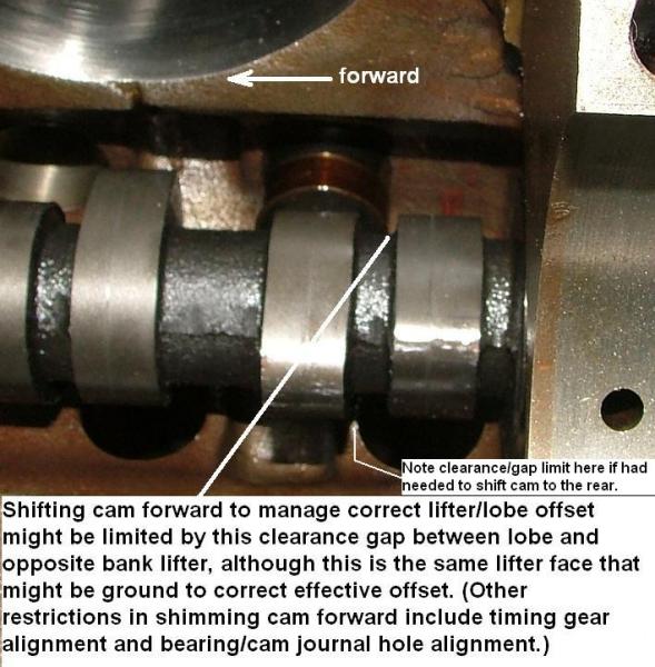

picture 03.. This photo shows there is a limit to moving the cam due to lobe-to-opposite bank lifter clearance. Note: the center distance between a right bank lifter and left bank lifter is 0.80”. A lifter is 0.995” diameter, so it should be obvious that in the photo the lobe on the left can only be offset forward, and the lobe on the right can only be offset aft. Particularly if the lobes were as wide as .600” (assuming the nubs on the lobe sides from the forging parting line are ground off). Other limits to camshaft being shifted forward are oil hole alignment between bearings and cam journals, and timing gear meshing.

picture 04.. I decided to shoot for a “torque contact line” as shown in red in my diagram in picture 01.. Of .095”, which is an offset of .048” for every lobe. By calculation in “splitting the difference” I came up with moving the camshaft 0.015” forward, note that moving it 0.015” increases the “torque contact line” length by .030” on the left bank’s lobes and increases offsets, but decreases offset on the right bank’s lobes by the same amount. See my 0.015” shim in picture 04.. That goes under the camshaft thrust retainer plate.

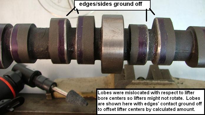

Picture 05.. I calculated the amount that would have to be removed from the side edge of each lobe to get my 0.095” “torque line” after the camshaft would be shimmed forward. This means some more lobes for the right bank would be ground than if I had not shimmed the cam forward, but it means less would be ground off the lobes for the left bank. The calculation was done for each part of each lobe (base, lift ramp, nose, close ramp). (some of the lobes were cast “wobbly”.)
picture 06.. Here are the lobes with the edges ground away from contacting the lifter. I used an angle air grinder (shown) and a dremel tool to finish the edge smooth. Of course, if the lobes wear considerably, they negate the work. But if I get a successful break-in, I’m not going to worry about the next 150k miles.

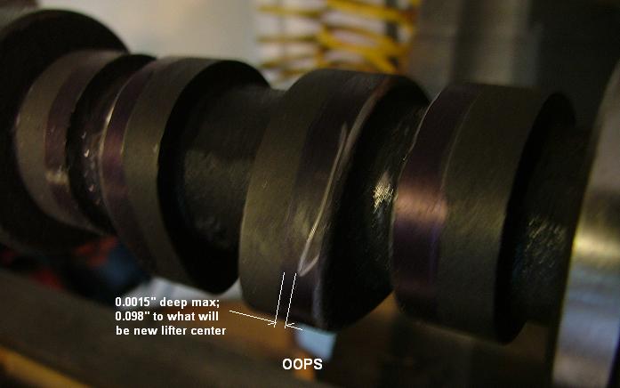

picture 07.. Oops! (bumped my wrist finishing the very last lobe with the dremel.) and worse, its on the lifting ramp. While I am a bit of a perfectionist, I’m not sure I really want or need to do another cam. The .0015” depth was measured using my .0005” grad dial indicator moving the lathe carriage. Not enough for sliding friction oil support (no hydrodyamics here), but I think I’m going to try to live with it.
What do you think? Do another camshaft? (not)

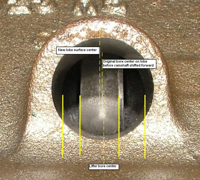

picture 08.. Lobe number 7 for the exhaust on cylinder #3 on the left bank had been the worst (less than .010” offset initially). Now it’s .046” offset (.092” “torque contact line” length in red in picture 01 diagram).
