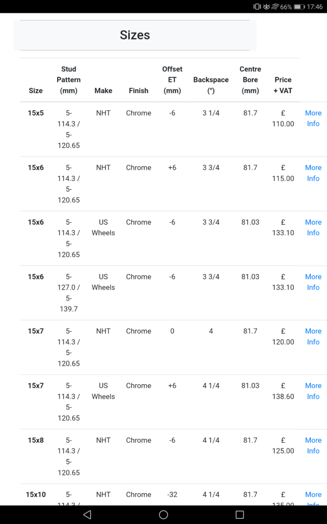

I've measured the original 15inch steelies and the back space is 3 1/2 inches so if I go to 4inch back space does anyone know if this is sufficient or do I need wider? Any help would be much appreciated. I've attached some information about the wheels to assist you with the crap I'm babbling on about😅

Personally, if you're going to replace the rims (and I presume tyres) I'd go with 16 x 7 rims and a 265/70-16 tire. That's what I have on my '71 Travelette and they fit the wheel wells real nice and are just a bit wider than stock. You'll also be assured of more than adequate clearance on the calipers.
I helped a guy trying to fit some drum rims to a disk vehicle and IIRC the back spacing was not necessarily the issue, it was the shape of the rim. So, if you're going to go with the same size rims, I'd keep the back spacing the same.
Agree with Chappie. Should look for similar to stock backspace and avoid wheel spacers. I can't recall if your wheel lug pattern dimensions have been conclusively established. I don't seem them within this thread, anyway. For example though, if they happen to be a 5 by 5.5 inch spacing, there were a multitude of other vehicles with that same pattern that had front disk brakes from the mid-70's up into the late 80's/early 90's. Fullsize Ford Bronco/F-150 being the most common. I know in terms of Scout II vehicles, wheels from those Ford donors among others will clear the stock disk brake calipers with ease. But alas, your 1110 is clearly not a Scout and you're going with an aftermarket conversion kit, so I dunno there.

I called IH Parts and spoke to Michael he seems to think that I need a back space of 3 3/4inches on a 15 inch rim, I have measured my 15inch rims and only have 3 1/2 so thinking of going to a 4inch back space still sticking with 15inch rims, I'm now thinking of going to wait till the conversion comes, fit it and decide after rather than guessing and spending a hole load of wonga on the wrong rims and rubber. Oh yes they are 5x5.5 and the disc conversion should be in with them by the end of the month before shipping to me in UK, so just playing a waiting game now before I have to rob a bank😂

3.75" back spacing sounds about right to me, too. 4" wouldn't be that big of a jump from there. Sounds like a good plan.
