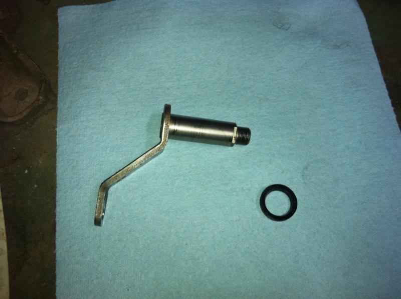

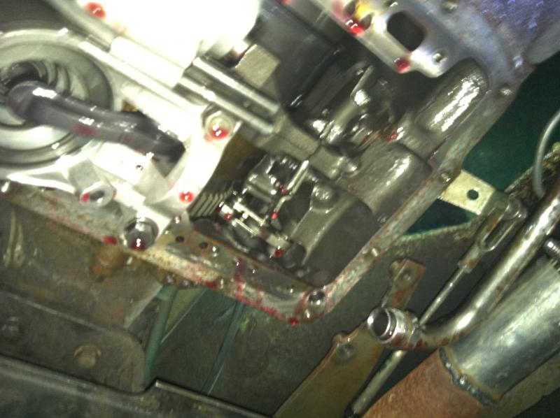

Got it tore apart, after removing the pan I decided to remove the valve body, there just isn't enough room to get at the internal linkage if you don't. I believe I also found a seal for it, its for a Ford fmx trans. And the part # is a napa atp 1404

The fmx is a derivative trans based upon the cast iron borg warner. Good to know that part is an interchange!
