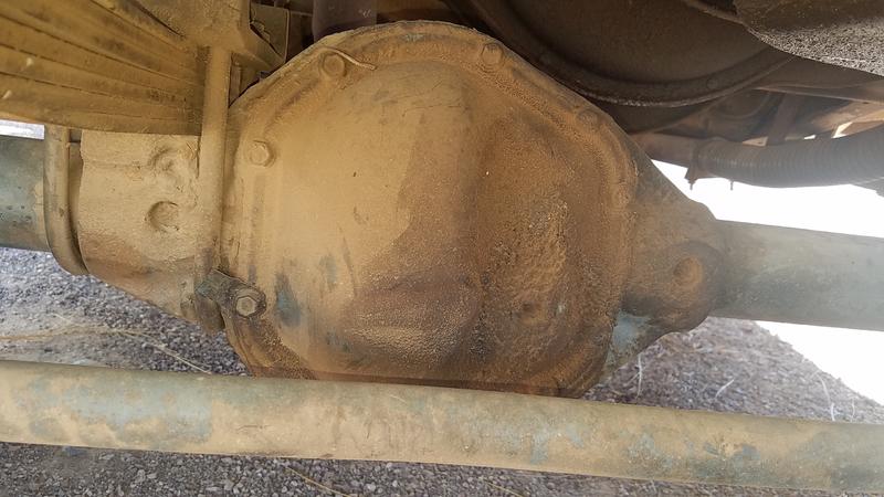

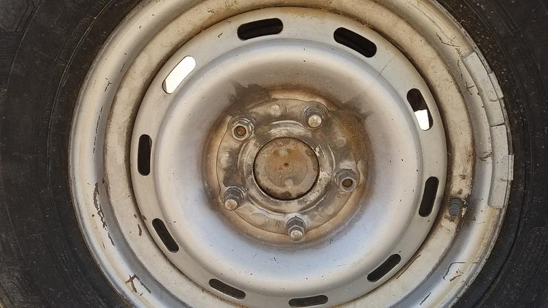

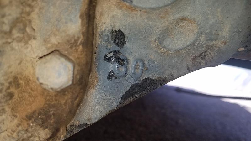

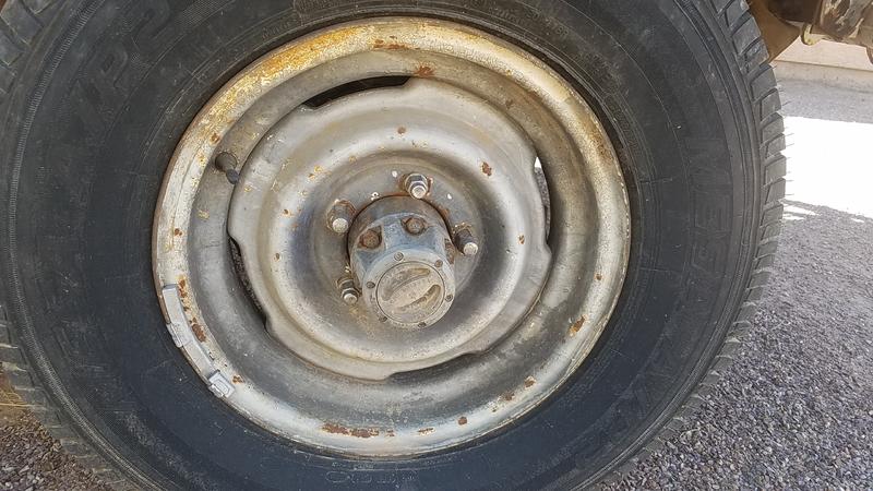

here are the pics that i promised, the rear diff does say 60 sorry it dont show very well but i did clean off a ton of grim to get it too look this good

I stand corrected. Scott nailed it. You're still not going to be converting it to 8 lug. You'd be better off swapping out the whole housings for 8 lug axles.
what is the front axle out of? a 73 1110 4x4 would have had a drum brake small ball 44 in front? or have you converted the small ball to disc brake?
on the rear the only way you will get 8x6.5 is change the axle assembly to an IH ff 60 or one from ford or dodge of similar vintage, just look at the wms to wms measurements and find out what is closest, seems chevy 14 bolt ff from 70's-80's is usually pretty close and the matching front axle is pretty much a drop in as well, a 3/4 ton will usually have 44 in front while a 1 ton will usually have a 6o in front, a 1 ton as long as it is a single wheel or cab and chassis the rear will still work.
